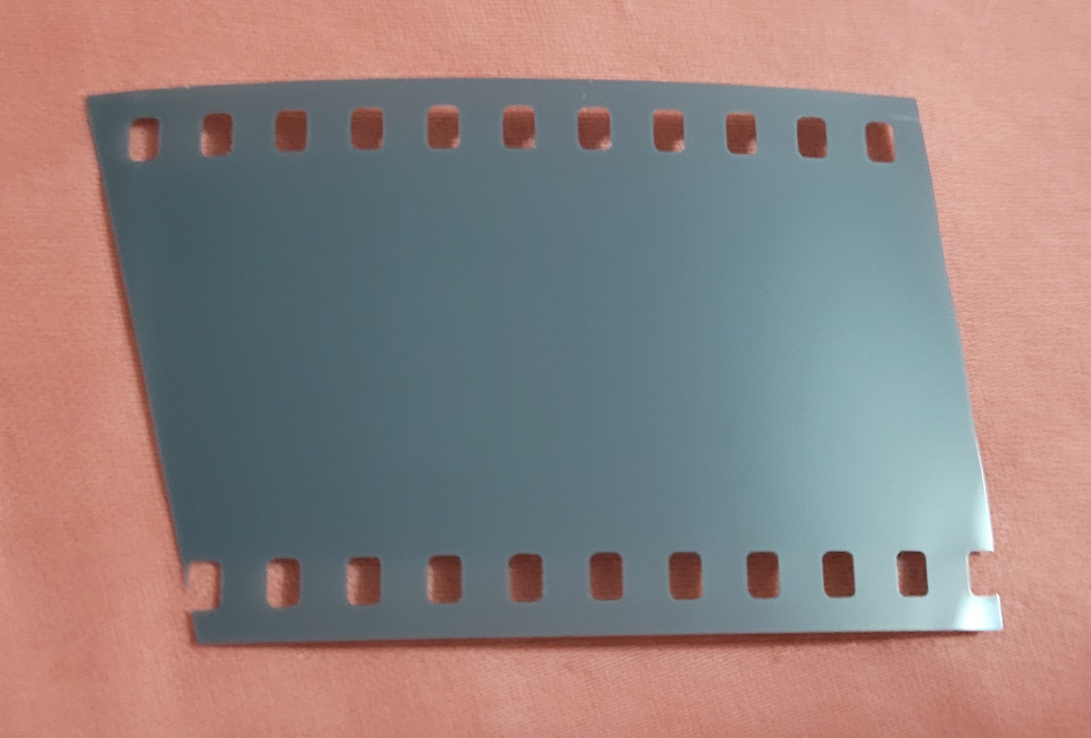

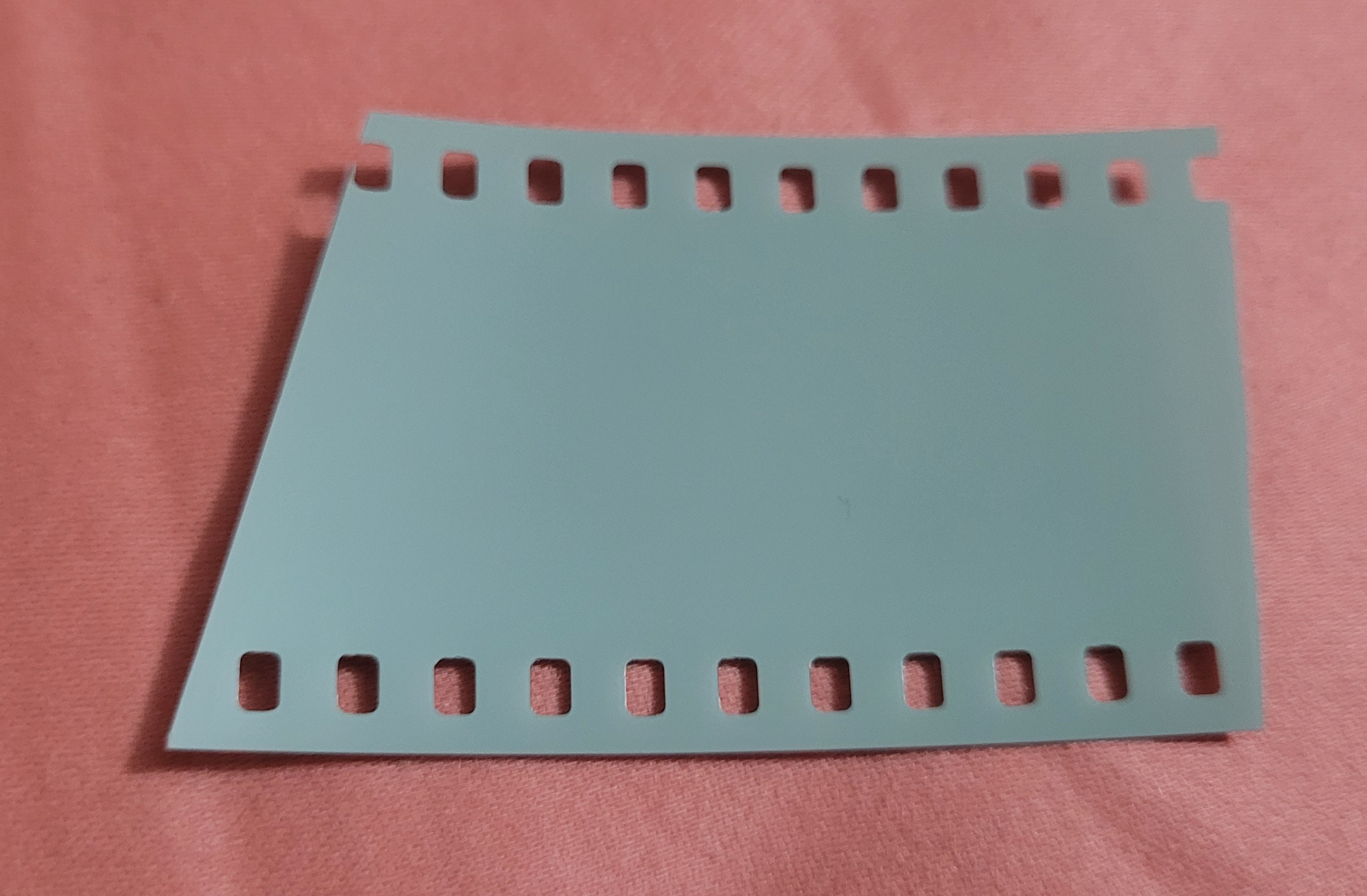

Here is what the actual film looks like. Not many clues, except it doesn't have the motion picture perforations.

The photo of the can says it's rerolled from longer strips, so it might be something normally sold in 100 foot lengths being rerolled to 50 and 25. I agree, those don't look like cine perfs, but it's possible someone bought unperfed strips (say, from ORWO) and had a perforating machine that cut for 35 mm still. As far as the film itself, that could be almost any B&W stock -- Fomapan, Adox, Svema (though Svema wouldn't be "made in EU"), old old Agfa from stock found in a warehouse freezer, etc.

And yes, thus far it could be anything. I'll only know more when I shoot and process some. And then the biggest clue will be if there are any edge markings.
For whatever it's worth (not implying that this is Fomapan, though it's certainly possible), Fomapan 100 and 400, at least, sold for rebranding (at least under .EDU Ultra) has NO edge markings at all. Good luck figuring out what you did wrong if you get blank film, or whether it was 100 or 400 stock anyway.

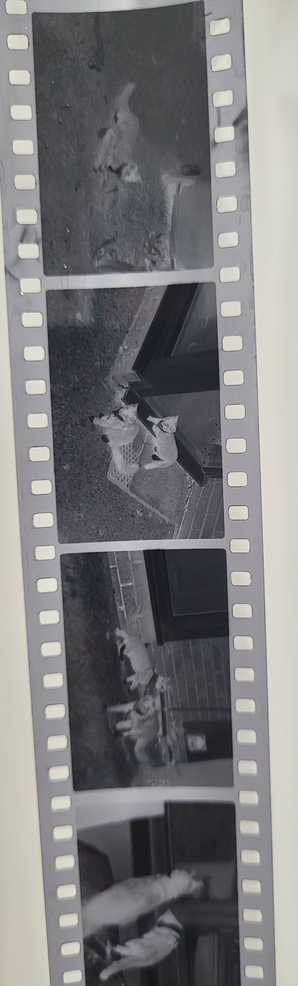

Loaded 8 exposures into a cassette and took some pics of my kittens. I developed at 20C in Ilford Microphen, usual inversion method for 8 minutes. Negs look nice if a little dense. Fomapan 400 needs 8:30 and I doubt it would look this dense with less development time but there's nothing in the way of edge markings, nothing in the rebate area at all. So Fomapan remains one possibility.
I am assuming that repurposed Kodak XX would have some edge markings. ALso the app I use on my phone suggests 9:15 in Microphen for Kodak Double X (either version) at 400ASA. What about repurposed Agfa film? Might it have no edge markings?
What I can report is that I was able to put a core/spindle in and load the film into a bulk loader without any issues. The film went through the camera and through the development process trouble free. Not that I was expecting any trouble, but it's good to know that I can actually use what I've bought.

I'll scan the negs shortly and see if that produces any more clues. I've shot Fomapan 400 and the negs are not usually this dense, especially as I'd usually add another 30 seconds for Fomapan 400. But who knows, there are always imponderables. Not sure I've got anything happening soon that would suit 400ASA film.
It still could be almost anything as far as I'm concerned. But at least it works. What I can say is that I've never had anything known to be manufactured by Harman that had no edge markings. Nor Kodak.
If either entity manufactured the film, but it was finished/confectioned by someone else, the edge marking would come from that latter party.
