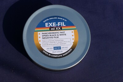

I've seen this popping up on eBay - Exeter Pan XX B&W film
The description says "very high quality (probably the best)". It also says it's made in the EU and can be rated at 250, 400 or 640 ISO. Made in EU makes me think it's Fomapan 400? But maybe it's something the remnants of Agfa are manufacturing as the description also mentions it's spooled from left overs from long rolls. The seller offers various lengths, 25 feet, 50, 100 and longer. Does anyone know what this is?

If you zoom in on the canister labels they mention that it's respooled from longer rolls, and make reference to "Exeter, England" which may be the town where the respooling is done? It's offered by Eaton Helen Cameras on eBay who are based near Exeter.

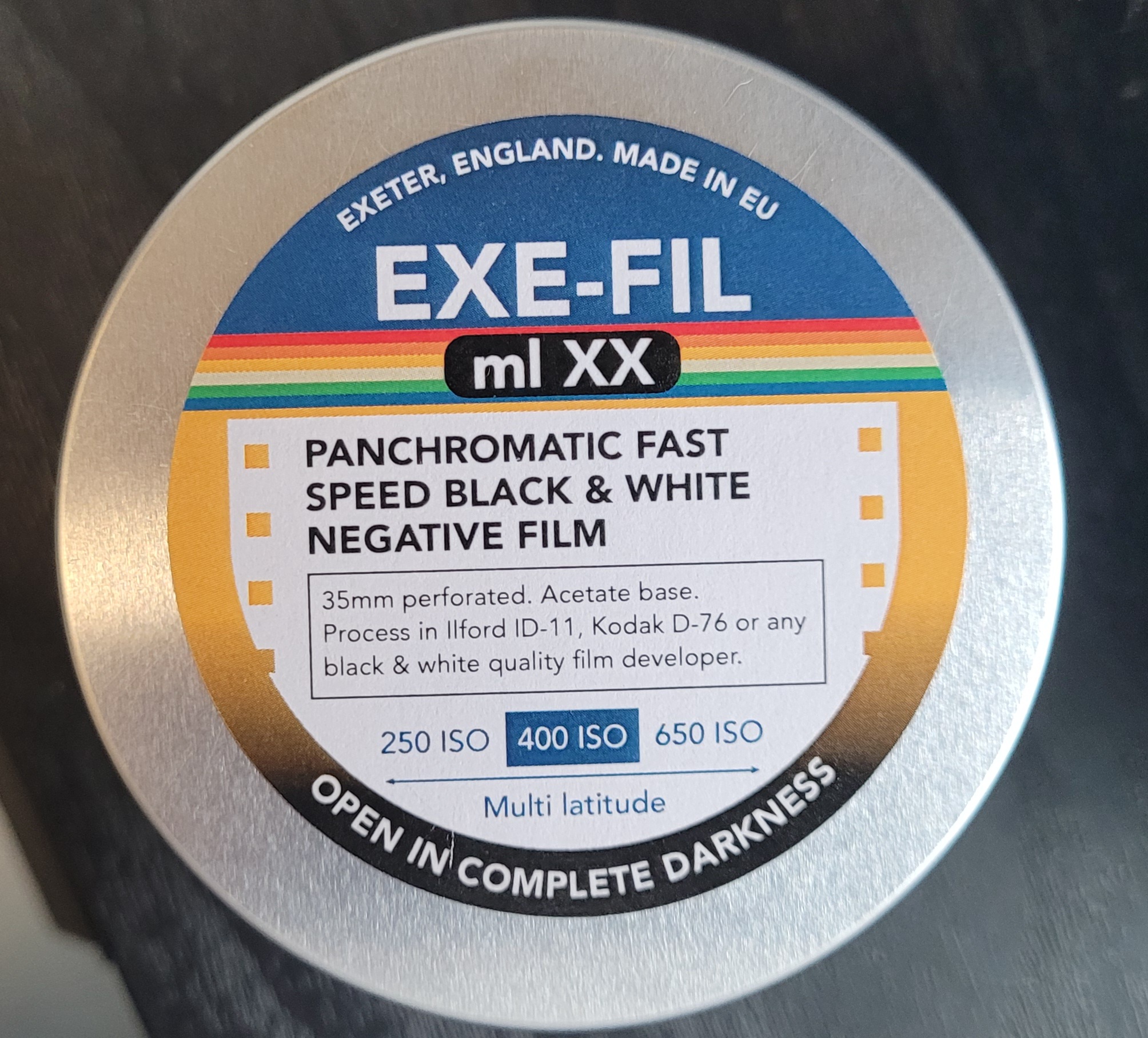

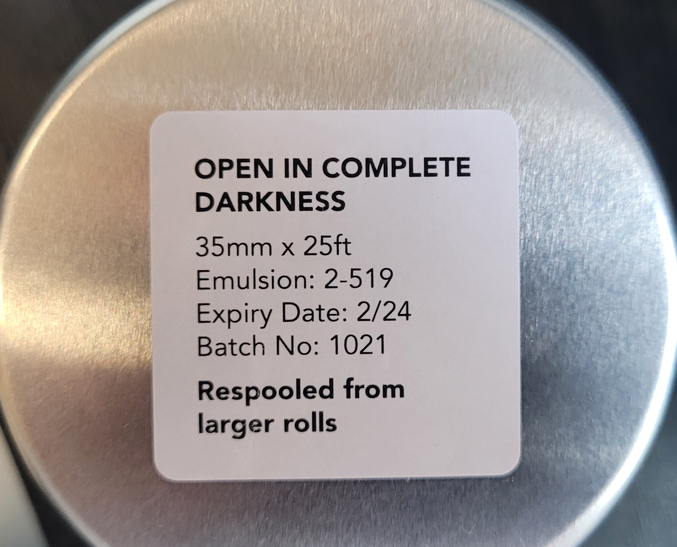

Well, it's arrived. I'll try and snip a bit off in the changing bag this evening and maybe load a few frames into a cassette to test. Not sure I am up to much this coming weekend but I may get out and about and test it.
Here are photos of the can. I'll try putting it into a bulk loader this evening if I get the time.
