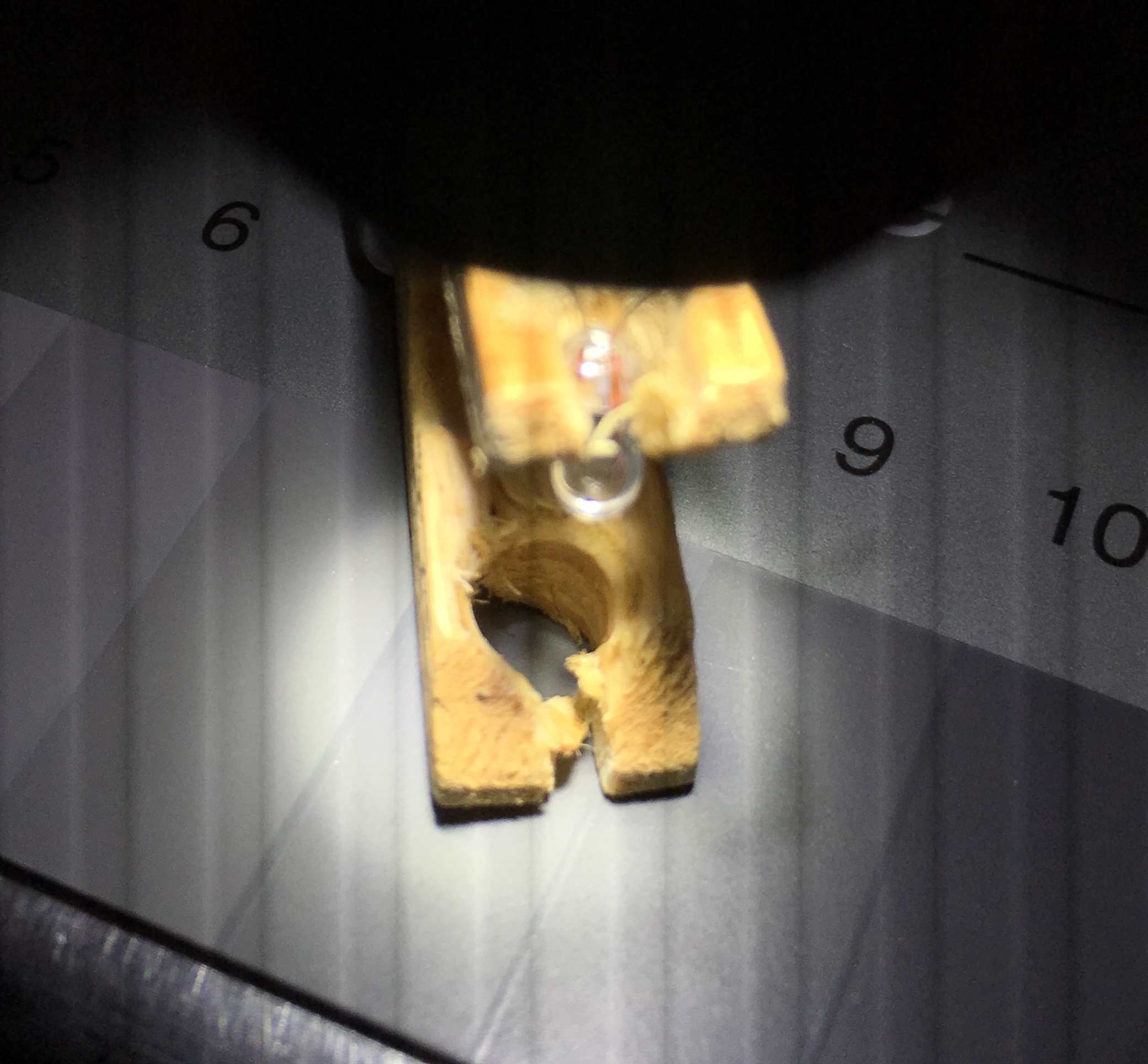

Hi Dave,
Auto-scan reflected light densitometers exist, and they can be frustrating. For example, the rubber drive rollers that feed the test strip into the reader can harden over time and lead to skewed feeding, which makes the readings fail. Don't ask me how I know haaaaa.
Instead, keep it a simple. Make a probe about the size and action of a wooden clothespin. The jaw opens and has a small target circle at the bottom that helps show the area you are reading while the top includes light source and sensor. When you press it down, take a reading and display density/store reading.
The user would print a step wedge, and read them in step by step.
