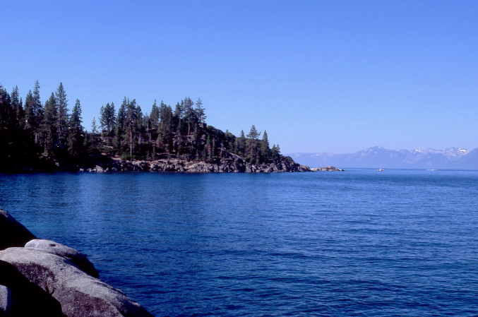

Another example of the intense blues of this film. I like that it's a neutral blue (I warmed this up a little after the way the scan turned out, the slide is even more intense blue). Reminds me of my cobalt blue oil color.

You'll need to get it calibrated then. I got my E100 calibration chart here http://www.targets.coloraid.de/
I'm just gonna mention this again because I keep seeing threads about E100. You need a calibration chart for E100 so the scanned slides will look true to its color. This has solved a lot of problems for me because it gives consistent results without needing to adjust a lot of parameters like you would do if you are scanning color negatives.

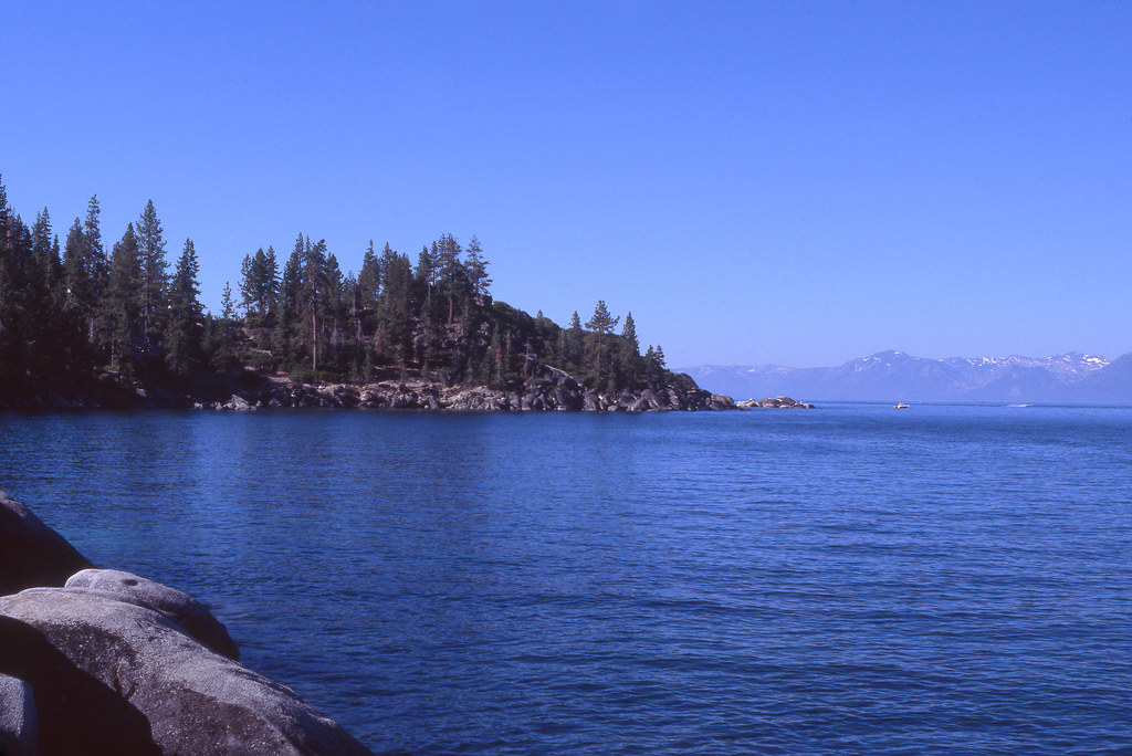

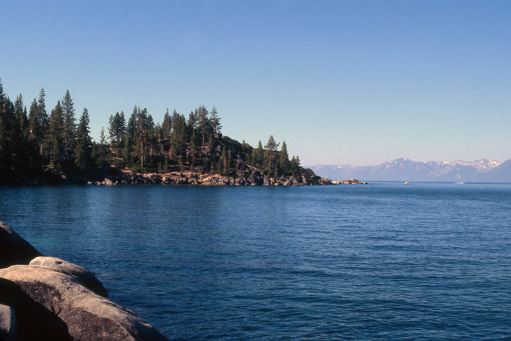

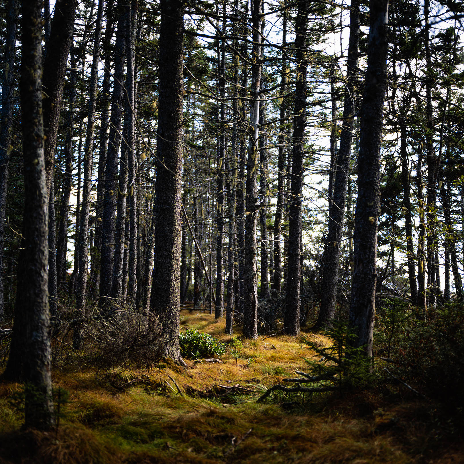

@trondsi Seems like the photos you posted has a red mask over them. A quick photoshop curve autocorrection to these images give: autocurve1.png autocurve2.jpg autocurve3.jpg
Also how are you exposing the film? Seems like all the images the blacks are not very black. Can you show us what they look like on a light table?

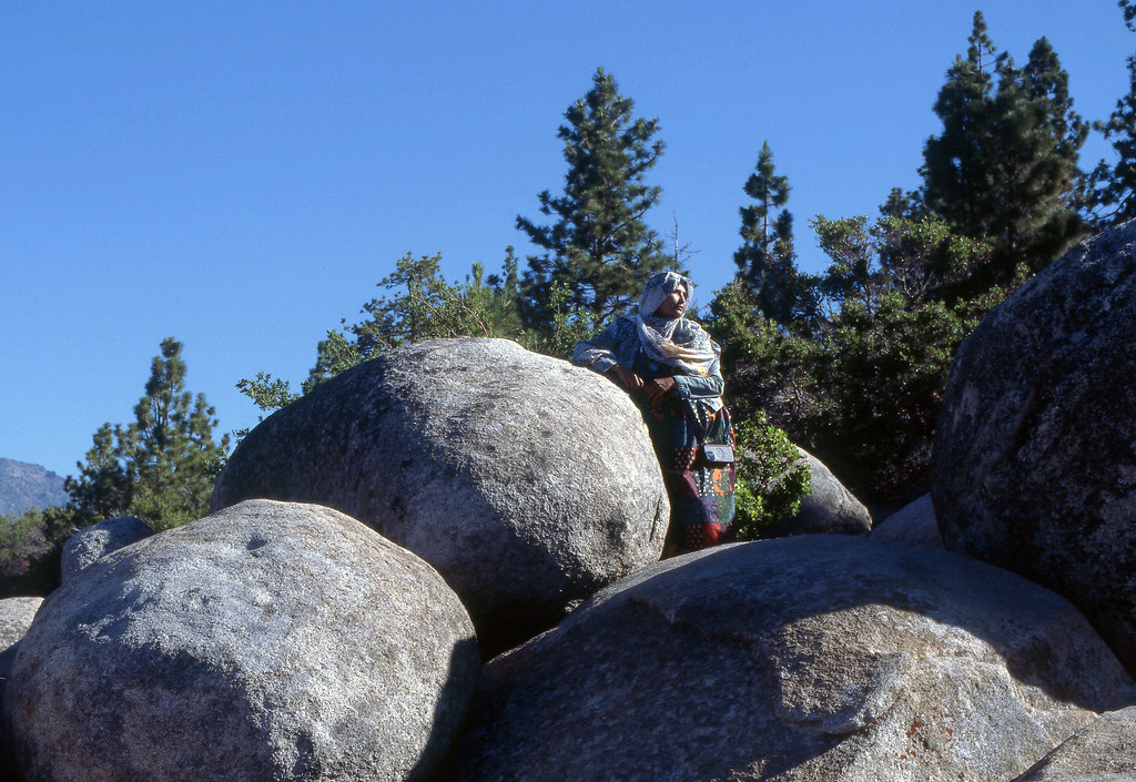

Yola - per somewhat "open shadows", note that in one instance direct light off bright granite boulders is bounced into the shadows of adjacent boulders, while in the lake shot, the reflective water surface might be doing something similar. Such distinctions are what handheld one-degree spotmeters are so useful for detecting.
Reddishness in areas of the lake shot (Lk Tahoe?) are characteristic of the warming effect of haze, especially drifting forest fire or campfire smoke, which is apparent behind the background mountains.
Put enough light behind any slide, and you might discover that none of the blacks are really black. Even black paint is rarely really black or even neutral gray - just dilute it somewhat or add some white to discover that fact.
To test for the accuracy of Ektachrome in that respect, you need to shoot a true neutral gray scale all the way from deep black to bright white under specified 5500K lighting, and then check the result over a fully corrected industry standard 5000K light box (most light boxes are way off, despite marketing claims). I've done that several times for the current E100, and it is indeed exceptionally well grayscale balanced, better so than any Fuji slide films, with the exception of the discontinued Astia line.
There's a clear magenta cast to them, yes. And as you also pointed out the black point isn't at black. None of this has anything to do with atmospheric conditions, nature of the film etc; they're purely digital artefacts. If that's how @trondsi likes their images, however, there's no argument. I personally would prefer a more true-to-life look.
I suspect the actual slide looks a bit like this:
This has introduced non-linear color casts all over the place, tending mostly towards green and yellow and with very poor shot-to-shot consistency (a big problem when frame-by-frame scanning color negative film for similar technical reasons as what we see here). In the end of course it's still a matter of taste, but frankly, if this is the direction someone would want to take it in, I'd don't bother with film anymore, especially not slide film, and just shoot digitally and then twist curves in digital post to your heart's content.

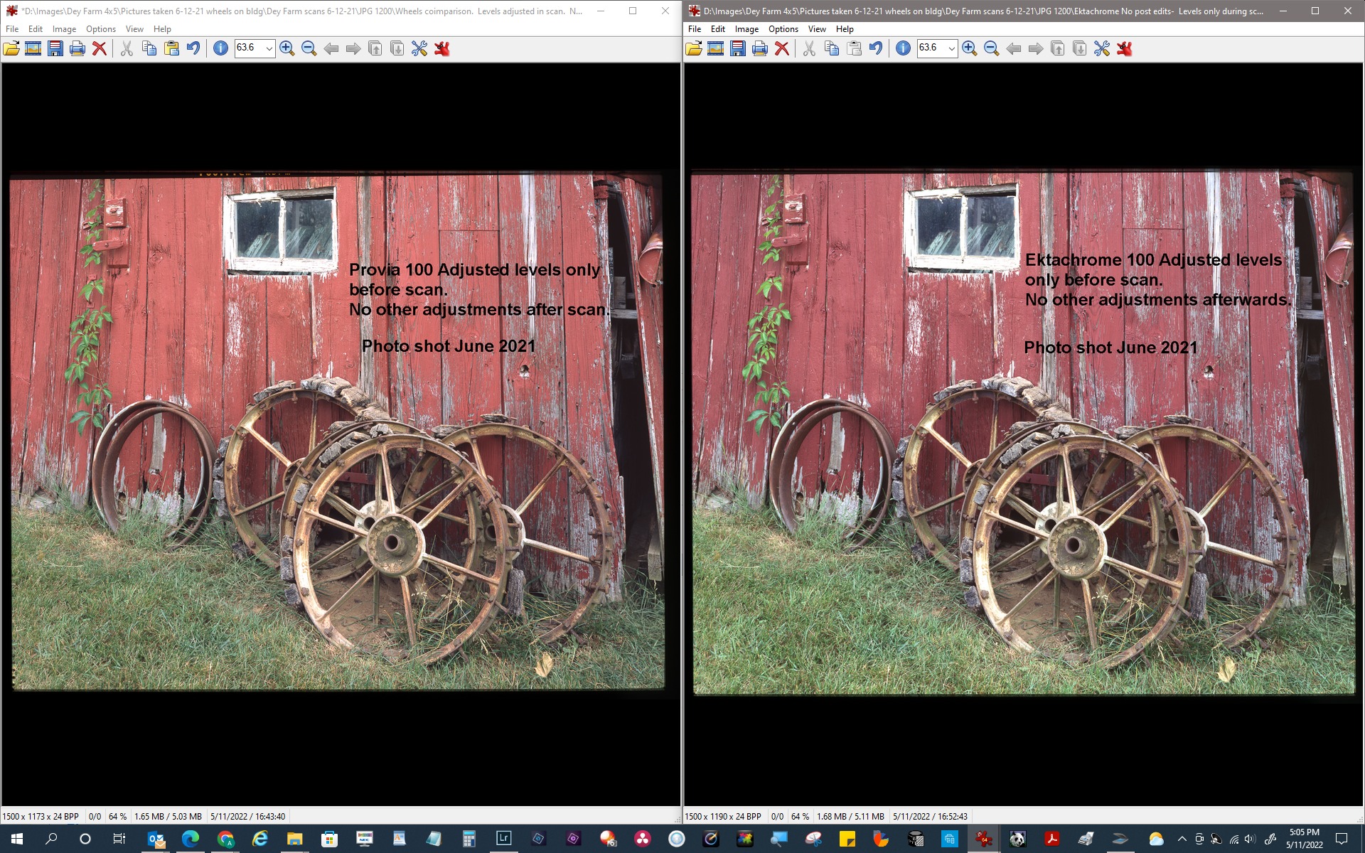

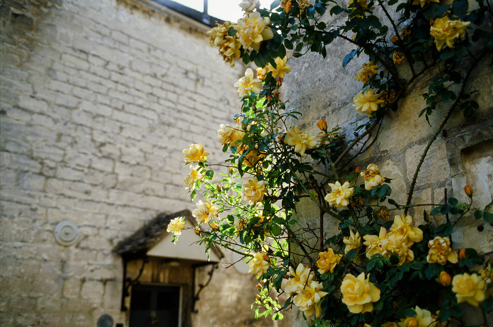

For those interested in deciding which chrome film to use between Provia 100 and Ektachrome 100 in cloudy sky. Provia warmer with orangey reds and Ektachrome has greener greens and redder reds.

Koraks - none of us know exactly what the actual film shot looks like because all we have is a scanned and altered web image. If it was taken where I think it was, overall mid-elevation warm background haze would be more common than not - a contributing factor, not necessarily the full story.

Understood, Drew, and you're right; neither of us can compare the actual slide to our screens. Magenta tinges certainly are very possible in reality.

Koraks, the PS autocorrection was just a quick way to see how the image would look if the red cast was removed.
Drew, the red mask is also very apparent in the second photo. Whether the rest are caused by drifting forest fire, the red cast seem be an scanning issue rather than where the location it was shot at.
I think we are all agreeing on the same thing that scanned images will look different if the calibration to the scanner was not done in a standardized way. I love shooting slides so I hope OP manages to solve his issue and continue shooting E100.

Everything would have to be match-calibrated in the workflow to see what is really going on. But yes, I can detect the red on my screen too. Probably several variables are at work.
One thing which hasn't been brought up yet is the effect of relatively high-altitude UV on Ektachrome. And that is one thing I haven't specifically tested for in this current E100 product. But I did have lots of experience with the previous E100G, which is quite similar. And in that case, a barely amber multi-coated "colorless" UV filter did a better job preventing a hue shift than the pinkish 1B skylight filters which worked best with Fuji chromes. It used to be that there was a significant difference in atmospheric clarity above the typical smoke and pollen zone around 8,000 ft and higher up. I did most of my testing around 12,000 ft elevation. But now our horrible mega-fires sometimes dramatically alter that.

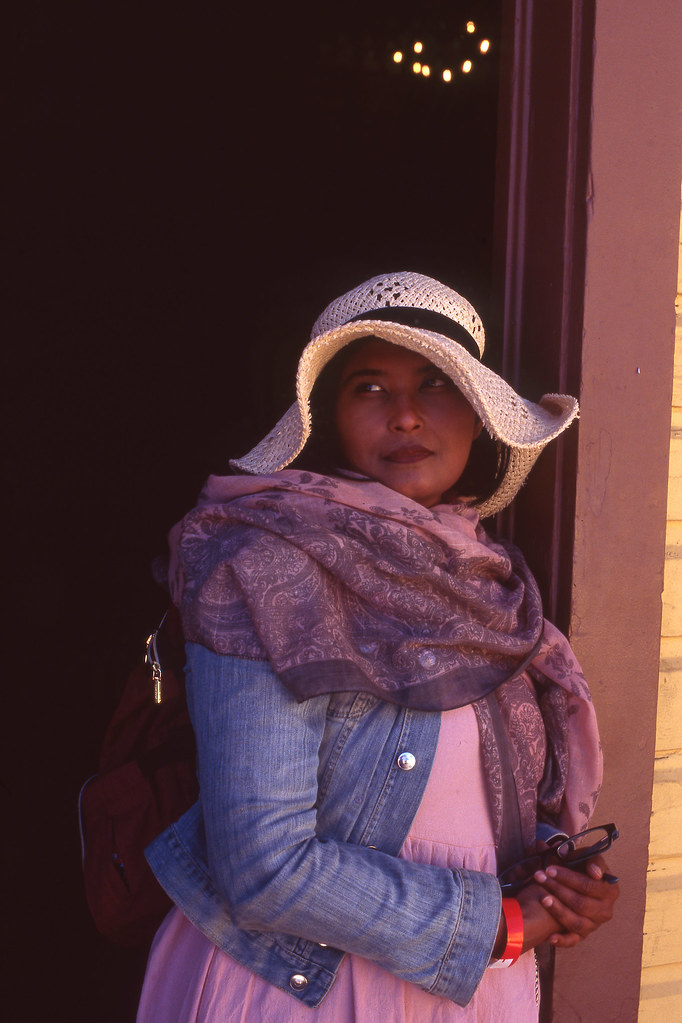

This one looks fairly OK, but none of the versions of this particular photo is close to the slide. Looks like my scanner is really failing on this one, so let's see if I can calibrate it to E100. I suspect that won't do though. Other adjustments by others above are way too yellow/green and don't look like E100 to my eyes. I'm not really going for a neutral look.
The way I think: I generally try to make my (fairly basic) scans look like the slides on the light table (the lake photo is a fail). The exception is if the slide looks a bit off but can be "saved" in scanning somehow. I primarily photograph for myself, although sharing online is nice of course. I occasionally print, so then I try to adjust again.

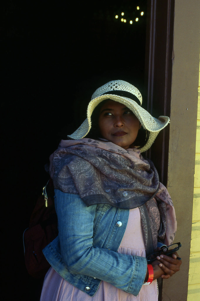

Overall, I think the close-up portrait of my wife (post #28) looks the closest to the actual slide. That is, if I look at it with a white frame on the computer.
To the comments on shadows: the shadows in the boulders are NOT 100% black in the slide.

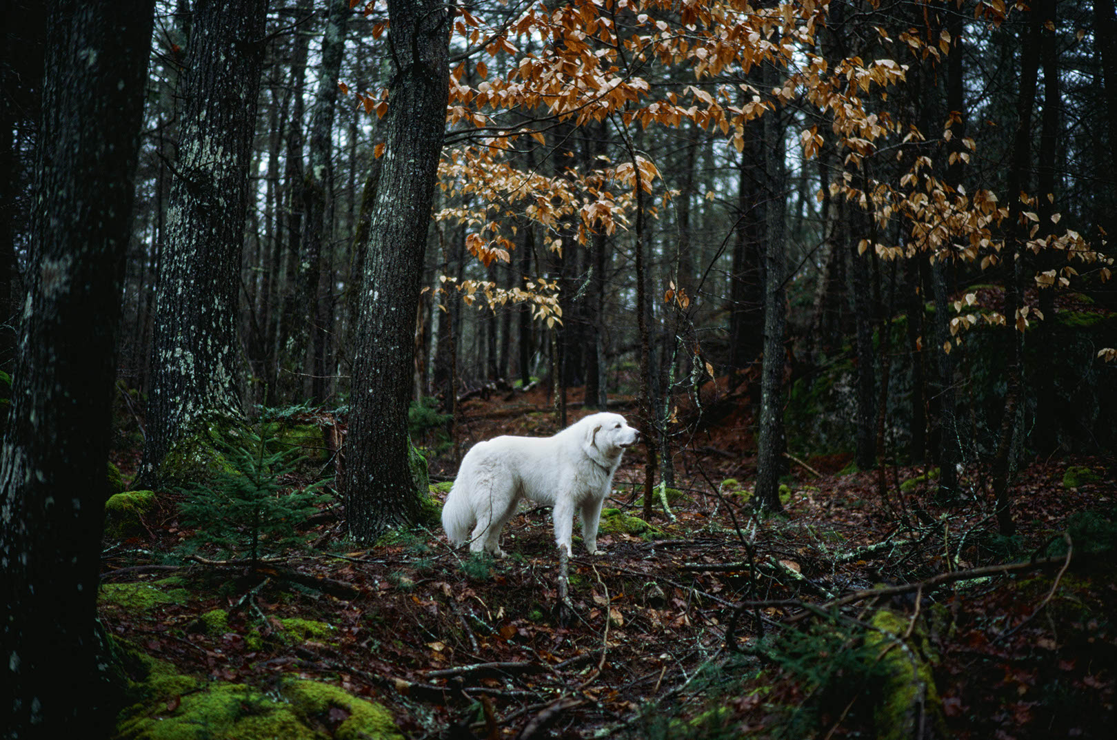

E100 just wants you to nail the exposure.
As does any slide film. Nice pics btw, especially the first one.
I will agree that the blueing of shadows with E100 does seem more emphasised than with Fujichromes though.

E100 just wants you to nail the exposure. Go a little under and it cools more.

Yep! His name is Moses, we call him MoMo. He's a psychopath but we love him.
We have a European-style Pyrenees female (too much black in the fur to be considered "proper" by American standards). She's super strong and stubborn; definitely not for beginners, but awesome in every other way.
