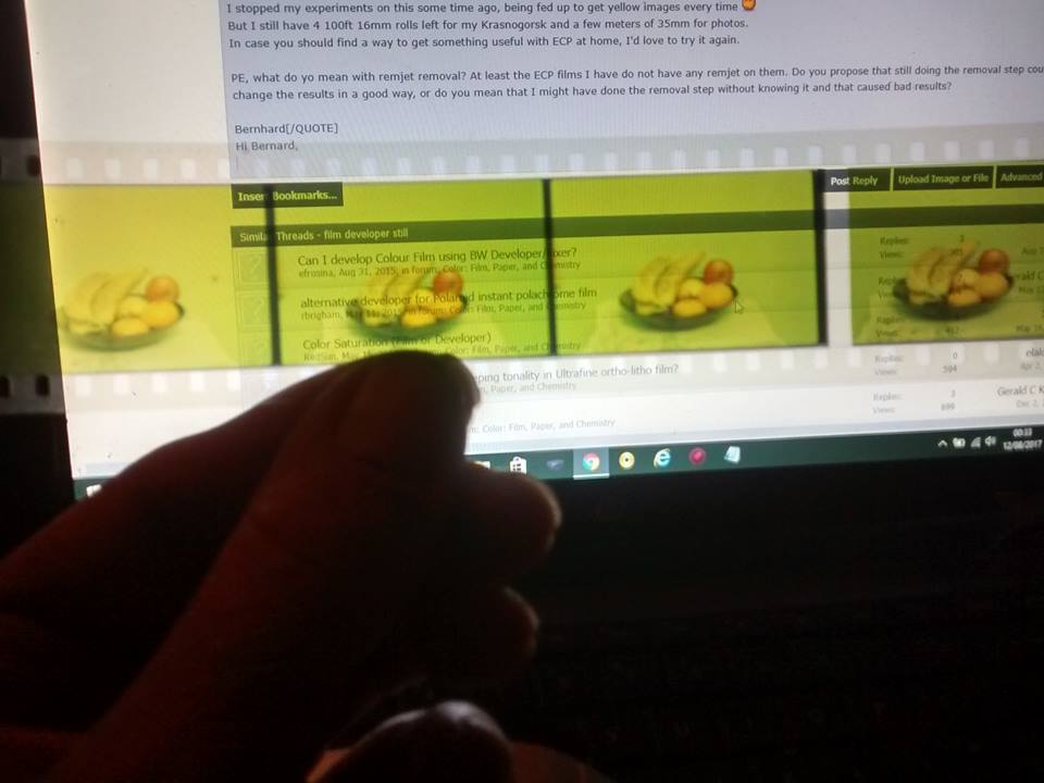

I stopped my experiments on this some time ago, being fed up to get yellow images every time :getlost:
But I still have 4 100ft 16mm rolls left for my Krasnogorsk and a few meters of 35mm for photos.
In case you should find a way to get something useful with ECP at home, I'd love to try it again.
PE, what do yo mean with remjet removal? At least the ECP films I have do not have any remjet on them. Do you propose that still doing the removal step could change the results in a good way, or do you mean that I might have done the removal step without knowing it and that caused bad results?

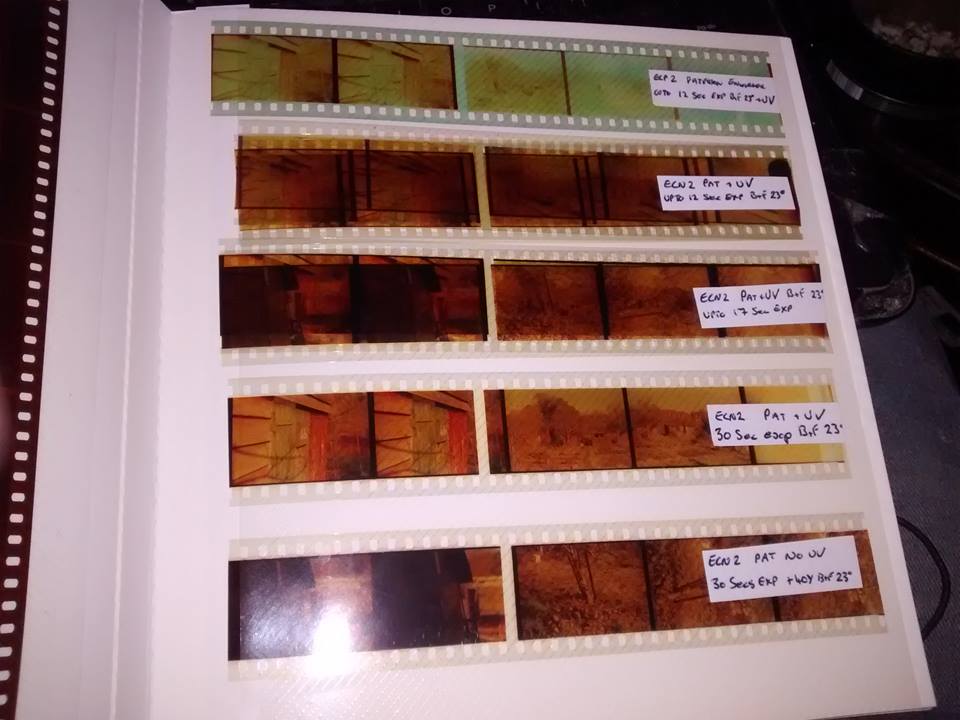

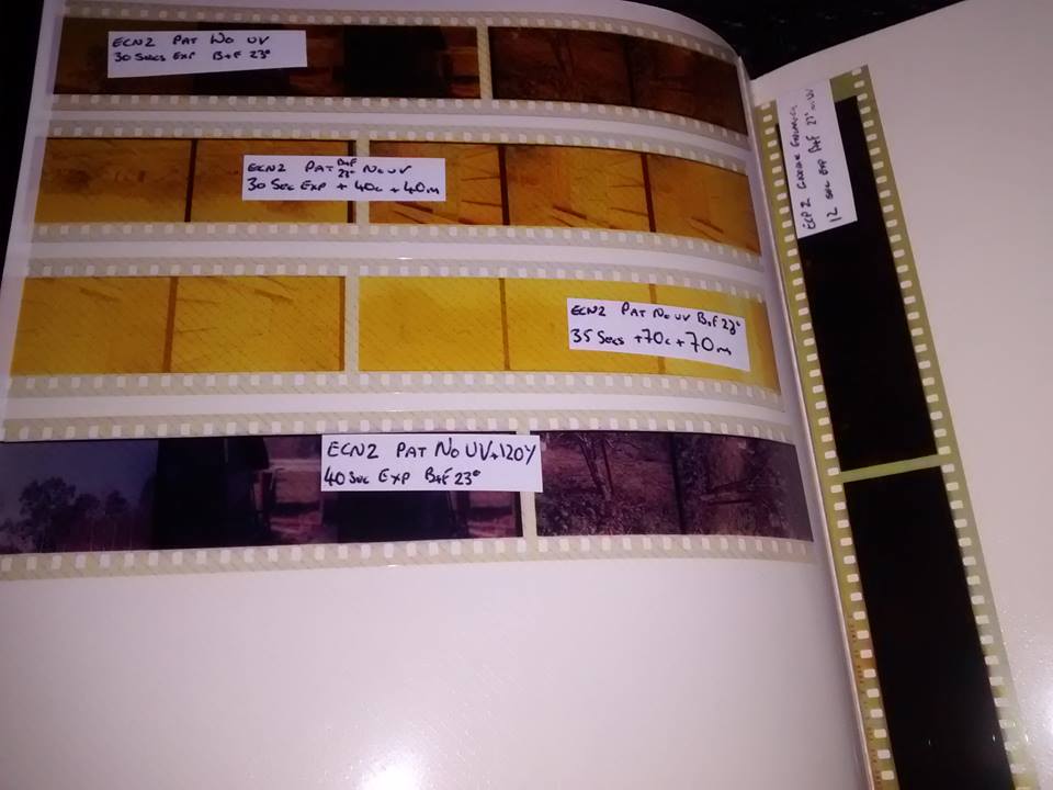

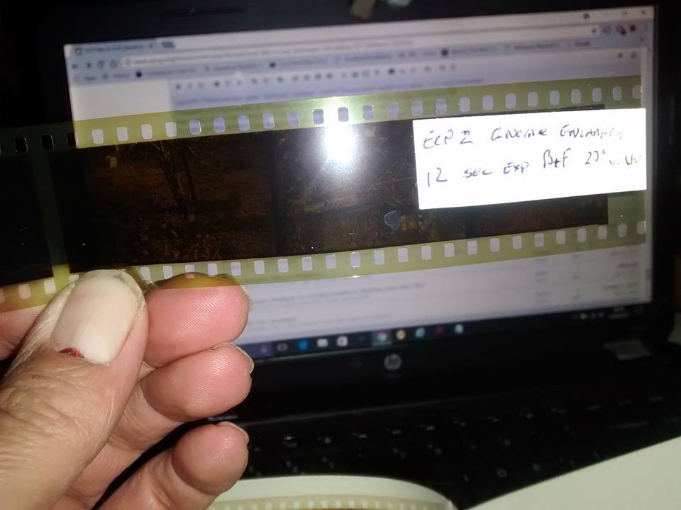

I found some of the stuff where I bothered to take notes. I have to correct myself! It was green film base with the ecp2 and I had yellow problem with the ecn2. This was contact printing from Kodak Vision3 films onto 2383 using a paterson enlarger. I got close to some good results using ECN2. OH I see what i did, I used all the yellow in the filter pack. I'm not sure why the ECP2 gives the green film base. The chemicals are working solution pour off from a cine lab, so its the proper stuff.

Hi PE, 2383 is very slow indeed, 40 secs under the paterson enlarger is where you have to go to. I remember why I gave up with 2383. You really need an RGB filter pack and a lot more than a 150W bulb to get the exposure times down to workable levels. I can get 1000's of feet of 2383 for pennies! Most of its rotting in warehouses, a great shame, and to think most of the printing machines in the UK are now sitting in landfill somewhere :sad:.

It is not green, it is yellow. Add about 100 yellow to the filter pack and double or triple the exposure.
PE

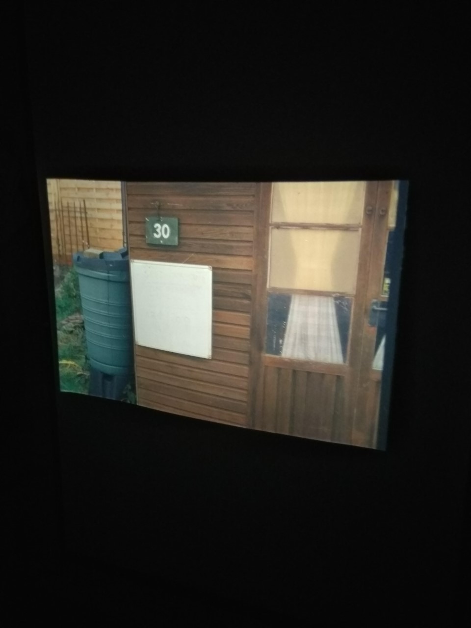

Shown is 500T contact printed to 35mm 2383 with 80Y + 5M filter pack setting.

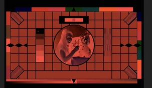

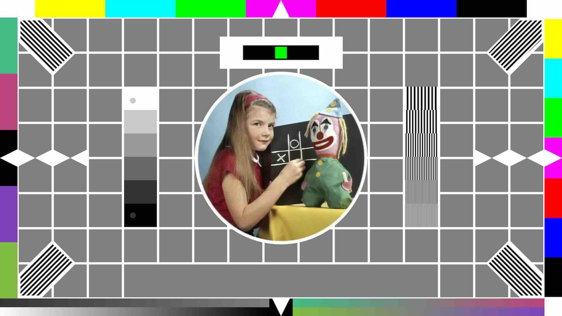

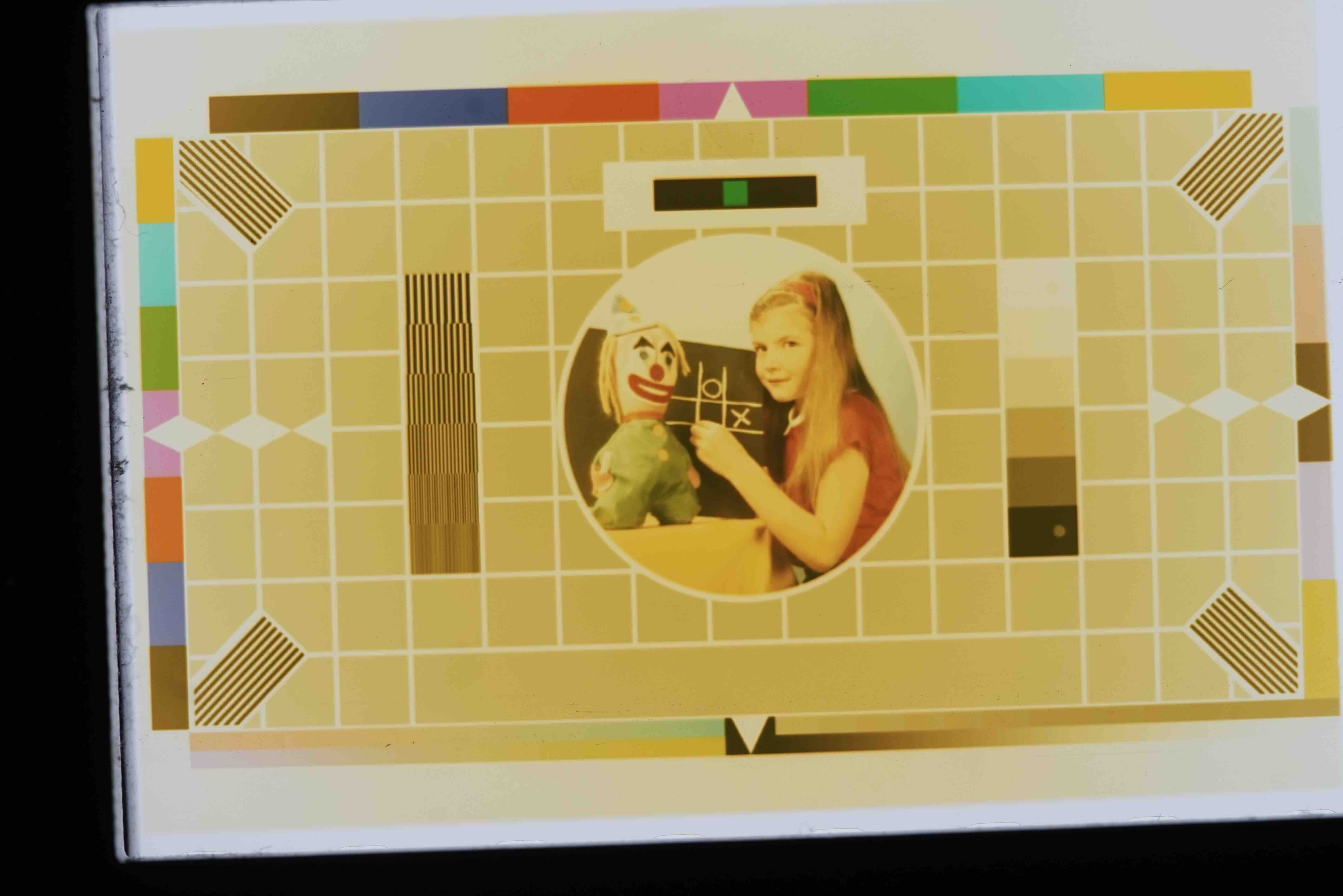

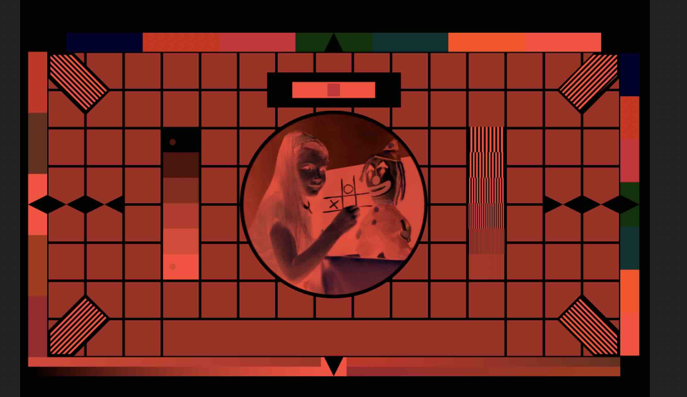

Hi there, Ive been having fun shooting images from my monitor onto the print film. attached is the image of the test screen I'm using and the reddened negative image I display on screen to create the slightly yellow cast positive image on film next to it.
I use a program called after effects a lot at work so I used it to create a timeline with the levels changing on every frame then shot a roll off and processed it as a means of testing, then narrowing down the results. I've tried to emulate as best I could what the colour enlarger head might have been doing with its filters but in RGB colour space. I have to say its a real head spinner trying to get my head around the way colour is working, very fascinating. I created a filter that reduced green and blue outputs of white to zero , then scaled the filter down to around 82% of it's effect. This gets me somewhere near the ball park of 3 colours coming through. I'm using a non OLED monitor so the blacks have some white in them, I'm guessing that is why all my greys are yellowish. I might try a filter over the actual lens to reduce the the yellow and I'm going to borrow an OLED to see what kind of results I can get with it. Any suggestions of experiments to do much appreciated :smile: and thanks again for your insights above, they got me producing some passable images.
Maybe. I'd expect the backlight bleed to produce an overall cast alright. However, in mid-grey, this should be mostly correctable, so I'd expect it to mostly affect the black point. It creates a bit of a nightmare since the color cast induced by this effect is non-linear, so you're effectively battling a fairly severe case of crossover.
Looking at the yellow mid-grey, it's really mostly a matter of color balancing still being pretty far off the mark. Apparently there's still too much blue being thrown onto the film, so you need to dial that channel down a lot further. You'll then notice that mid-grey will end up being too light, so overall exposure may have to be increased somewhat.
One concern I have with using a computer monitor this way is the matching (or lack thereof) of the subpixel wavelengths of the monitor with the spectral sensitivity of the color layers of the film. It's quite conceivable that there's no way to get pure colors due to the monitor's colors not being a good match for the film. E.g. the green channel of your monitor may also affecting the red/cyan and/or the blue/yellow film layer, etc. To an extent, you can correct for this within the center of the gamut, but depending on how bad the problem is, you'll sacrifice in terms of pure/saturated hues. Effectively, the gamut becomes very small and images remain muddy, regardless of how saturated the original is.
The OLED screen may work better; see how that goes. Many smartphones have OLEDs, especially the higher end ones. Might be worth a try.

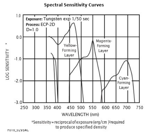

Edit: to expand on the above, I looked up the spectral sensitivity of Kodak 2383 print film:
Note two things in particular. One, the green/magenta curve in the middle overlaps with the other channels at either end. In order to keep away from this cross-contamination, green exposure needs to happen around 550nm or so. You may find that exposure with 525nm green (which is the common wavelength for green LEDs) results in formation of yellow dye along with magenta (i.e. if you try to print pure magenta, it always becomes red instead of pure magenta).
The second issue is the vertical lines to the left, around the 400nm mark. This is UV sensitivity of all three layers. Going back in this thread you can see Ron Mowrey/PhotoEngineer mentioning the need for a UV filter. This might be true for a computer monitor, especially a regular IPS/TN with a CFL or white LED backlight, just the same. There may/will be some side-band emission of the backlight into the 400nm region and possibly even below this (esp. with CFL backlight). Ideally you would include a hard-cut high-pass filter with an edge at 420nm or so in your filter pack to lop off this unwanted sensitivity. UV exposure would affect all layers, but since this is a tungsten-balanced film, it will primarily result in formation of yellow dye as also evidenced by the plot shown above. UV exposure will add an overall cast that leans towards yellow/orange, it'll be pronounced especially in highlight areas (so it'll induce crossover) and it'll overall reduce contrast and gamut.
