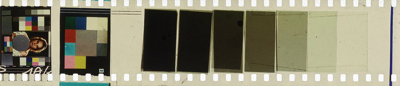

I will tell you how I did the contact copy tests to the positive color developed in the color reversible process.
I made some kind of teststripe with gray filters from subtraction printing machine.
You can also take with unexposed negative b&w developed that has a density close to 0.30.
Take a piece of glass from an old laboratory filter that you no longer use.
Remove the color filter from the glass by putting it in warm water.
Leave the first beach free, without filter (0.00).
On beach 2 glued with Scotch a piece of film (0.30).
On beach 3 glued with scotch 2 pieces of overlapping film (0.60 density).
On beach 4 glued with scotch 3 pieces of overlapping film (0.90).
On beach 5 glued with scotch 4 pieces of overlapping film (1.20).
On beach 6 glued with scotch 5 pieces of superimposed film (1.50).
On beach 7 glued with scotch 6 pieces of overlapping film (1.80).
On beach 8 glued with scotch 7 pieces of overlapping film (2.10).
Stick on the glass and a negative color chart with a color scale.
The contact exposure I made to the light of the magnifying device with Ianpol color objective.
Perhaps you can use some of these things.
George

You have an example of a color scale.
George
