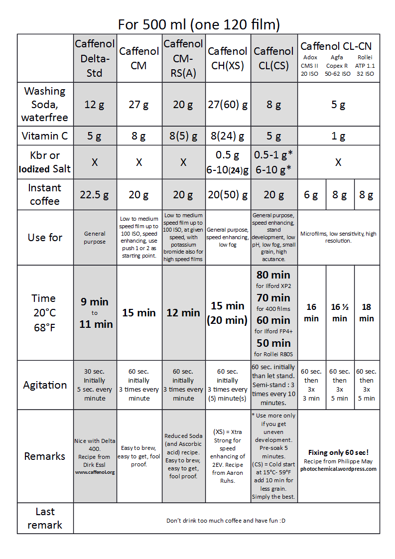

I use Caffenol for more than 10 years exclusively for B&W. Here you can find most used recipes that I've tested successful.
CL is best for less grain and CLCS for all 400+ ISO films.
fs999: Thanks! I was unaware that there was an active Caffenol Group here on Photrio. I've been looking for one as the Flickr group seems under trafficked. Viewing Flickr photos may not be the best way to judge, but indeed CL / CLCS recipes turn out very sweetly. And yes, that IS the Caffenol recipe list I've been working from. Looking to get more experience with Delta-STD and CM and CH - all of which have plenty of very fine grained photos. I've seen an article where several brands of coffee were tried and the Davidoff Expresso Instant made a "WOW" difference. Kind of expensive stuff, FWIW, but my pursuit isn't about price, but about dealing responsibly with the environment. I've been happy paying more than XTOL prices to use Bergger's Berspeed so not looking to cut corners unnecessarily. But we'll see what we can do in due course. Seeing is believing... and though not a fanatic, we all love grain that is complimentary rather than annoying... and fine grain runs in that direction more commonly. And I saw this with a preference for MF over 35mm (though I like the handiness / speed of use with 35mm), and with an eye to giving 4X5 a try.
