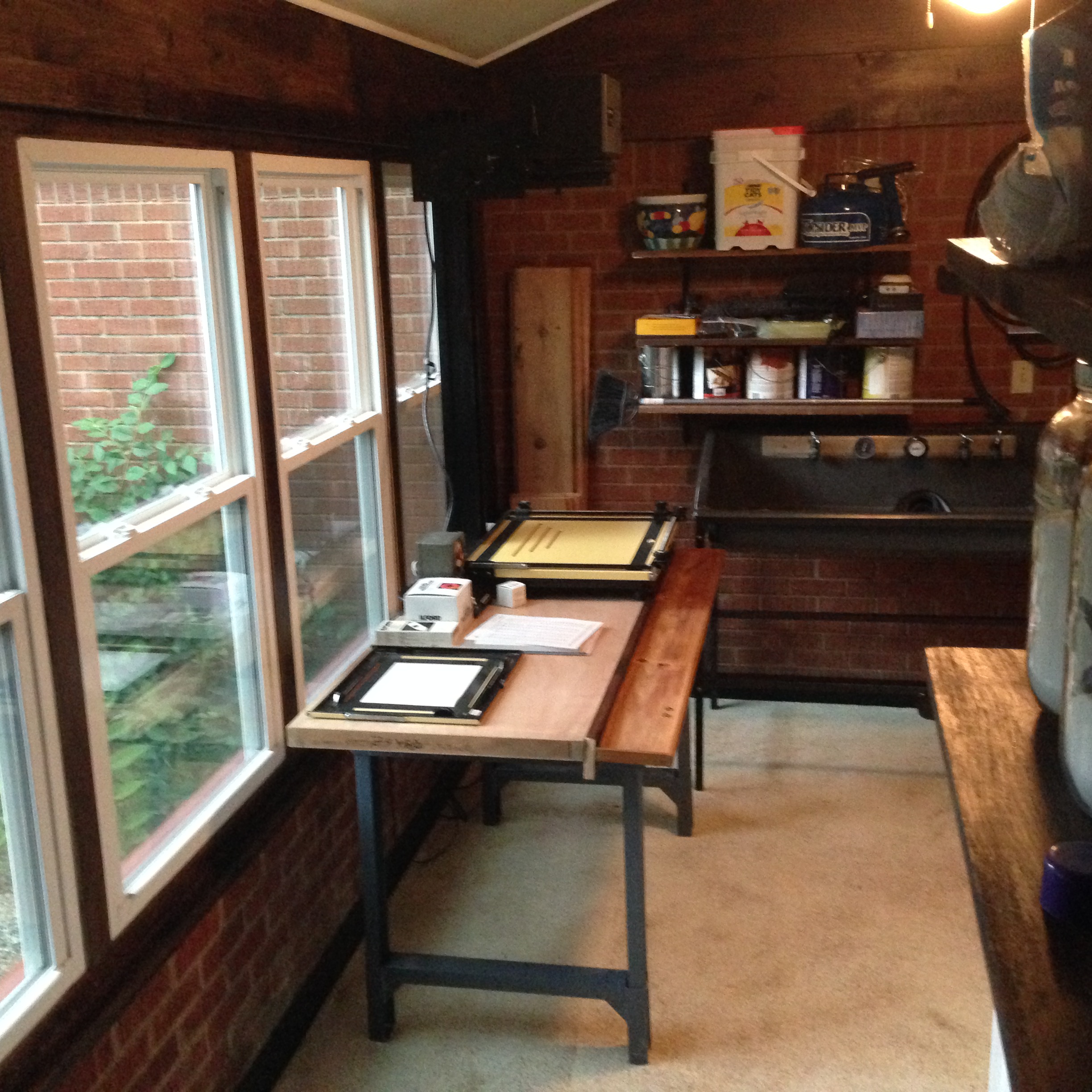

The LPL 7451 is the first LPL 4x5 enlarger, and is, by a reasonable margin, smaller than all models after it. The 7451 was pretty much an upscaled LPL 7700. The LPL 7700 and the LPL 7451 use the same wall mounting kit, I know as I used the same kit to mount both enlargers onto the same wall.
A sturdy table under the wall mounted enlarger will work perfectly well, I did this for years. I then made up a special drop table where I had the base board sliding on three sets of rails. One set of rails at the top, another about 250mm lower and a third set of rails about 500mm below the top setting. Worked a treat.
Once you have aligned up your moveable table under your wall mounted enlarger, you just need to ensure you do everything as per the original set-up each time. Took me about 30 seconds.

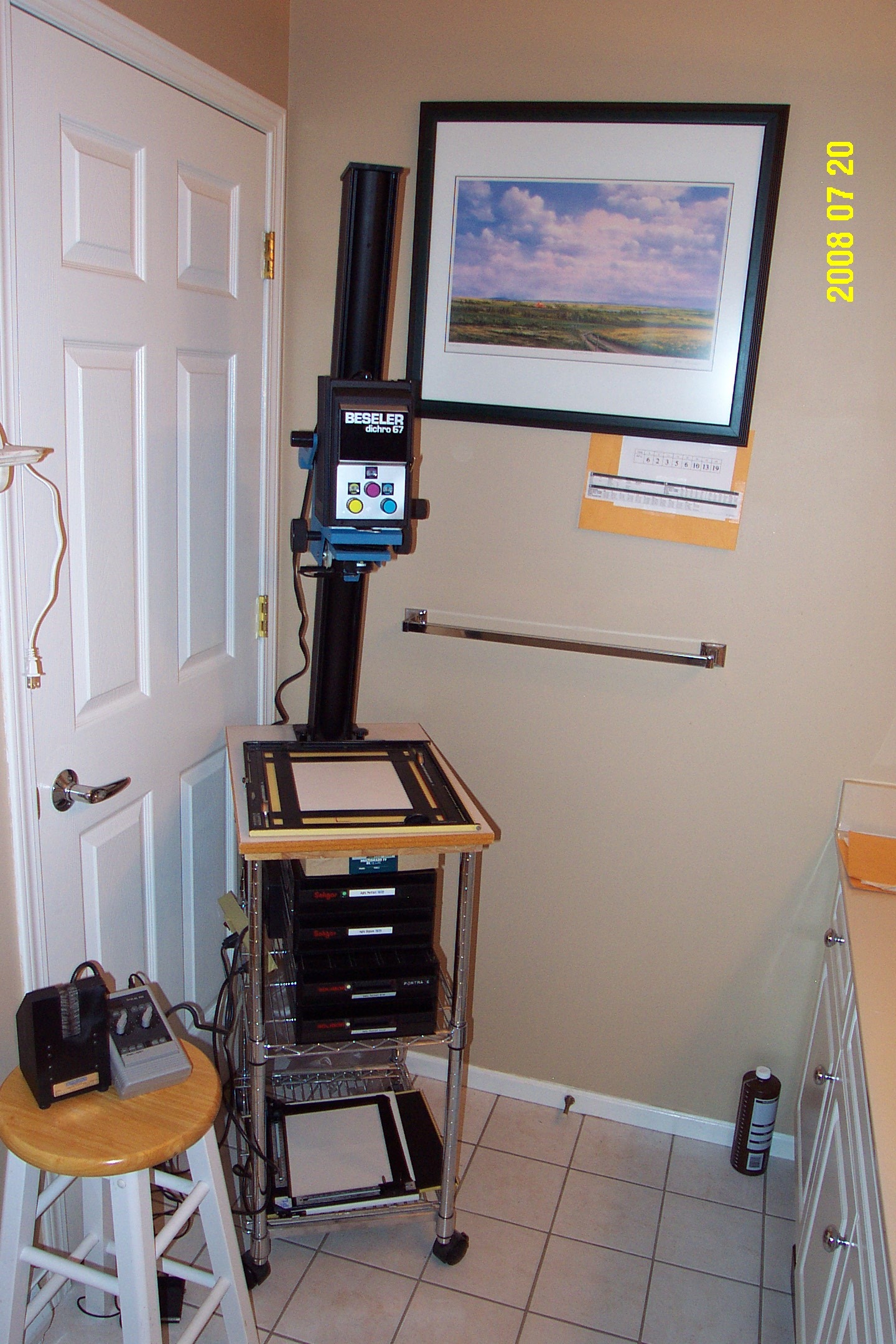

Beseler 67C on a microwave cart:
View attachment 159978 View attachment 159979
You might be able to do something similar with an Omega D5 and a bit heavier cart. Something like this:? http://www.rubbermaidcommercial.com...ial_handling_heavy_duty_utility_carts_4500-88
I used to do this with a Beseler 23C and a wire cart when I was running a bathroom darkroom. I could fit pretty much my entire darkroom on the cart - enlarger on top, print processor and wash tray down below. I had (still have) a Nova vertical slot processor that would let me print up to 16x20 in an apartment bathroom. Doesn't help you with the 4x5 enlarger, but the concept is certainly valid. You MIGHT be able to find a cart substantial enough to mount a Beseler 45 M-series chassis on top, and then have a mobile darkroom. But that would still be a rather large to-do. There are short column Omega D2's and D3's out there that might be workable.
I'm definitely considering putting everything on a short cart now that i found a short-column D5 (43" more or less) to work with. I'll have to see how much weight total and what I need to keep it from tipping over before getting to that part.
