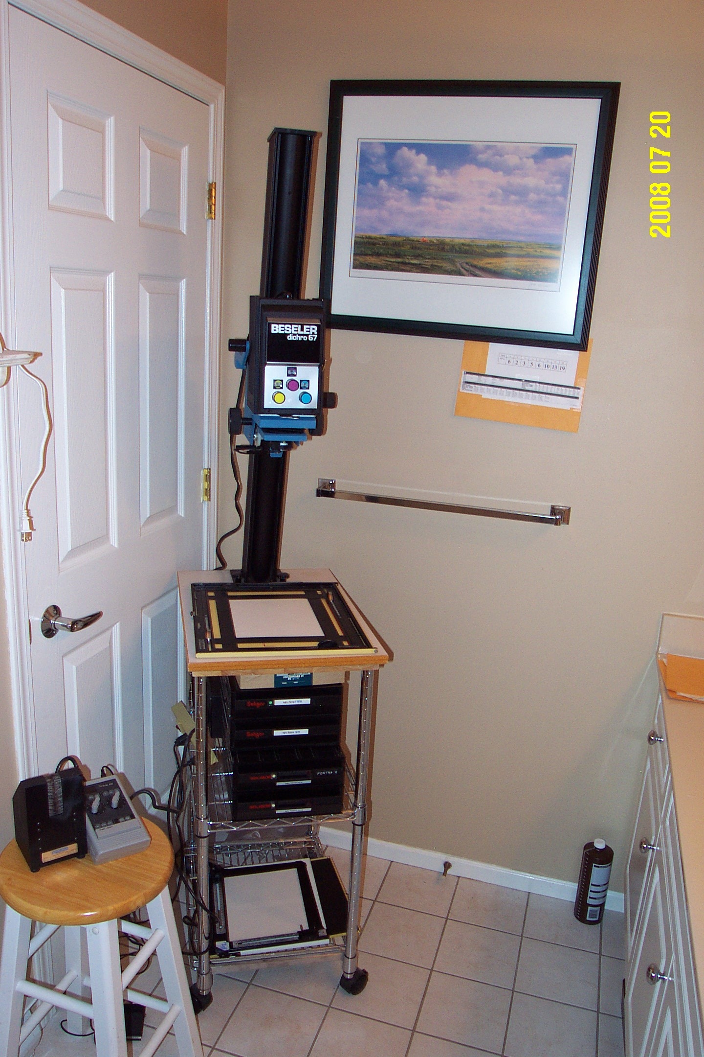

As mentioned above, I would go with a 6x7 or 6x6 enlarger on a cart (microwave, cabinet with casters, etc). You "might" be able to put a 4x5 on a similar cart, all depends on the size of the baseboard and the cart. With the cart, you can roll the cart out of the way and into a closet or the corner of a room. This is what a friend of mine is doing; stored in the corner of the family room (under a cover) then rolled into the bathroom to print.
In my single days, I had a Beseler 45V-XL on a low TV cart in a second bedroom, which I had set up with light blocking curtains so that I could even print in the middle of the day. I agree that disassempling some enlargers is feasible when they are smaller, but 4x5 can entail some heavy support columns. It was a massive effort simply to move to a new house, and I cannot possibly imagine take down and reassemply just for a printing session! Even the baseboard alone is hefty. The low TV cart was needed because of the extra long column on the 45VXL.
