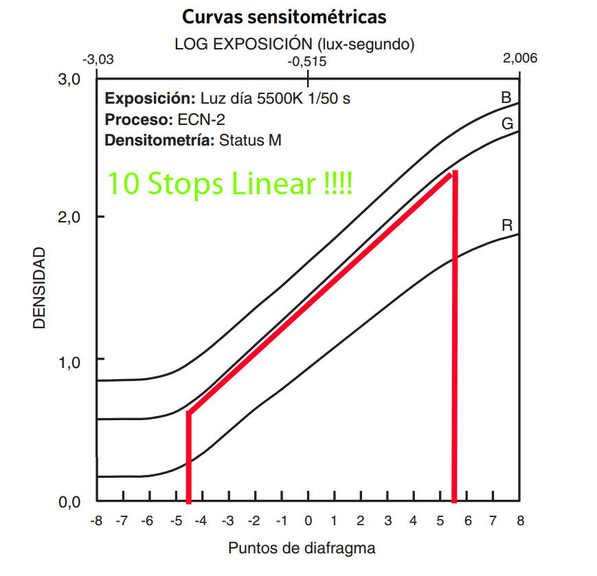

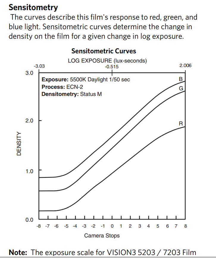

Well, this is the 50 the graph:
If you see the "0", it is 5 stops far from speed point, so as an starting point they suggest overexposing it by two stops... but there is more... even when overexposing the 50D by 2 stops you still can overpose 8 additional stops and still conserving texture, not a joke, see the graph.
Regarding colors, it is designed to be copied on film, not on RA-4, so regular color inversion based on RA-4 nature may not do a perfect job, so it requires (and deserves) a 3D LUT Creator job.
I like a lot the V3 spectral signature, but I found I need 3D LUT job to suit my taste.
so.... regarding your question about how to exploit the V3 spectral footprint, here there is the answer: A 3D LUT to overcome RA-4 vs Copy film inversion missmatch.
I can think of a long list of why 5203 isn't superior as a still imaging film. And yes, I've used it. For starters all Portras are drastically sharper in areas that are perceptually important in still imaging.
The 50D is damn sharp, also see the granularity vs exposure graph in the datasheet. Single thing you have to do with V3 is not underexposing it.
If you don't get perfect sharpness then overexpose it more, this stuff likes light, don't worry, you are not to toast it easily.
It would help if you looked more carefully at it. The '0' represents the midtone - 3 stops up from the start of the straight line and 4 stops below the shoulder. 7 stops of recorded range on the straight line. As it should be.

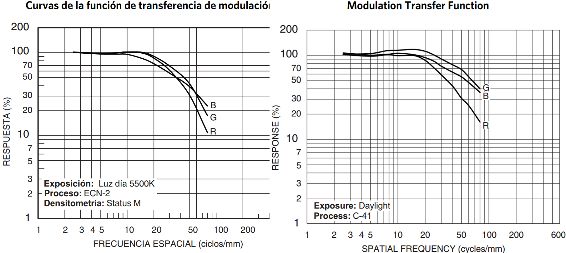

Regarding lp/mm, the same than portra, V3 graph is better done, not surpassing 100%:

Your reading of sensitometric curves is rather creative here. 5201 delivers about 6 stops of straight line, 5203 can deliver maybe as much as 8 on to 2383 - thus the 'improved highlights' claim. Your toe and shoulder points are way too deep in the toe and too high on the shoulder.
When you set the exposure for MP negative, you key to the highlights - because you cannot easily burn them in at the printing stage (unlike still negatives). Thus highlight latitude/ retention is important especially for outdoor usage where not having to fill shadows heavily (always fun on a slow stock) is a definite advantage - and 8 stops often seems closer to an average outdoor scene than 7 - and given the conditions you may end up using a 50 speed stock under, a stop or so of fill is a heck of a lot less than 3-4!
Those data sheets are correct & overwhelmingly match what I have seen from using both films. For various reasons well covered in the academic literature of film system engineering, colour neg still film is engineered to give significant edge effects on big objects, which is the cause of the over 100% response on the MTF curve - which is a measure of sharpness, not high/ low contrast resolution - for that matter because MP film is principally used in formats smaller than 645 in area, contrast matters more than edge effects in terms of perceived sharpness - indeed it may be the case that if the format is not large enough to exploit the edge effects on large area objects, the enhanced sharpness may merely raise the noise level and reduce the film information capacity. What the MTF curves show are some of the differences between a film engineered for S8-65mm versus one engineered for 135-8x10 or bigger. This difference becomes quite obvious in 120 format where key changeovers between edge effects and contrast seem to happen.

Lachlan, perhaps if I show you the 50D datasheet graph at full size then you would be able to count linear stops: 10, not 7. Its about counting, 1, 2, 3...
https://www.super8.nl/file/7203.pdf
It is quite evident you have shot little 50D (or none), I you were experienced with that film you would have noticed how it works in the highlights, and you would realize how top notch cinematographers use it.
10 stops linear, 15 total, with standard processing. With some pulling you get 18 or 20 total, not a joke.
Buy some and expetiment a bit, $0.5 per feet.
