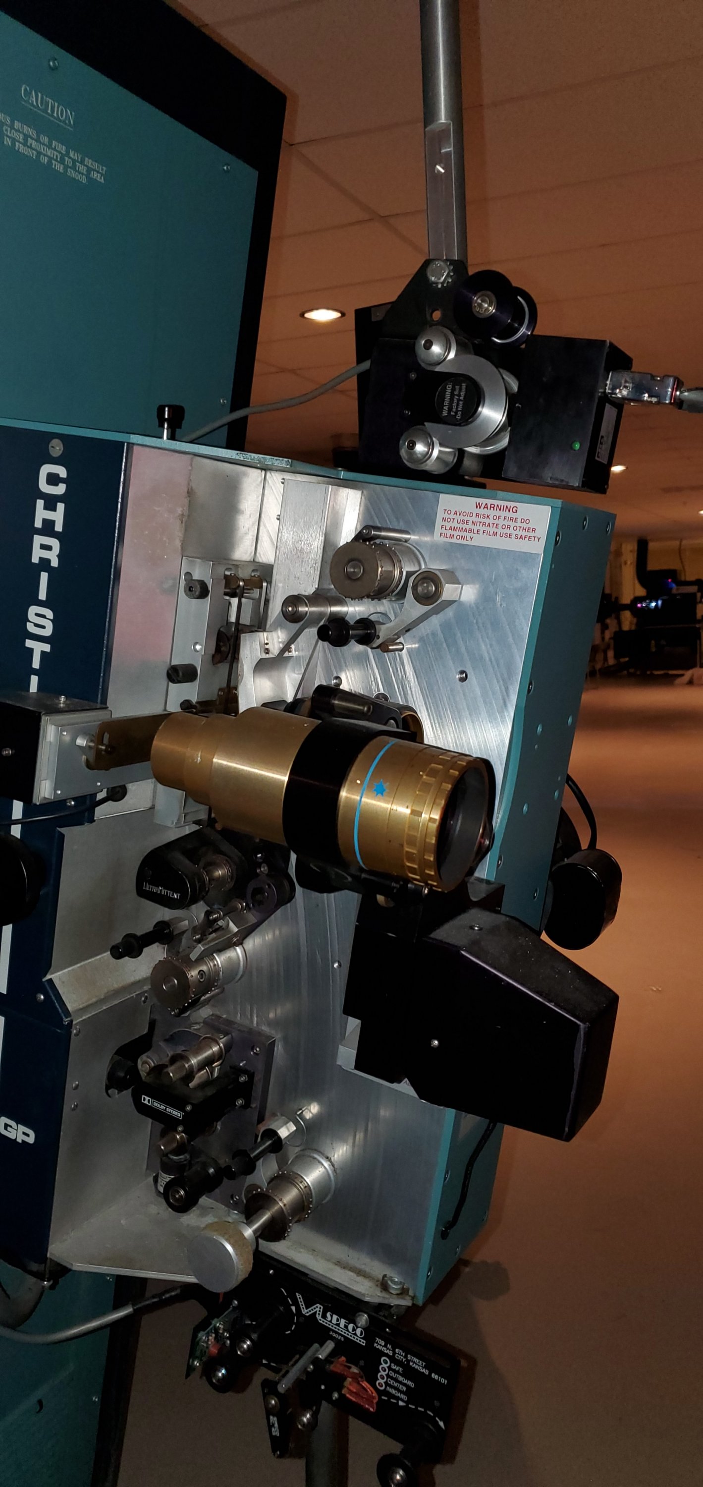

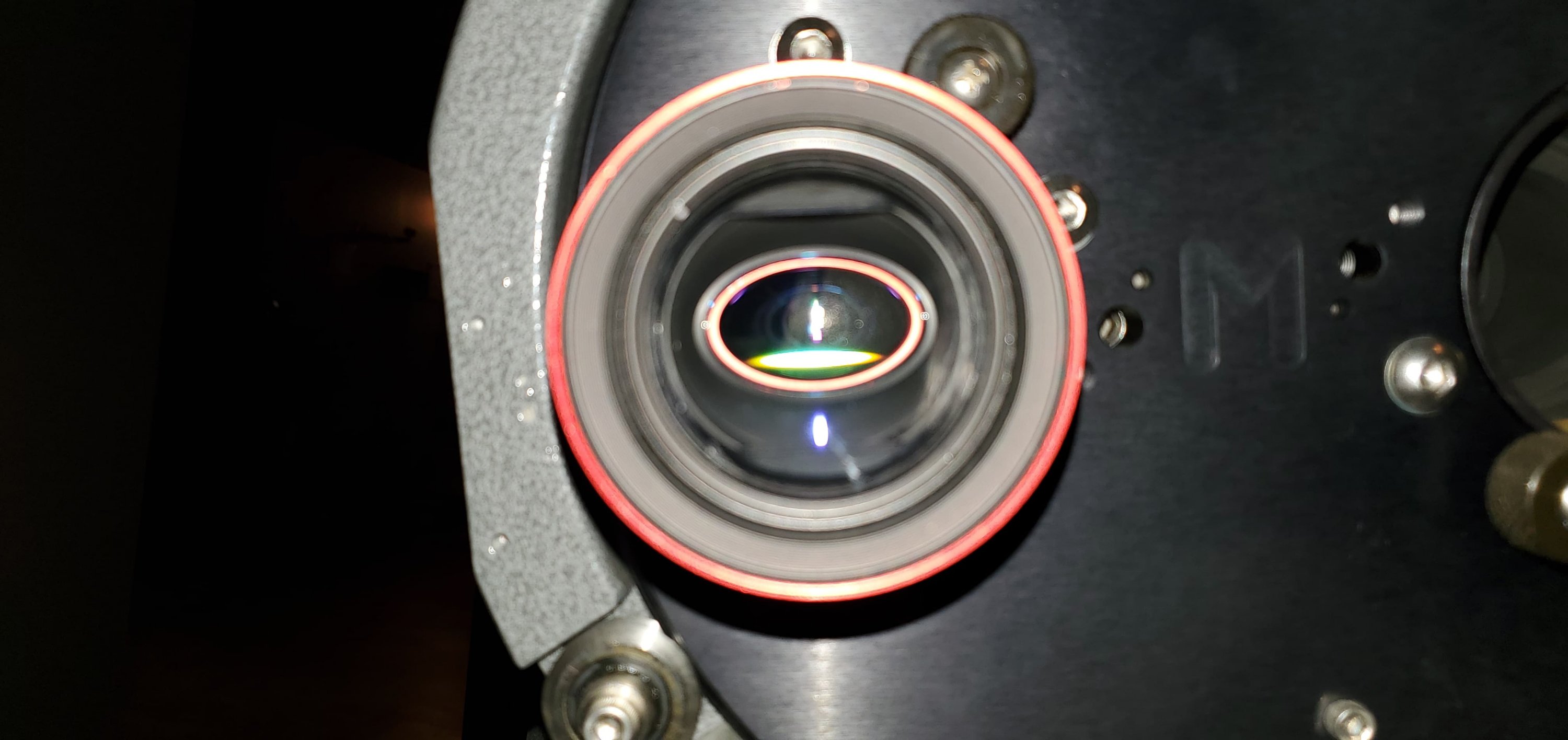

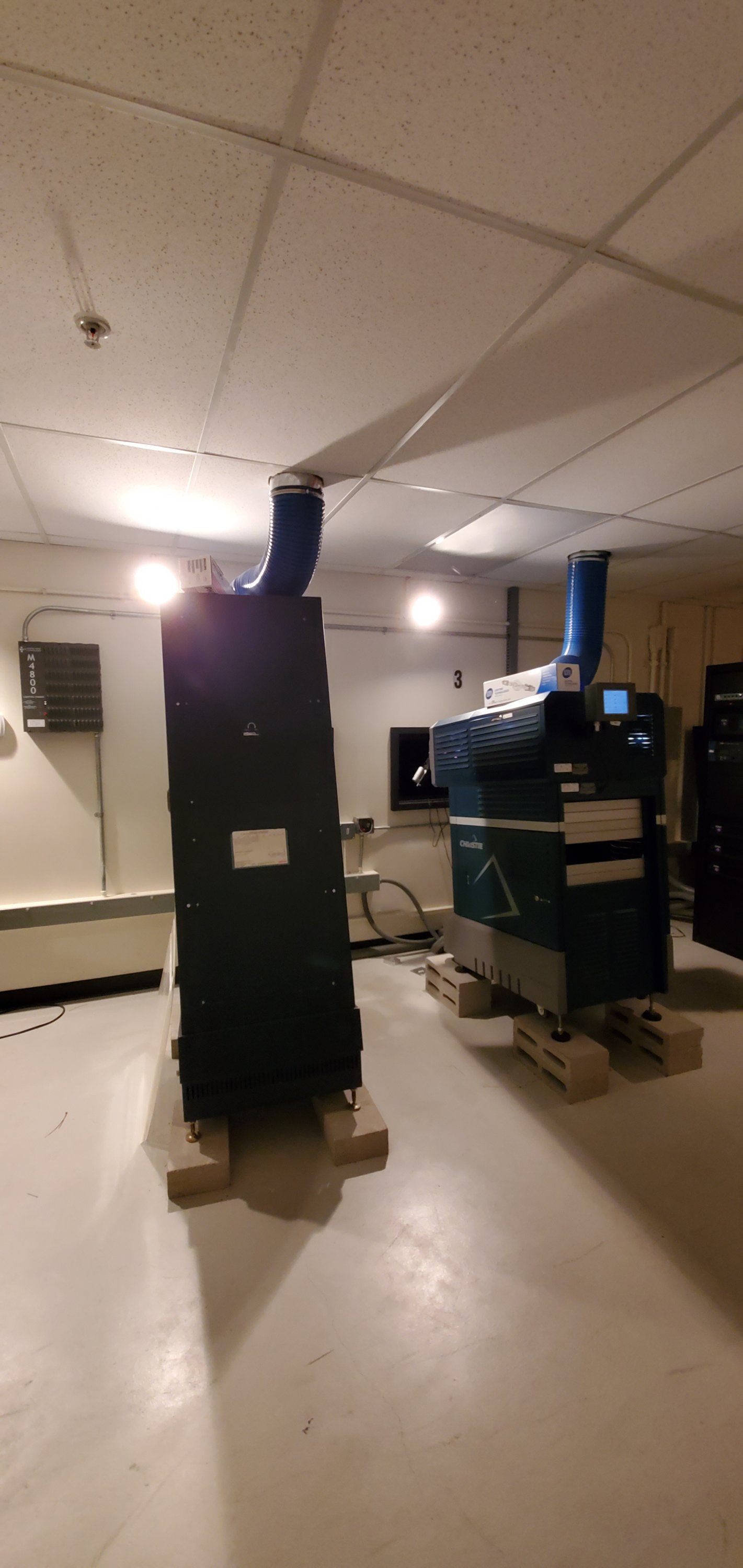

Hey something I can chime in on. I'm a traveling theater tech and this has been my experience as well. For most of the theaters I have serviced over the last year if they had analog equipment at one point it's mostly still there. I asked about this and most have said it wasn't worth the time and effort to actually move the things.
There is still hope yet that these machines could run again.
20190507_185109.jpg 20190507_185450.jpg View attachment 238954
The theater in question actually still maintained there analog projectors, there was another I visited in Florida did the same. One thing I noticed for sure was there were many diehards still around.
I was very surprised at just how many theaters I've been to still have the equipment on site or still maintained. The main issue I could see is I know for a fact that the Technicolor distribution center in Wilmington, Oh sold off or destroyed a lot of their equipment back during their transition to digital cinema. My wife would come home from work and tell me horror stories about the things she would see.
This is just my opinion but the way I feel is if there is demand at least some of the infrastructure is still around to satisfy it. One can dream.

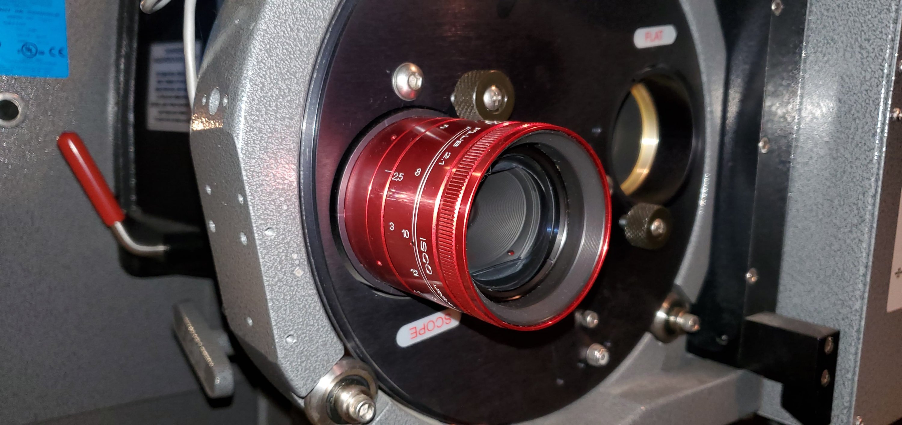

If you happen across a Micro ISCO anamorphic projector lens that's not being used I'll gladly take it off someones hands. If it's a red one I'll trade someone's hands for it...
Oh trust me I've been trying. So far none have wanted to give up their lenses.
65100760_385211695535037_1602538081519403008_n.jpg 64528505_2362800490668616_7390705866699177984_n.jpg
View attachment 239042 View attachment 239041
Guess you've got that covered for yourself. I have an ISCO lens but it's close focus is something like 15 feet. Not very useful for portraits and the like.
A company called Sirui just put out some single focus anamorphics. I'm waiting for them to put one out in EF so I can slap them on my cameras. I contacted them and they seemed to say it's in the pipeline. Here's hoping.
If you do somehow stumble across a trove of the reds I'm game for one.
