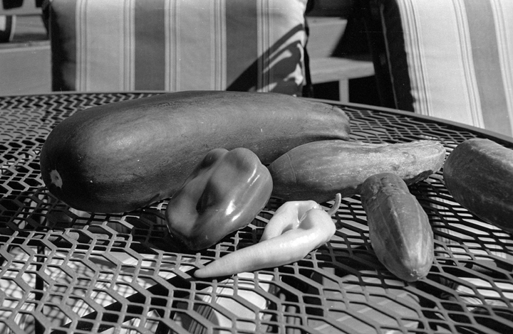

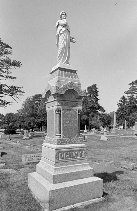

Here is a test shot that has sky and some trees in the background. What I notice is that the sky shows a pleasant grain and that I see more details in the trees than I normally do with other films. And the other shot is some veggies I should be eating. What I notice is there is something very smooth and pleasant about the way it renders a scene.
