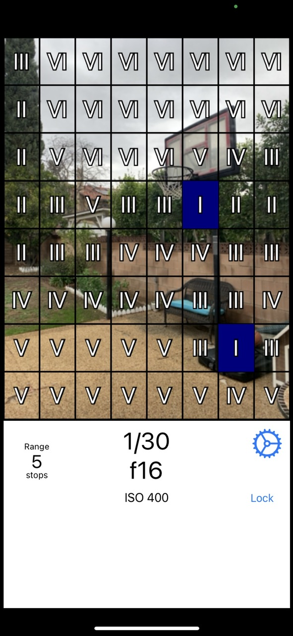

When I have nothing better to do I do scene analysis so I can better see SBR and determine potentially difficult photographic scenes. Maybe I mentioned a phone app before, ZoneView. It’s about $7 and helps me immensely. Here is an example:
The blue square represents parts of the image that exceed my arbitrarily set limits of 3stops over or under average. Aren’t these functionally somewhat like your blinkies?
P.S. this isn’t exactly the scene I measured in the previous post where I indicated a 7-stop range. This scene doesn’t have the same level of deep dark.
I use this too.
For anyone who objects to EV, here is the Zone version. LOL
Another setting of the same app.
