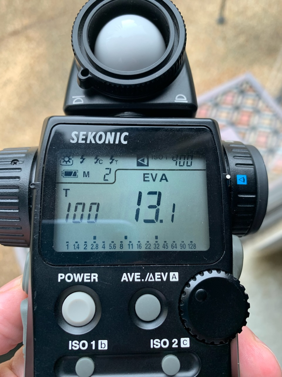

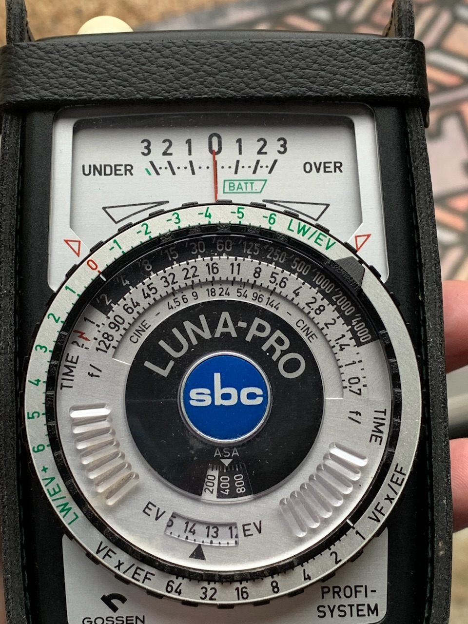

Here’s an example, Alan. Doesn’t matter which spot meter… Drew uses his memory and I use my memory button. LOL
It’s a dull day, overcast but two readings in my backyard: deepest dark shadow and cloudy sky, plus the average computed by the meter.
You can see the scene brightness range, and count it if you’d like. Seven stops,,, no problem for most negative films but one might want to think a bit harder about using that average with positive film.
And then a general-coverage reflected metering with meter aimed so a bit of sky is being measured, as one might do to protect the sky from blowing out on chrome film.
Nearly identical EVs… that’s why I don’t spot meter until I encounter a “not normal” scene.

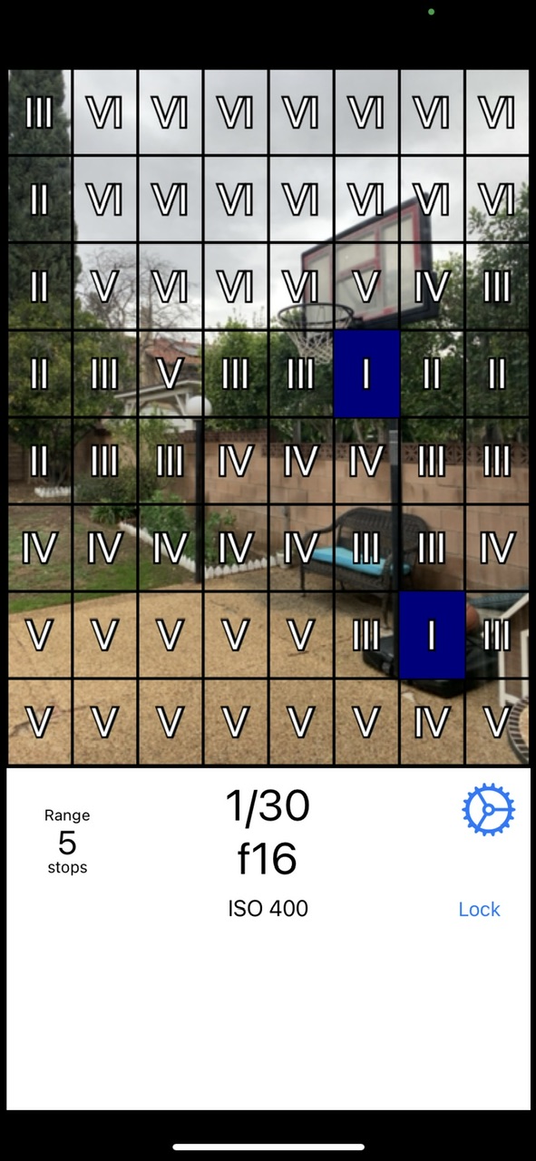

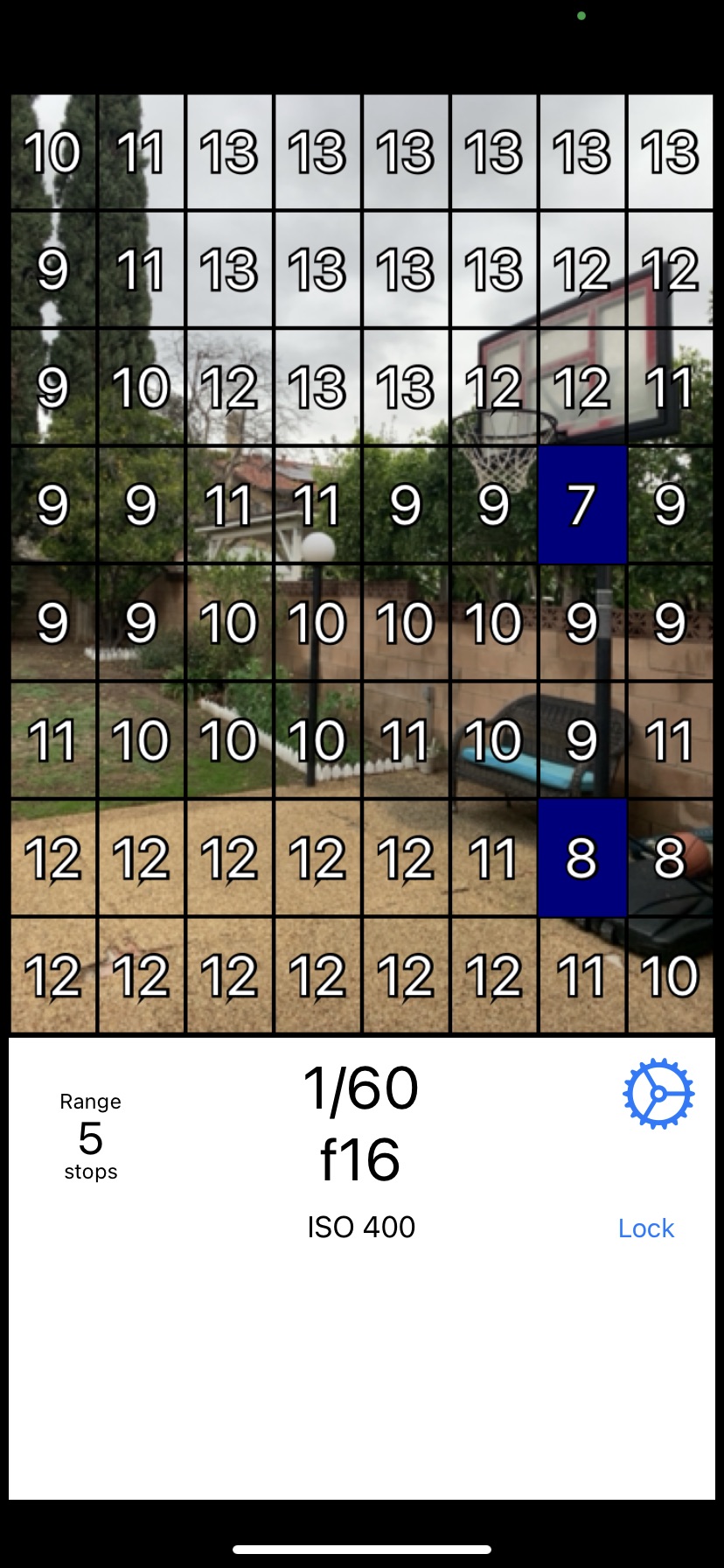

When I have nothing better to do I do scene analysis so I can better see SBR and determine potentially difficult photographic scenes. Maybe I mentioned a phone app before, ZoneView. It’s about $7 and helps me immensely. Here is an example:
The blue square represents parts of the image that exceed my arbitrarily set limits of 3stops over or under average. Aren’t these functionally somewhat like your blinkies?
P.S. this isn’t exactly the scene I measured in the previous post where I indicated a 7-stop range. This scene doesn’t have the same level of deep dark.
