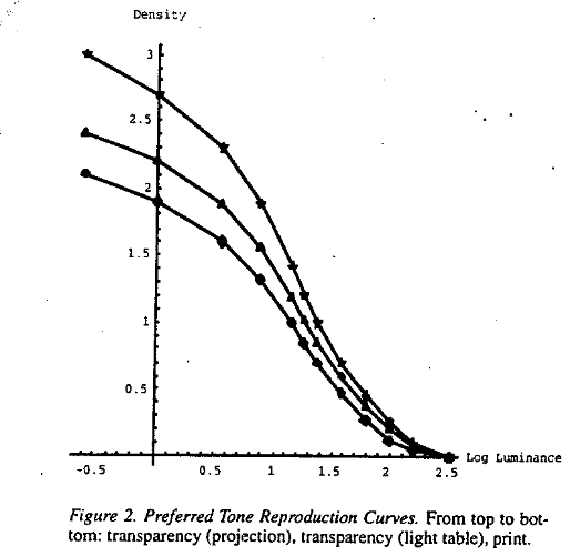

And from Jack Holm's paper Exposure-Speed Relations and Tone Reproduction. Here

Brad, How do you figure 5 stops?
The exposure range along the bottom is basically Log10, which means 0.3 units is a full doubling or halving of exposure.
So looking at the chart exposure density starts to pick up between 0.0 and 1.0 log, so lets split the difference and say 0.5 log. It reaches max density between -2.0 and -2.5 exposure. OK, so lets be conservative and say -2.2. This gives a total log exposure range from clear film base plus fog to max black of 0.5 - -2.2 = 2.7 log units of exposure. A full stop is 0.3, so 2.7 / 0.3 = 9.0 stops of exposure from clear film base plus fog at full over exposure to max black where the film is no longer registering exposure to light. That is the maximum extreme. The chart shows both a shoulder and toe, so realistically, where the color channels are responding in a linear fashion is quite a bit less.
@Alan Edward Klein to your question, there isn't really any clipping per se... it starts to either shoulder over and toe and eventually stops responding, but there's not really a hard clip or anything like that.
