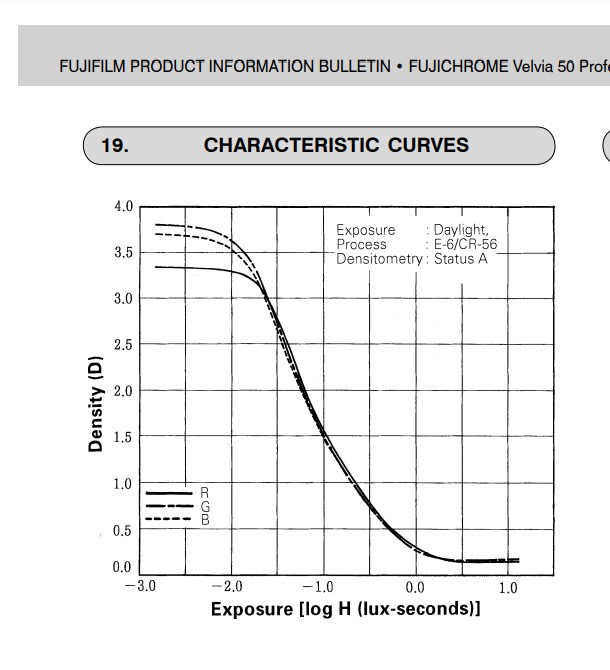

This appears to be a home-calculated chart. Can I use the charts provided by the film manufacturers on their film specification sheets?
Here's the product information bulletin for Velvia 50. See page 8 for curves. How would I interpret them to figure stops of dynamic range?
"Dynamic Range" and "clipping" are the wrong terms but I get what you're asking for.
The characteristic curve on the Velvia data sheet (fig. 19 on page 8) and assuming that the units on the horizontal axis are Log10 , it looks like the useful exposure range of velvia is around five stops.
This is the range along the horizontal axis (the exposure axis) over which the curve is approximately a straight line.
The characteristic curve on the Velvia (fig. 19 on page 8) and assuming that the units on the horizontal axis are Log10 , it looks like the useful exposure range of velvia is around five stops.

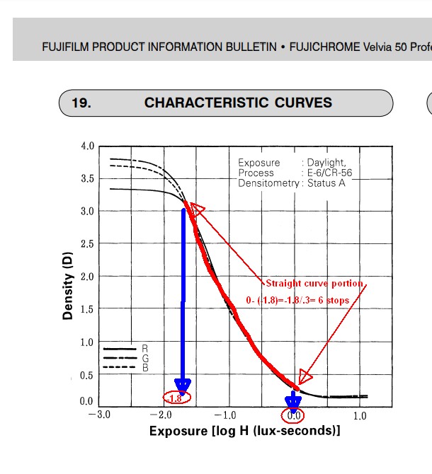

@Alan Edward Klein , five stops is a very rough, eye-ball approximation.
I'm not sure whether you are you challenging the estimate or if you are asking how did I come up with that estimate. Here's how to estimate the useful exposure range...
The useful range of exposures is that range of exposures which correspond to the straight line portion of the H-D curve. So estimating the useful range of exposure is a simple matter of deciding what section of the curve is roughly a straight line and then looking at the horizontal axis to figure the extent, or range of that straight line part.
I guess the 'trick' is to understand that the horizontal axis is log10() - So, a one unit change represents ten times change in exposure and a change of 0.3 along the horizontal axis represents doubling exposure, aka, one stop.
In the example given, the straight line part looks to me to roughly extend from 0.0 to a little past -1.5 - which is a range of roughly 1.5 and dividing 1.5 by 0.3, I get five stops...as a rough and conservative approximation. It might actually be closer six stops (from 0.0 to -1.8) .

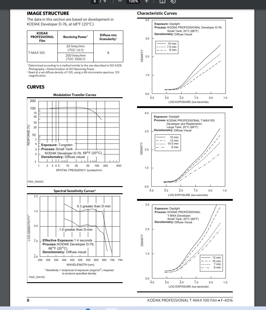

A typical characteristic curve won't show the entire range, because they are usually made with a 21 step wedge with 1/2 stops between the steps. Modern B&W films (1980s on) will exceed that. Also, the dense area that is missing (shoulder) would be the clear area of the step wedge, and the sensitometer only will give out a limited amount of light, so the sensitometer intensity would need to be increased to see the shoulder.
Say for example T-max 400, which might have 14 stops, I'd have to increase the sensitometer exposure by 32 times (4 stops) for the second overlapping step exposure to construct an entire curve showing both the toe and the shoulder.
I guess the 'trick' is to understand that the horizontal axis is log10H - So, a change of 0.3 along the horizontal axis represents doubling exposure, aka, one stop.

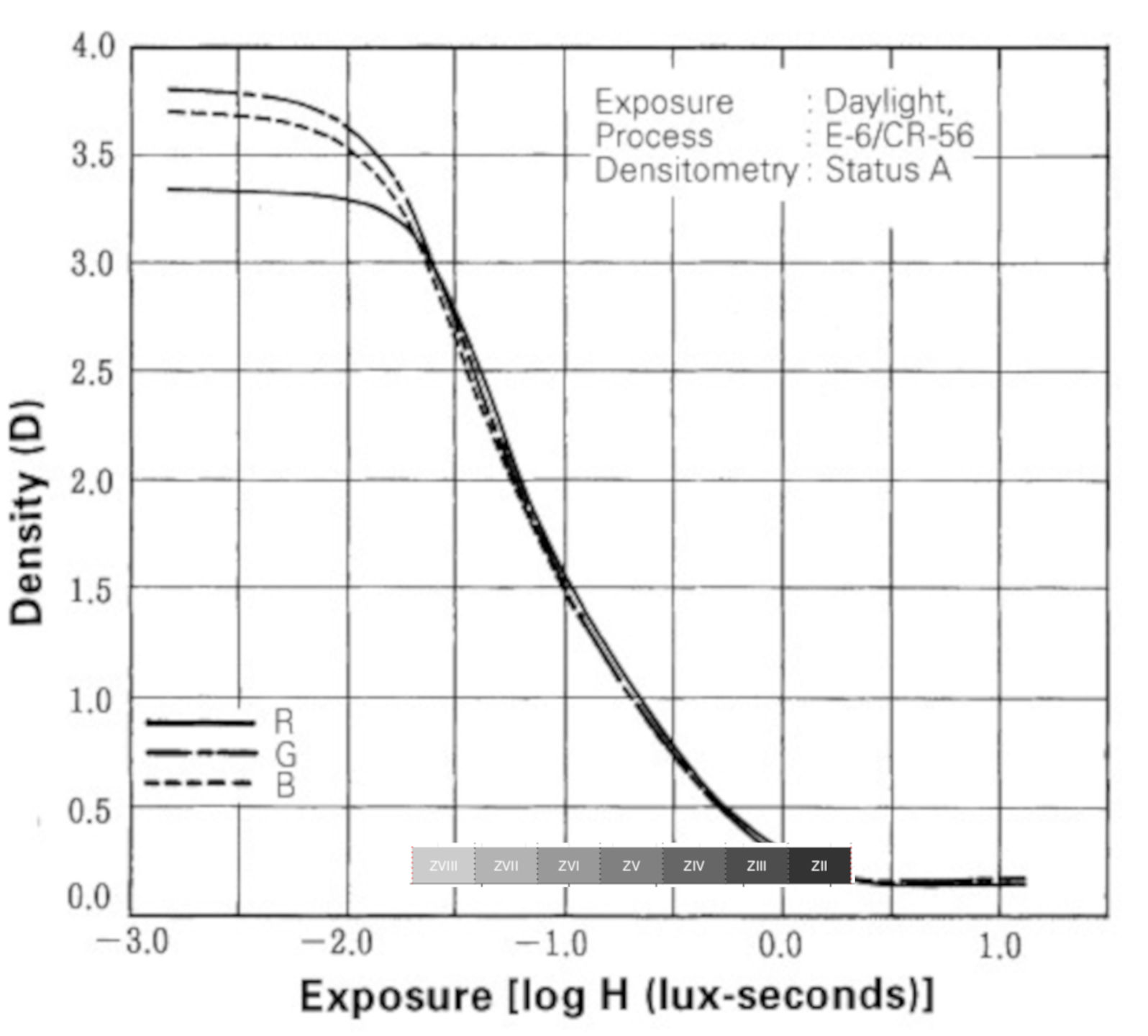

No Brad, no challenge. I was asking a straight question so I can figure it out for other films as well.
So here's my explanation of your post.
1. Is the graph below your explanation?
2. Is there a way to determine stops each side of 18% gray average or do we just assume it's equal both sides of 18% or +3 stops and - 3 stops?
3. Why .3 per stop? Is that the same for all other curves on their film bulletin sheets?
Alan, I think you've got it! I'll answer your questions below....
1. Yes, The graph you marked up demonstrates what I was trying to say.
2. Short answer. I don't know for sure. It makes sense to me that a "correct" and "useful" light meter reading results in camera settings that place the actual exposure roughly in the middle of the straight line portion of the curve - leaving, in this example 3 stops of latitude on either side. Of course, it depends upon how you meter the scene! This is the real trick, choosing camera settings that place the actual exposure in the desired place along the horizontal axis. This is (one place) where the photographer comes in. This is roughly what Zone system practitioners are talking about when they say "place the shadows in Zone II." You see, the photographer has freedom to choose where that is, to choose whether to give more exposure in order to get more or less details in the shadow areas for example.
3. This goes back to a time when scientists and engineers used a slide rule (and the CRC handbook) to calculate logarithms. The slide rule works with base 10 logarithms and log10(2) = 0.3. One stop is double or half - that's where the 2 comes from. What we really want is log2(2) = 1. They should have used base two logarithms but that would have necessitated using the slide rule to divide everything by log10(2) or looking up every thing in a table of base two logarithms and do interpolation! So, we're stuck with this goofy use of base 10 logarithm where it makes little sense....because, whereas calculating base ten logarithms with a standard slide rule is easy, calculating base two logarithms with a standard slide rule is tedious.

OK Thanks. So looking at Tmax 100, I see around 8-9 stops, depending on how one develops. Since I develop in a lab that uses D76 equivalent, which graph would you use? Which line on that graph?

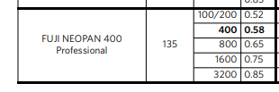

The lab I use develops normally unless you tell them to push or pull. So which curve would you use assuming D76 normally (or XTOL normally in another lab I use.)
I was once brought in to consult with the Herb Ritts team. Their printer had recently begun having difficulties. It became a blame game between her and the shooting crew. I made sensitometric exposures and had the three labs they regularly use process them normally. Two of the labs had good processing, but the lab they had currently been used had +2 development for what they called Normal. You want to know what the lab is really giving you. You need to test.
Kodak did a survey of a large number of labs. They had each lab process two rolls each of five different films. One set was to be developed Normal, and the other +2. Here is the results from one of the labs. Even if they had determined CIs specific for their lab's printing, their processing between the different films isn't to a consistent CI. This is the case with most labs.
Don't attempt to use the published curves, there're not printed with enough information to properly read them. If you want a starting point, look to the processing data sheets. Kodak gives the CI values for the processing times.
Apparently, they went back to CI 0.56 as Normal except with other manufacturer's films which remain at CI 0.58. The difference between the two gives me the impression Kodak never bothered to retest other manufacturer's films. Anyway, Kodak uses a Grade 2 paper printed on a diffusion enlarger for an LER of 1.05. They use a log subject Luminance range of 2.20 (7 1/3 stops) and a flare factor of ~0.30 (one stop). 0.34 works better mathematically. Rise over Run.
1.05 / (2.20 - 0.34) = 0.56
Under Dick Dickerson Kodak used CI 0.58 which is the same printing and Luminance conditions but with a slightly higher flare factor 0.40.
