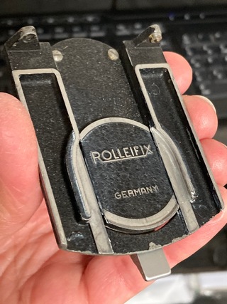

The bottom plate of the Rolleis is not built like a tank. This was recognized by massrs Franke&Hidecke who offered an auxiliary bottom plate that distributes the stress.

Yes, yes. I use the mounting plate and carry the camera only by the straps. Since the SLRs have been brought up, the vertical ones, like the Kowa, are easier to use from the hand than the horizontal ones, like the Hasselblad. Horses for courses.
