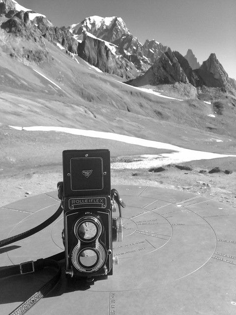

My 'go to' camera for trips where I want to be light enough, or when I do not know what to expect (Business trips in unknown places , that kind of trips) is the Rolleiflex.
No sorties about how it works, nonanalysis paralysis about which lens to take, etc...
My bare minimum setup (camera, filtres, meter, a few films) is compatible with a Nova Micro bag.
