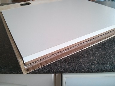

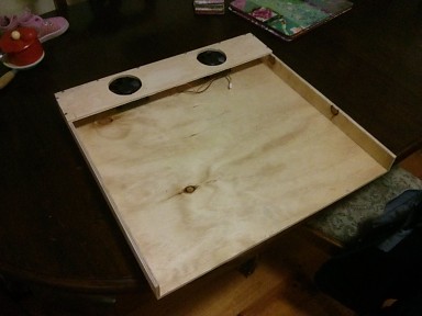

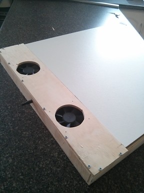

Well, I bought some corrugated cardboard (removalist boxes!) and A2 blotting paper this week. I've got some 12mm ply sitting in the shed (same as what I made the film dryer with) so if it's clear this weekend, there might be a quick bout of sawing and screwing. I might look for a cheap fan-heater tomorrow, otherwise I've got some spare 12V computer fans that would serve I think. Decisions: do I make it to fit 16x20" (my usual max print size) or 20x24"? I may have recently scored a 20x24 easel but the outer dimensions would make the dryer a real pain to store.
polyglot
Jun 12, 2009
3,467
South Australia
I wussed out and built it for 16x20", since that's the largest paper and easel that I own. Construction is 8mm plywood, unvarnished and screwed together; weight-board is a 15mm laminated chipboard. Fans are 2x80mm 12V, with a 7812 (linear regulator) dead-bugged on the back of the socket because the plugpack I dug up produces more like 16V and the fans really howl at that voltage. Plenty of air coming out the front of the cardboard, nice and uniform across the width of the dryer.
I haven't actually dried anything with it yet, maybe I'll experiment with some FB and Selenium this weekend.
