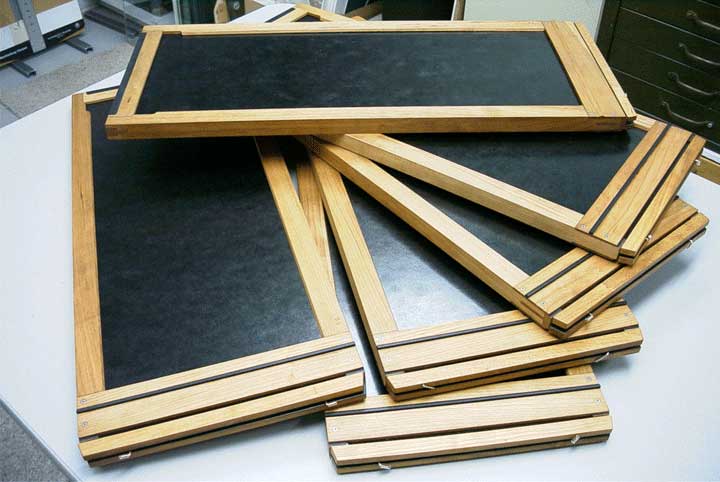

I made a set of screens, I think any plastic windowscreen material would be fine. Actually just made them up like screens. Cost a fortune though, I think you could get them from a professional glazier for less than I made them from local hardware store materials.
The screens just sit in a frame of fingers that holds them out...
I place my prints face-up because I want NO screen pattern, a phobia of mine. As soon as I put the prints on the screen I lean them vertically for a few minutes to drain the majority of water off. Leaves a few rivulets of droplets but no real water puddles... Then I set them in the fingers and let them dry a day or two.
I have a dry mount press that I use to flatten them after.
Nylon/plastic window screens should work. I have a set of Zone VI screens and that is what they are made from. I have a rack they mount in (it holds 15) that I could send you a picture of if you want. The rack mounts to the wall and has a foot print of one screen. I would require some amount of wood working skills and tools to construct. Bill Barber

It can be pretty simple, the main multiplier being the number and size of screens:

Some of my screens are sash-window inserts from the hardware store (California), separated into two parts. These units normally have two sliding screen sections to accommodate different widow widths. I have a couple of Kostiner ones, and a few others that I picked up used locally.
I have a small darkroom, so I put in a couple of slats just under the ceiling and above the sink. The screens sit on that. Prints are surface wiped with an old Paterson print wiper, and dried face up. I can work while prints are drying, but I usually do it overnight.
For material all you need is fiberglass screen from a hardware store.
Also materials for making custom sized frames.
I found this at Home Depot. It was supposed to take sliding drawers, but instead I made up some screen to put in the slots.

Well, it was in my link.:whistling: Standard fiberglass. Any screen maker. The vaunted and unnecessarily expensive ZVI screens are just those – nothing more exotic.
