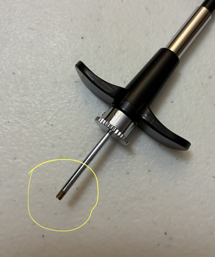

Every cable I have purchased has broken in one of three predictable ways despite gentle use.
1. The flat disk you press down on with your thumb screws off and disappears.
2. The plastic tubing wears out and fails to connect to either end piece.
3. The inner wire wears out.
I generally walk around with two cables because of this. Do you know of a company that makes an 'indestructible' cable? I am willing to spend more for the convenience.

When you get a new one, you can avoid this by doing three things at almost no cost:
  1. Use Lok-Tite or similar product inside the button threads to permanently affix it to the plunger. (Wear nitrile gloves, that stuff is gooey.)
  2. Tighten the cord to the plunger assembly. Then use a length of heat shrink tubing running from the center of the silver barrel shown above to about 1 inch down the black cable. Heat with a heat gun or hair dryer until fully shrunk. Not too close or too hot or you'll also melt the cable plastic.
  3. Do the same thing at the other end of the cable to cover the joint where the cable meets the, end again about 1" up. Take care to not cover it so far down to the end that you cannot turn the knurled surface that lets you thread it into the camera.
Two cables in constant use for more than 30 years. Minolta (white one) and Linhof.
The Loc-tite "red", 272, made for metal mechanical joining is expensive but available in tiny tubes and considered permanent strong, needing 500⁰f heat to break the bond.
Buy a pack of needle thin soft plastic ripple tips that deliver miniscule amounts of superglue so you don't end up massively flooding the thread and save your glue for other projects.
There are other thread locks but none that I know of are as strong as the loc-tite red stuff.

A quick cheap fix for light weight screws is to use a dab of nail varnish instead of Loc-Tite on the thread.
I use Sally Henson "Clear, Hard as Nails" nail varnish when tying fishing fly heads.
Also use it on spectacle screws when they work loose. The good thing is it is reversible with a spot of nail varnish remover.

Why not glue the button head on with superglue rather than being 'polite' and using nail varnish, I mean you've got to tell me who wants to remove it in the future?
Good thinking.
I wasn't clear enough.
I was referring to the spectacle screws being removable at a later date.
I did have two old cable releases years ago having buttons that unscrewed. This enabled the push wire and end plunger to be pulled out altogether. A quick wipe, and a spot of oil would free everything off when any grit got into them.
