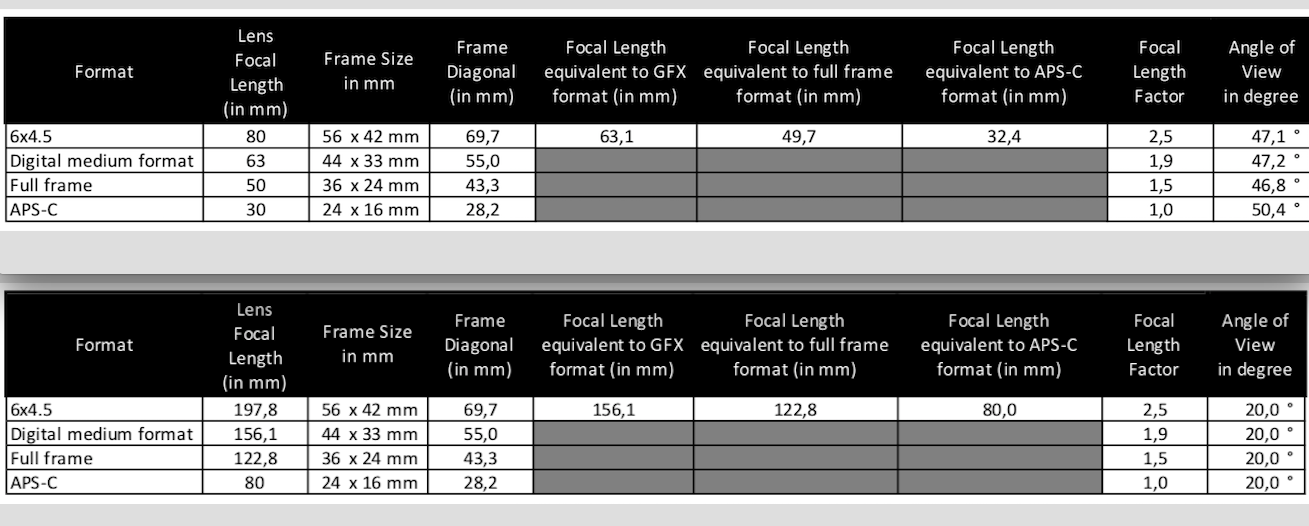

The angle of view of a lens is the only parameter that makes it possible to determine the equivalent focal length of the system with different sensor or frame sizes.
One can use the first three parameters you listed for that purpose: the short side, the long side, or the diagonal of each frame.
I use the diagonal of the frame because my final images vary greatly (from 84x73mm to 108x53mm), so using either the short or long side would not be accurate.
See below two Excel tables I created on the topic of our discussion. The first compares standard prime lenses of four systems. The second compares the Mamiya 645 80mm lens adapted to the APS-C system with others in the sense of its effectiveness.
A spreadsheet in this form is nothing but tabulated assertions. It doesn't gain truth by being nicely presented. What are the workings behind it, and what specs are you referring to in it?
{Emphasis added}
This is incorrect, because differing aspect ratios force users to prioritize different dimensions, depending on the intended use.
The landscape photographer may be most interested in the long dimension, and therefore use a table of equivalencies based on that.
A wedding photographer may, on balance, care more about the short dimension, so will need a table of equivalencies based on that.
And those two tables will differ, when the choices on the table offer different aspect ratios.
You can always state which assumption you are relying upon - which of the four characteristics you are basing your calculation of equivalencies on - when you share the results of your calculations. That will allow others to determine whether those calculations meet their needs.
