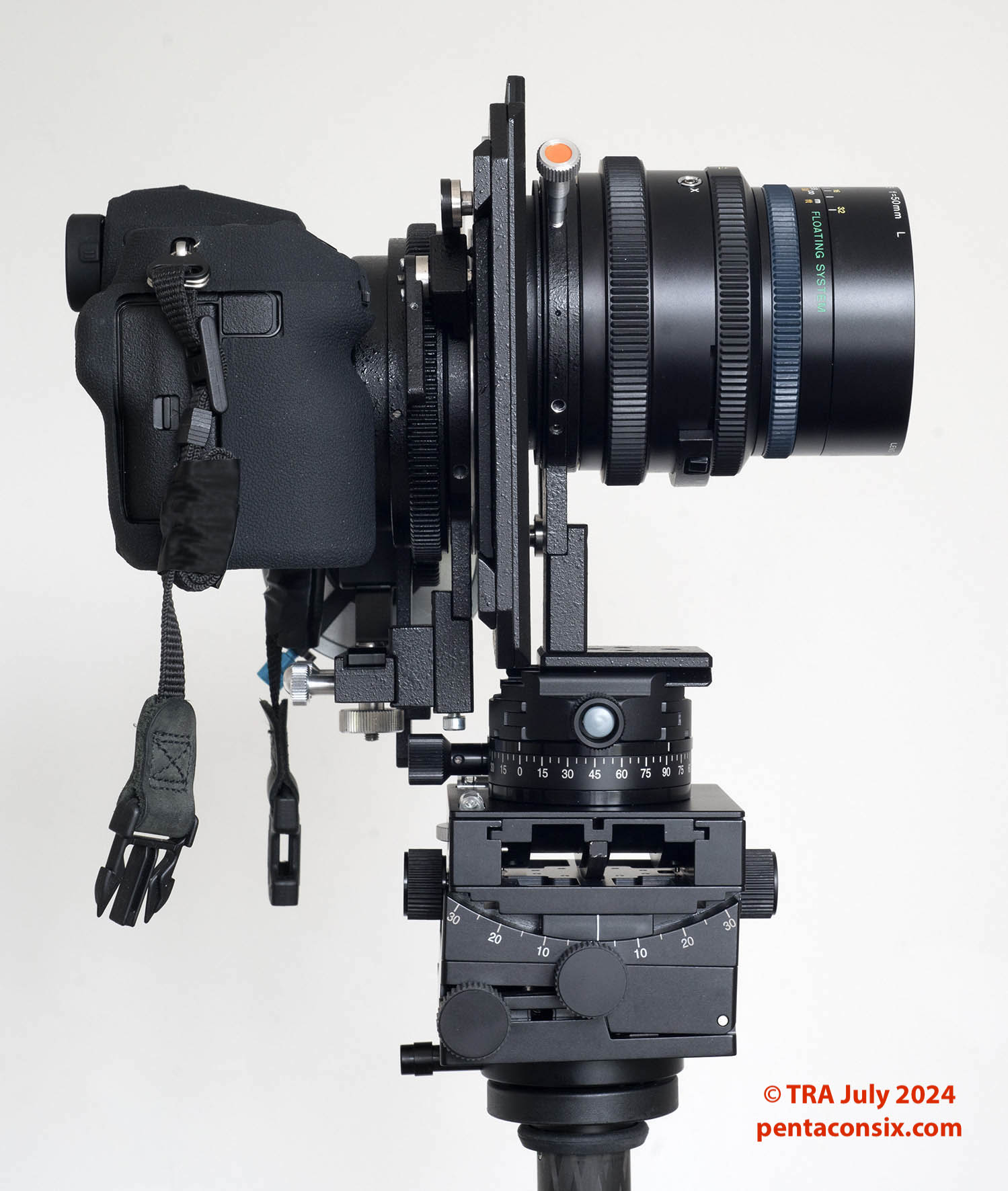

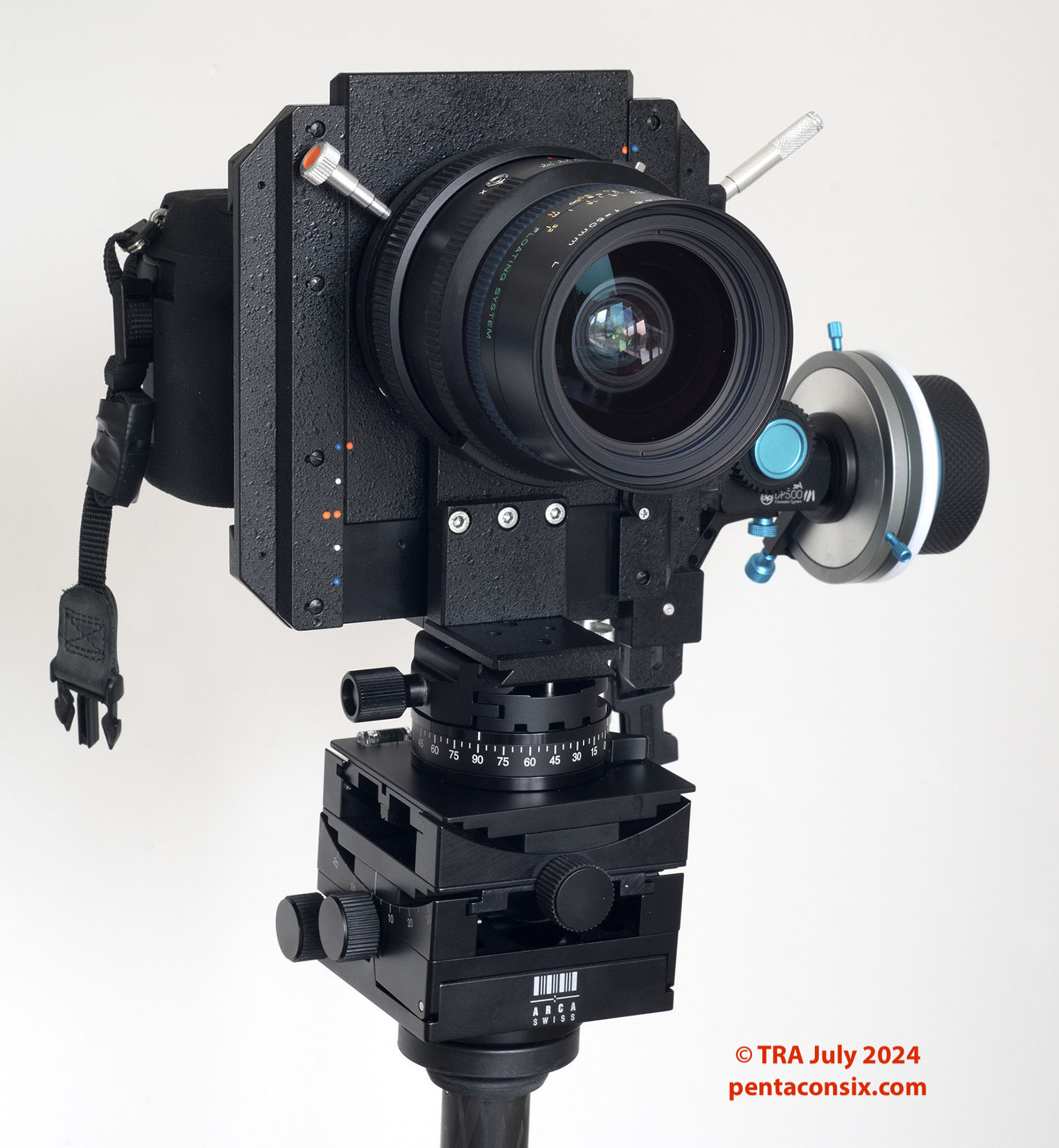

There is Hartblei adapter for Mamiya 67 lenses (soon will be also available for Hasselblad lenses) allowing 20mm shift in both X and Y axis.
So if I stitch/overlay images shot fully shifted to achieve the edges of image circle, the Mamiya ULD 50mm lens will correspond to 25mm lens of GFX system.
Trevor Allin, the owner of Pentaconsix. com has such an adapter. Here is his test:
