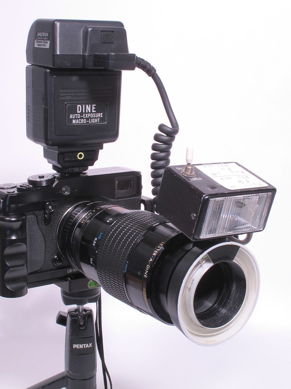

Recently, I was given a ring light and a Lester A. Dine macro lens by a colleague. The last time I used a ring light was decades ago (1970s) when I was working for a medical college. I primarily used the ring light to capture shadow-free photos of surgery and/or pathology in the body cavities (oral, abdominal, and thoracic).
Ring Light by Narsuitus, on Flickr
