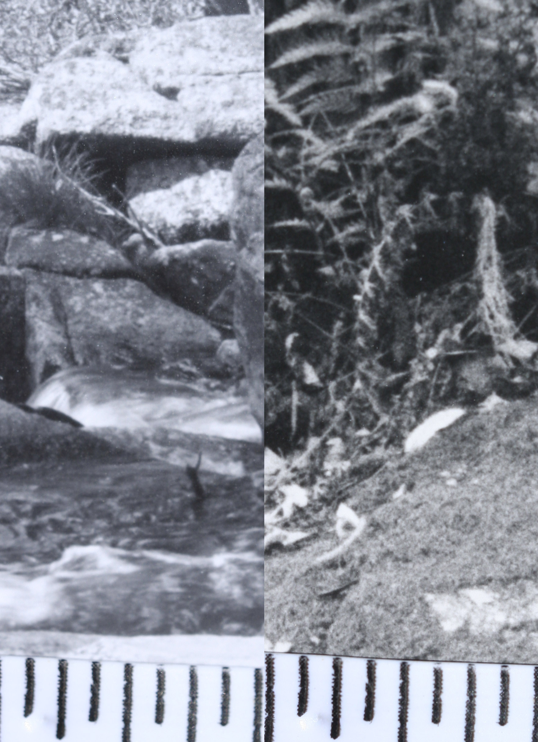

Here is a side by side comparison of the difference, close-up, between 11x14 prints (which I consider "small"), 35mm Panatomic-X and 4x5 TMY-2.
I can see the difference in the prints viewed at normal distance. But you can see in the close-up that the resolution and sharpness are comparable.

That's an interesting comparison. Thanks.
You're Welcome and thanks for appreciating it.
I like to think that nature photography is so well simulated by the grain of 35mm film, that you can get away with less "true" resolution. The actual moss texture blends into the texture of the film so well that it is impossible to tell where real detail fades and grain texture takes its place.
So the 35mm seems to carry the same amount of detail as 4x5
For that part of the illusion to work, you need a good enlarging lens and need to have enlarger carefully aligned and print with your grain sharp.

Mr Burk , I find the two photos leave me with more questions than answers .They are dissimilar enough that I can't see
any real reference points . One point worth remembering , making a good print from 35mm is an act of God , where the
same from 6x9 or 4x5 is quite literally a breeze . It may sound harsh , but the numerous shades of grey in an 11x14 print
from the larger formats become noticeable in their absence with a 35mm neg . Peter
Bill Burk
Feb 9, 2010
9,479
I agree. I made the comparison mostly to answer my own curiosity because the two prints satisfied me so thoroughly that I wanted to see what it was. Every time I look at them I think up a different explanation. And I always conclude it isn't resolution that makes the 4x5 better.
