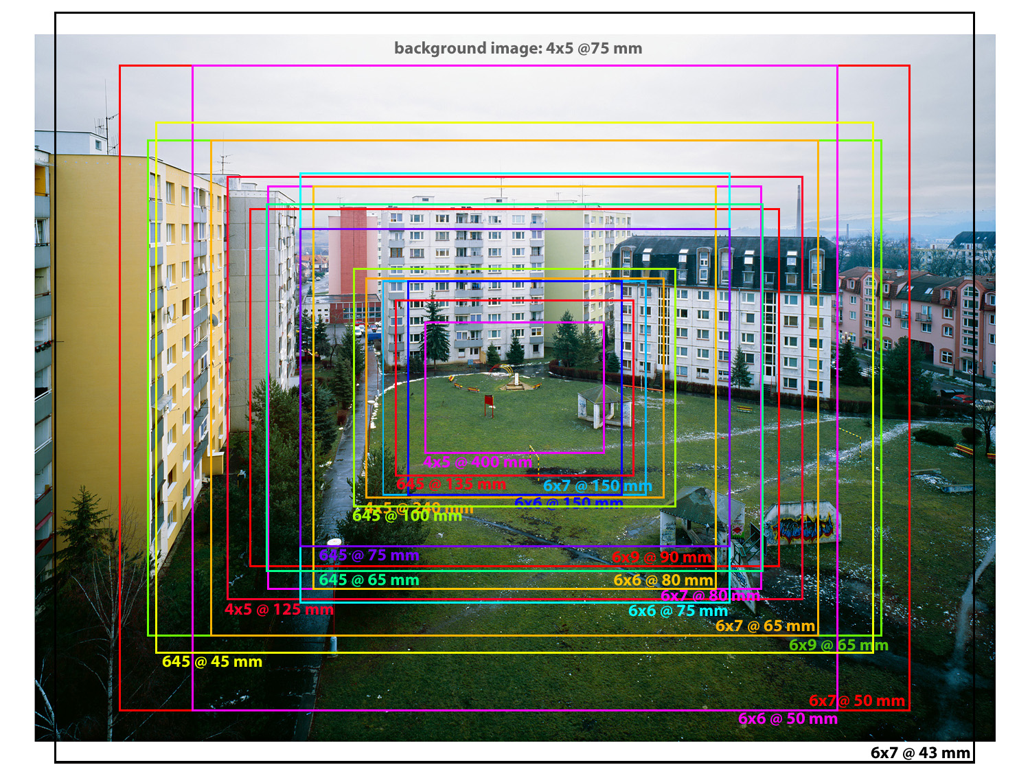

I can't remember where I got this, but there was another one that compared 35mm with some other formats.
