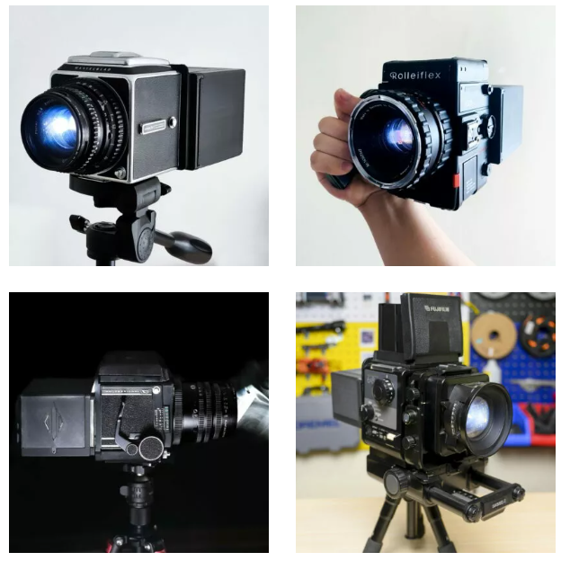

Here's a couple of images from the site:
Shows how it mounts to the back of many MF cameras to convert them to a projector.
Ah, i see. Now this of course does look interesting as this box ain`t big and seems to convert a camera into a projector easily... but i cannot see any opening for the fan. LEDs have a lot of advantages but also one or two disadvantages, one being that they shouldn`t get too warm. If a LED exceeds 100° Celcius (there is some variance, also depending on the manufacturer), it either will break down or will loose light-output and lifespan - they say significantly. It shall not exceed 100° Celcius by just one degree - not even for a second. Apparently its that bad, so LEDs need to be cooled sufficiently. Also for optimum performance the chip needs to be like 60° celcius, at for example 80° there will be a loss in light output.
LED chips up to 10W can be cooled passive by a heat sink, above 10W you need a (bigger) sink and a fan.
Now this box seems a little small for a 30W LED including heat sink and fan and i cannot see air inlets -outlets you`d need for a 30W LED.
So question for me was how good this works - apparently it does work but will the LED produce maximum light output, or is it getting too warm; how long can you project or is there a time limit as the LED would reach 100° celcius, is this battery driven as i cannot see any power cord - making me wonder what would happen to the battery if its being heat up by the LED, respectively the battery heating up the LED which was also possible, how film flatness is achieved as you wanted to use the camera lens wide open, so you need good flatness, what about the camera internals if the LED goes up to 60° celcius or 80° because cooling is too low...
...it looks nice at a first glance, but i had some doubts.
