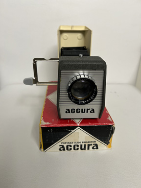

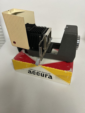

I know you are considering a dys projector. I have had this for over fifty years so it might give you some ideas.
