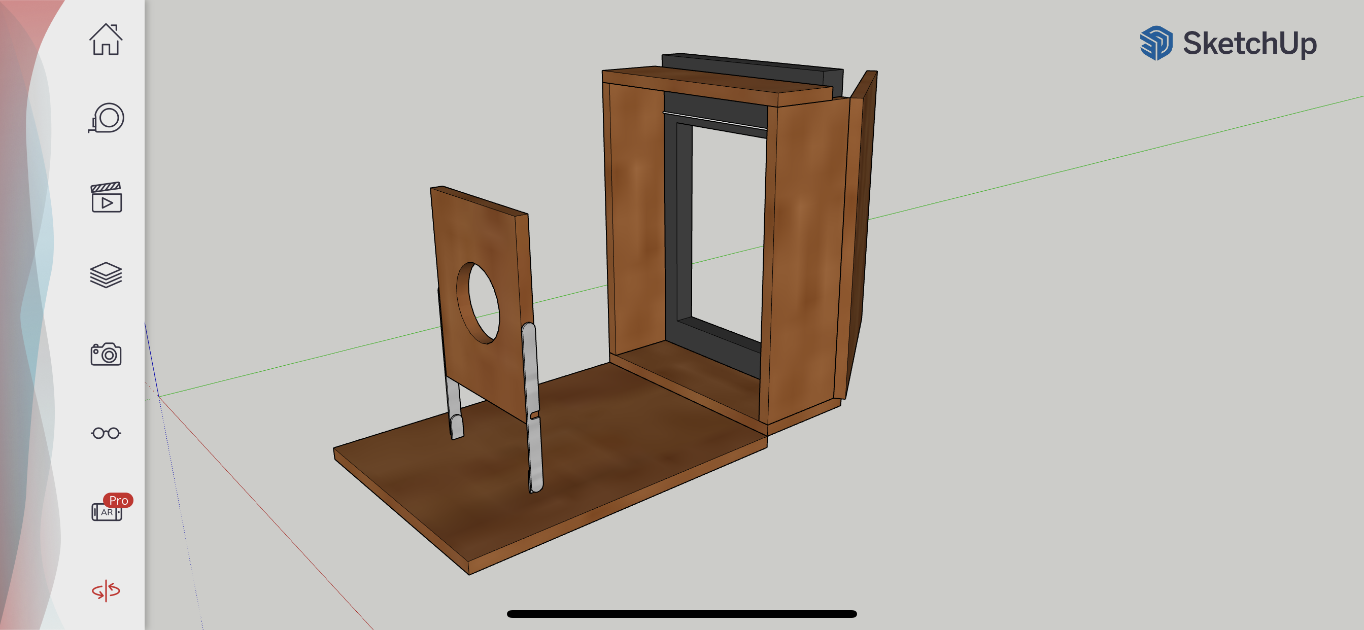

I guess I should clarify so I don't sound like a total bafoon, like always.
I can get the basic shapes figured out fairly easily. It's the compound mitered angles that I have issues with.
I've gotten my design this far, and it's to the mm. The back of the lens board is exactly 156mm from the film plane. Might not be as accurate once I put saw to wood. I used measurements from this thread and built the film holder first. And then built around it. I'm thinking materials will be 1/4" birch ply. I wish I could figure out how to attach the front to the back with bellows so that it's collapsable.
I think I'm going to use some matboard pieces and do this for bellows.

@ChristopherCoy Unless you have a limitation on the dimensions of your wood, it would surely be simpler to make a plain box rather than that "square cone" shape. That way, all your wood pieces are rectangles (with rabbet joints, lap joints, or whatever) and all your join angles are right angles.
I'll admit, even though I started to learn trigonometry in 8th grade (1972, via slide rule), when you start to get angles in three dimensions the trig can get complex enough to make it a PITA.
...when you start to get angles in three dimensions the trig can get complex enough to make it a PITA.

I think I’ve got a plan for a collapsible bellows 4x5. I can’t explain how I’m going to do it, but I have a very clear idea.
Okay, reinventing the wheel is legit for a hobby. :wink:
You'll need some way to slide the front standard back into the body or detach the lens board from the standard in order to have the camera fold. Might be able to detach the bellows and fold the standard down onto the bed (as it seems you're planning, based on the drawing) -- that would cause problems with a lens, but might be okay for a manual-shutter pinhole.
As and incessant diddler I understand that hand-making projects is extremely rewarding. I have built muzzle loaders, electronic gear, musical instruments and etc.
However, I have discovered that when working in a new endeavor, it is often better to proto-type it, rather than jump to the completed project.
I can almost guarantee that once you start using your pinhole camera you will wish to try other pinholes, focal lengths, film sizes and etc. simply put; my suggestion is to make it as adjustable as possible. Once you know what you like, then you can complete the fine art master piece.
