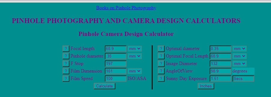

Why don't you use calculator?
https://www.mrpinhole.com/calcpinh.php
4x5" needs 81.3mm image circle radius (162 diameter).
You need to use 0.389mm pinhole with 68.9mm focal length to cover 4x5".
According to that calculator, that focal length only gives me a 132mm image diameter, which means vignetting on the corners.
Although the "design wizard" seems to simplfy it to a single mouse click.
You are right. That calculator isn't error-free it seems.. But glad that wizard helped you finding correct values!

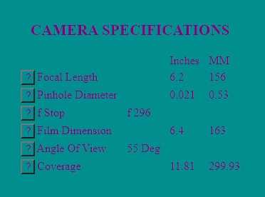

I think the wizard is giving some strange solutions.. You don't need 299mm coverage for 4x5" ?
I re-calculated that 85mm / 0.389mm should give 163mm coverage and be enough for 4x5" .. Harman Titan's 72mm focal length is too shallow for 4x5"?

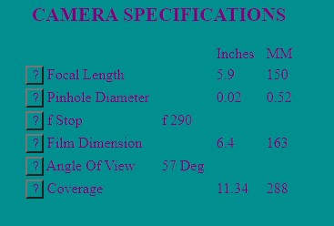

Just to check things, I did it backwards. I googled (since I don't shoot LF) "normal focal length for large format" and used the result of 150mm. Then I went to the camera design wizard and chose "focal length", entered the 150mm and then the film dimensions of 4x5". It's still coming up with 288mm of coverage.

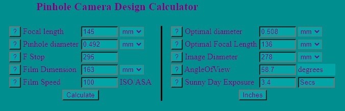

hunh... focal length of 145mm with a pinhole of .5mm give's me a true F295.
Which is not quite optimal, according to the calculator.
Try .528 diameter and a focal length of 156 mm.

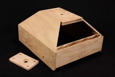

Did one ten years ago (good grief it's been THAT long?!!! :surprised:) 4x5 Pinhole Mostly made from scraps around the workshop. Homemade 0.30 mm pinhole at 62 mm pinhole to film distance (fairly wide), approx f/210. It works quite well -- but then a few years later I incorporated some of the same design ideas at 8x10.

Nicely done! I wish I had the ability to figure out angles, and the tools to make cuts like these.
Something like that can be solved graphically (you know the front plate dimensions and the box size, which gives you the front and rear edges of the angle pieces; the others will come out of Pythagorean theorem, which is pretty basic math). Or just cut the angle pieces from scrap card stock, held together with tape for mocking up, and only transfer to wood once you have it fitting.
...the others will come out of Pythagorean theorem, which is pretty basic math).
Have I ever mentioned that I graduated HS with a 2.1 GPA because I was taking art II, III, IV, and Advanced Photography all in the same year? My version of basic math is "if Johnny has three apples and drops one, how many does have?"
Got a smart phone? Download a calculator app (I use one that emulates an HP-41CX). Squares and square roots are all that's needed, but few non-scientific calculators make both easy.
Admittedly, I learned to do much of this stuff on a slide rule, before calculators were either common or affordable -- but really, Pythagorean formula for a right triangle is easy enough they teach it in fourth grade (or did when I was that age).
Actually, I passed geometry with a 98. It was the only class that came naturally to me. I remember one time I was sleeping in class. I had my head down on my desk and I was apparently snoring. The teacher, Mrs. Vestal, came by and slammed her book on my desk. She said "if you can answer the question, you can go back to sleep." I lifted my head up, read the question on the projector, answered "123xyz", and put my head down without missing a beat. I remember her saying "how'd you know that?", and being shocked that I was able to answer correctly.
The problem is that I can't remember any of the basics. Bout the only thing I remember is a right triangle. Maybe I should brush up on it a little and see what I remember.
