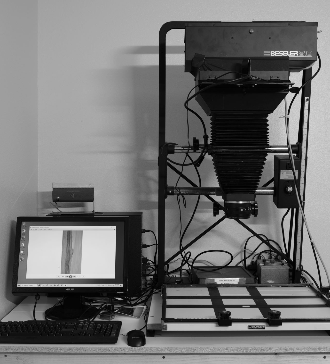

This is the current configuration of the enlarger, except that it has been moved into a dedicated darkroom.

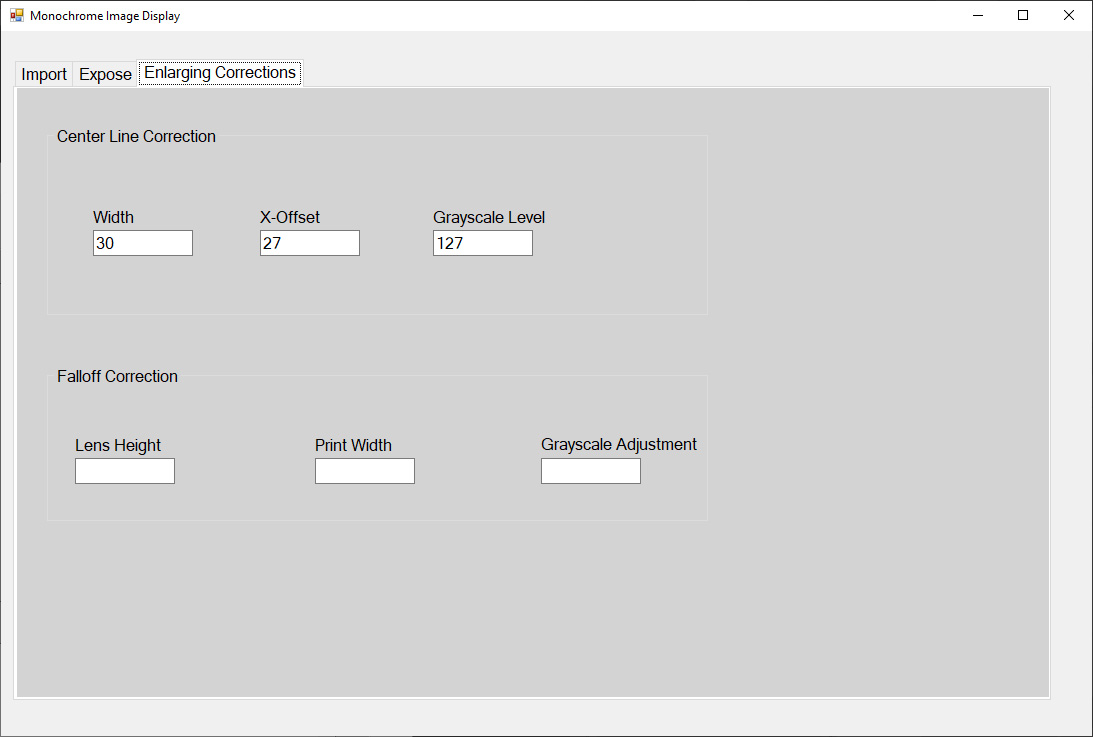

Some software updates,
Added a new screen for exposure corrections.
The first issue and most pressing is a artifact of the lcd screen manufacture. It is actually two grids sandwiched together between glass. There are no noticeable issues except if you have a clear sky in the middle a thin extremely faint bar is visible across the screen. The adjustment adds the correct level of grayscale to negate the issue. It's good thing that I added the 10/12 bit support because the adjustment is only 1/2 level of lcd grayscale, without it there would be the same bar except lighter instead of darker. The error correction removes it completely.
The second is a calculation that compensates for exposure falloff. I've started messing around with 8x20 panoramic prints (hat tip to Michael Smith) which reach all the way to the ends of the LCD and noticed quite a bit of falloff. It adds cos()4th correction, I am still working on a way to calibrate it.
Near future is adding grayscale lut support. It's annoying to have to reapply the contrast curve in photoshop if you want to change paper contrast curves or apply custom curves such a higher contrast version for large prints. Likewise adding the ability to invert. This way you can have a finished grayscale tiff and never need to mess around with it in pshop again.
Longer term would be a 'digital purity' mode that would accept monochrome raw files directly such as from Leica or Pentax and except for a gross levels adjustment to fit the contrast range allow you to print directly without modifying the image file. The pentax and leica 246 would be ideal since the output file fits directly on the lcd without any resize.... digital purity! Of course you can still burn and dodge to your heart's content.

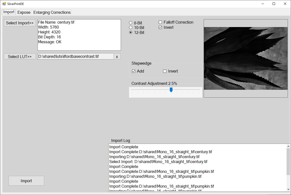

More software updates, added LUT support, invert, contrast adjustment and step wedge insert.
There is nothing worse than having a tray full of lith/developer and having to go back to the photoshop workstation.
The contrast adjustment actually works against the LUT and works proportionally -15% to 15%.
Coming soon I am going to add a log stamp on the bottom with all the enlarger parameters, time etc. also with a chemistry details. The same information will also go to an output file with a notes section.
It will be very tiny will have to get up close to read it.
I've been so busy with software and testing I haven't had much time to publish images of prints but I hope to soon...

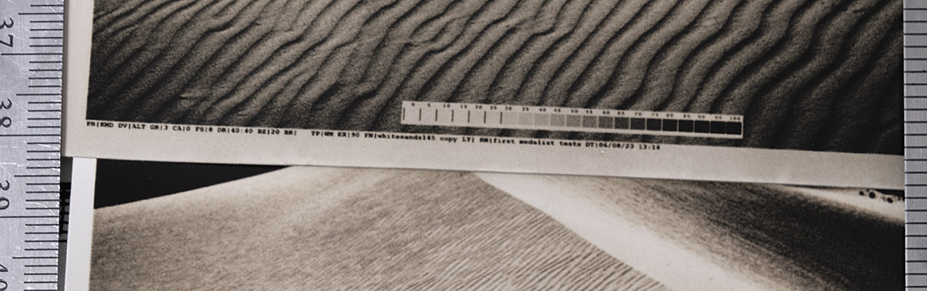

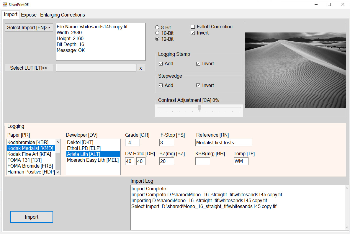

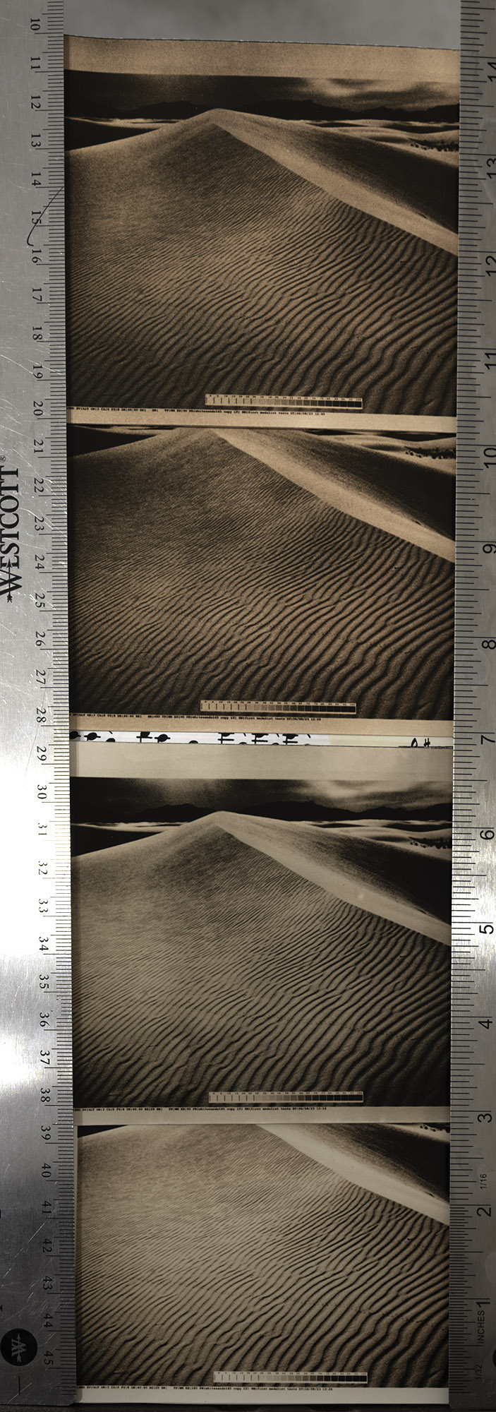

I got the logging working. Ive attached some pictures of a medalist(expired 1973) lith session. Top to bottom is nothing, 400mg of Kbr, and the last two with 20mg of bz.
The text is 16pixels high and need a magnifying glass to read it.
The logging helps a bunch with this, the prints change drastically when they dry so it is hard to remember which prints were what.
I'm thinking about including a lightweight database that stores the same information from the imprint and the prints could be stored in archival 4x6 picture boxes.
You could search the database and know what boxes to look in to review something you did in the past.
I would like to make it easier to generate luts and have been thinking of a way to do it without photoshop.
This lut wizard or whatever I call it will generate gradients that you photograph with some crop lines, it would be able to read the scanned/cropped image to generate luts.
I've got a bunch of polymax fine art I want to use but need to create luts for. I'm too lazy to do it again in photoshop.

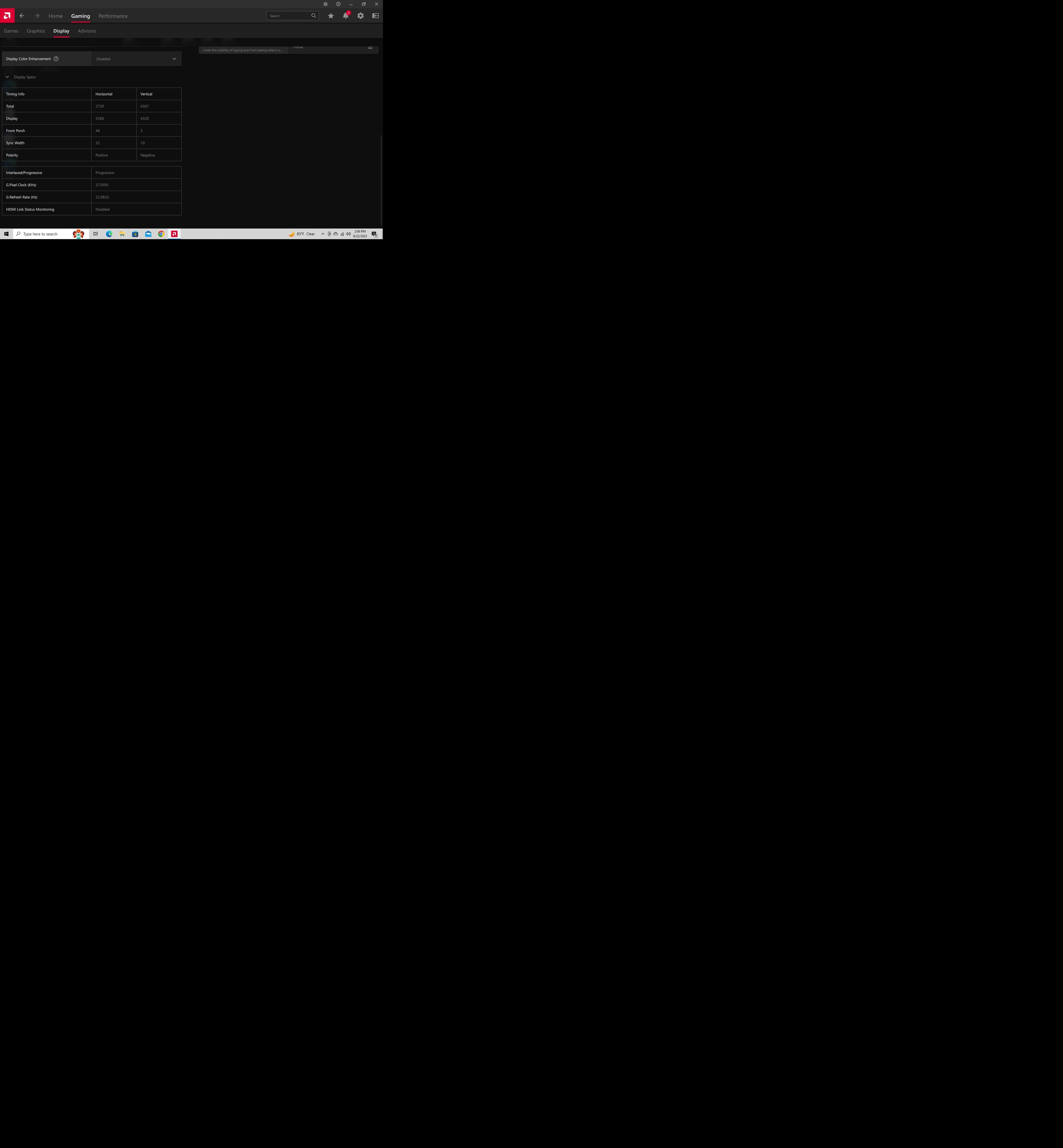

I have now the Elegoo display, Aliexpress HDMI-driver-card and Radeon RX 6400 but I cannot get the display to work. I'm running Ubuntu 20.04 with newest drivers installed.
The error I'm getting is "[drm:drm_add_edid_modes [drm]] *ERROR* Unknown HDMI VIC: 0" each time I plug the USB power on for the board.
I tried four different HDMI cables - I'm not sure if any of those were 2.1 - that might cause problem.
Any ideas @avandesande ? What tricks you needed to do for the driver settings etc?

I've attached custom settings, its a screen shot what I figured out for the Radeon. I'm not sure how much help I will be on a linux machine. Even if you get the display working you will still have to map the horizontal pixels into RGB values. I can supply a utility for doing it on Windows but I don't have anything for linux. Apparently there is a way to use a python script to do it in linux but I don't know where to get it or set it up. You could try the NanoDlp forums if you want to go this route.
"Map the horizontal pixels into RGB values" -> is this done on driver level? Or do you have written the utility?
I'm in the discussion with SUMAOPAI-seller and he said the display should work on RPi 4 too. Strange, as it shoudln't support HDMI 2.1 or 8K (I believe). This could open up possibility to use RPi as "server" for the display and control it from other interfaces - no need for computer + another display.
I will try with new cable and if that doesn't work, I will switch to Windows 10.

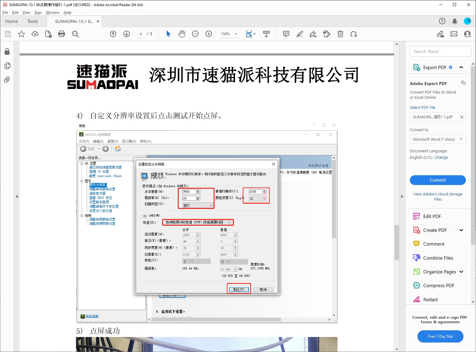

I just realized that the needed resolution at Windows is only 2560 x 4320 .. So it probably doesn't need 8K graphics card at all to get it working. That is why it works on Raspberry Pi too.
radiant
Aug 18, 2019
2,135
Europe
But yes, I've got the display working fine and managed to understand how the grayscale displaying works. Some memos:
- The display is 8-bit grayscale display. It can display 255 different shades of gray, no colors. It is not monochrome in that sense that it can actually draw different shades.
- Yes, the 8K display is running at 2560 x 4320 at the PC. But how in earth that is 8K then?
- The trick is that each RGB pixel is actually three pixels. The HDMI-display board uses this "trick" to "compress" the information. So, if you want to draw just thinnest line possible, then set one of R,G,B values to 255 and others to 0 and do this on each line at same position; then you have the "8K" thinnest line on screen.
- Raspberry Pi 4 (4GB) should be able to drive the display (as it is not "natively" 8K), SUMAOPAI is just RPi for production testing of the displays.
- SUMAOPAI has been really helpful and responsive. Altough the Aliexpress translation chat is a bit horrible, RGB and compression stuff lost in the translation.
- 12K displays (same form factor) is out, currently at 220 euros.
- 16K is coming out but that is the limit for the DPI and line width.
- 6.8" 9K is coming out, line width 0.018mm. We are getting close to film line resolving!

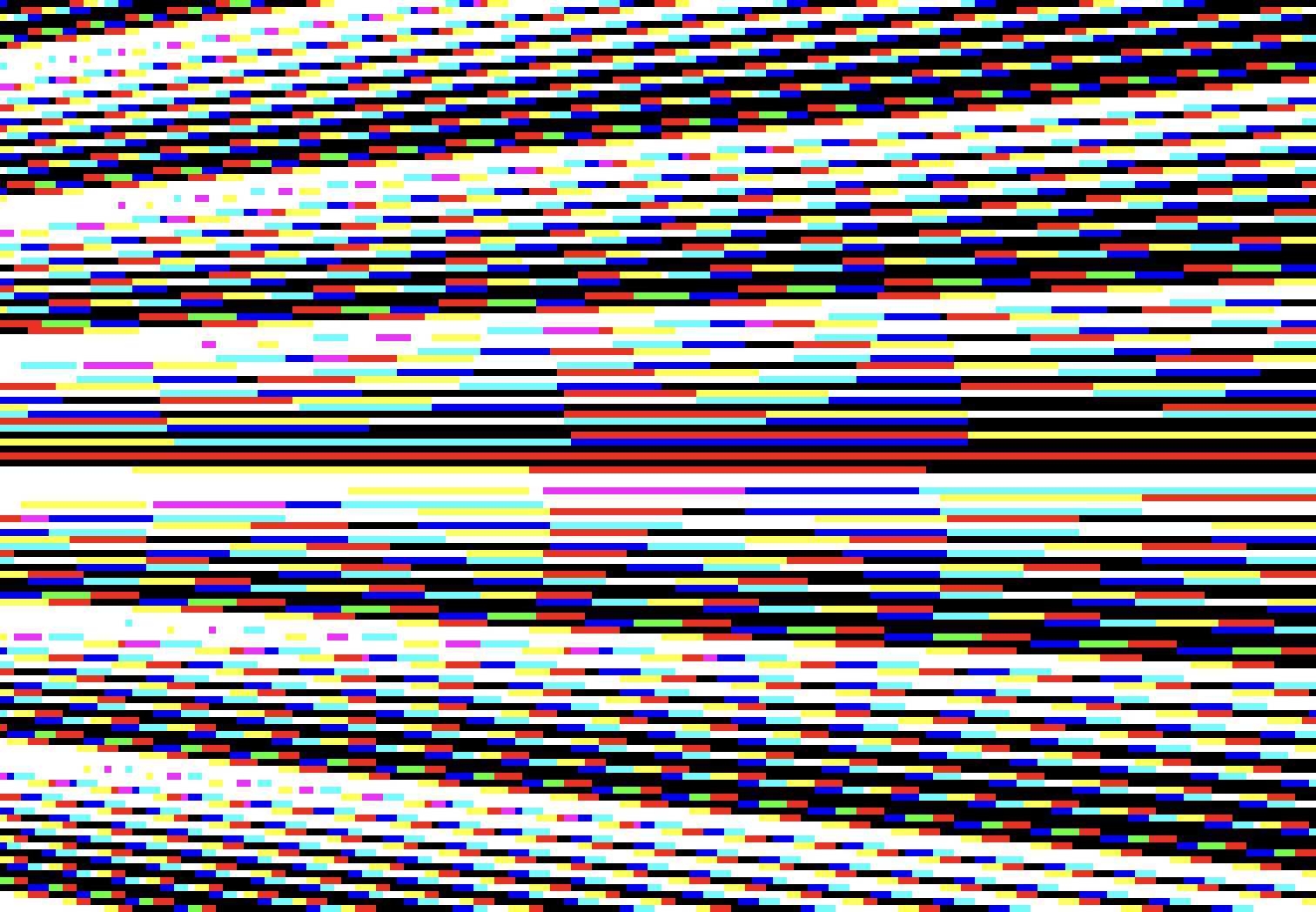

Attached is a very small part of my test image pattern which is meant to be printed B&W. Why there are colors? Read above :wink:
