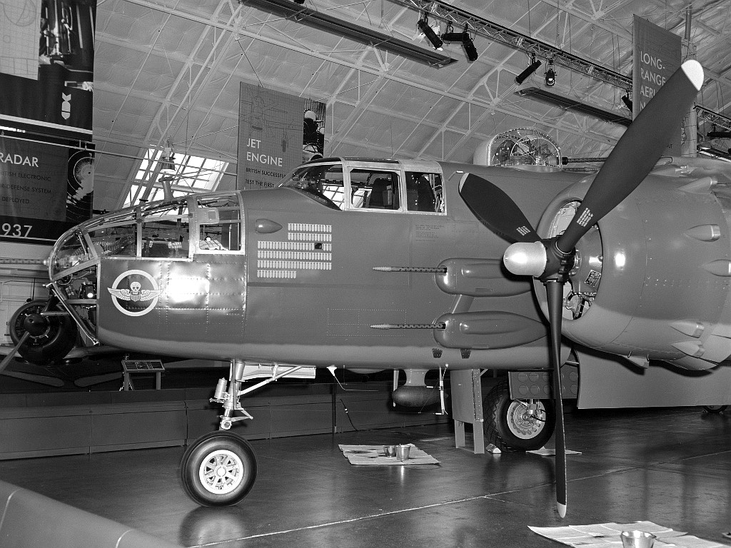

Surely, this group has taken thousands of similar photos, probably with the same setup, how sharp are your photos?
Posted by me previously, but worth a reprise to help answer your question with an example:
B-25J Mitchell medium bomber, Flying Heritage Collection, Everett, Washington
Pacemaker Crown Graphic 4x5 w/135mm f/4.7 Wollensak Optar
1/200 sec at f/16 at ~25-feet on HP5+, handheld using a single on-camera Press 25 flashbulb
Plane of focus on furthest tip of propeller using calibrated top-mounted rangefinder
Apologies for the hotspot...
Ken
Ken,
Cool. My son got to go for a ride in one of these (The Pacific Prowler) when he was about 12. He had three complaints:
1. The ride was too short.
2. They wouldn't let him fly it.
3. No ammo for the machine guns.
Probably the same complaints we'd all have.
Could you email me a hires copy of that shot? Timothy@stearmanpress.com.
Tim
