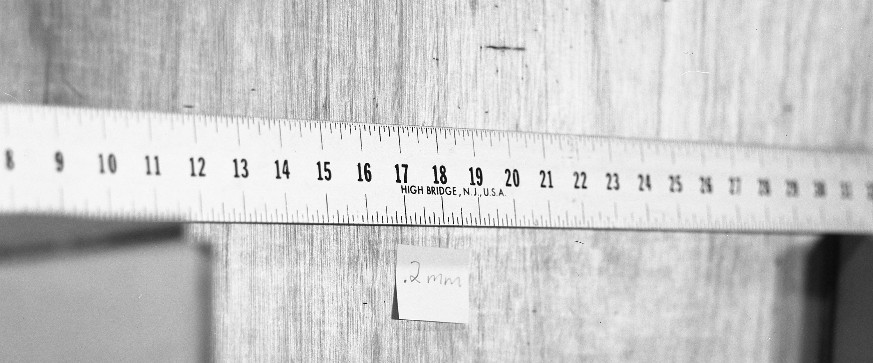

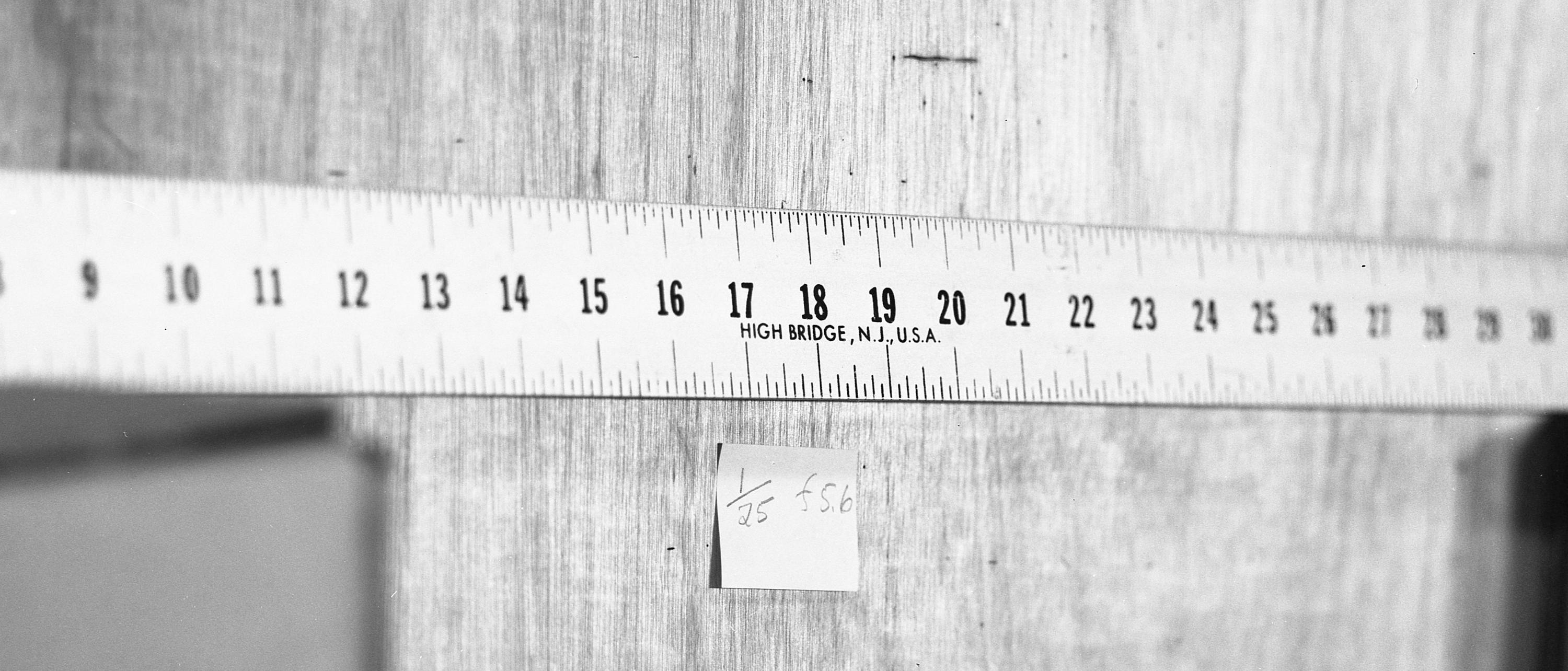

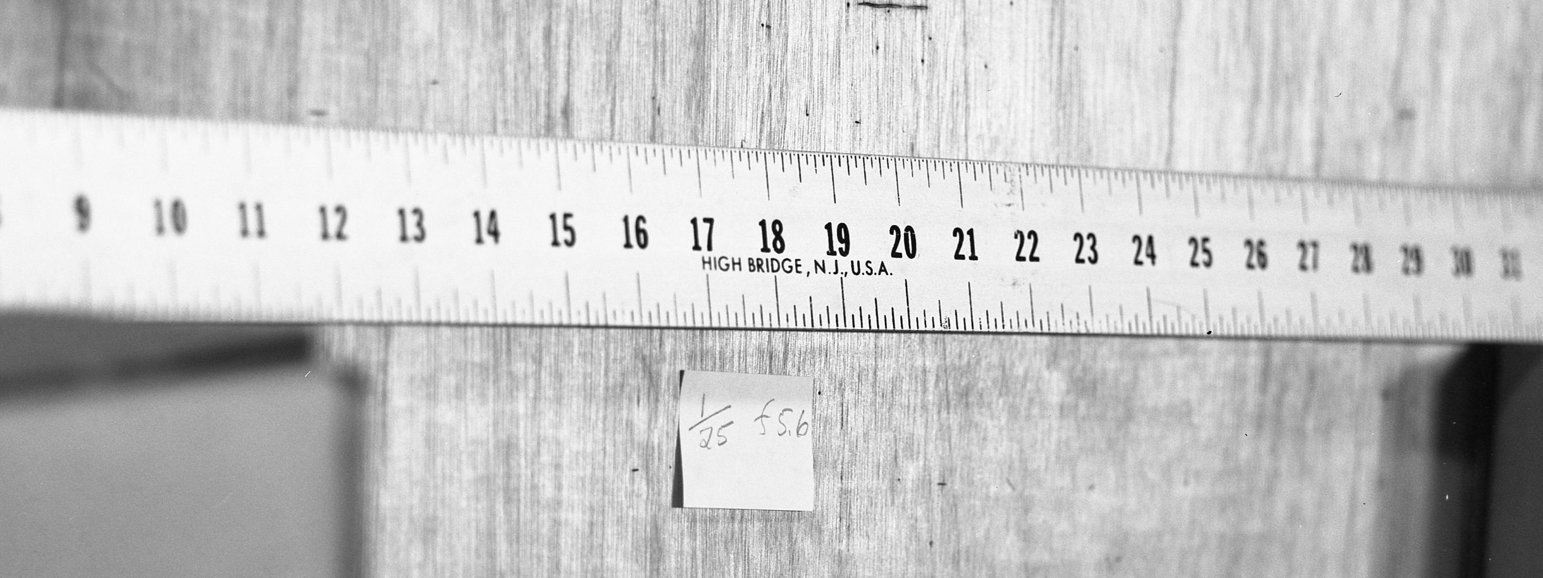

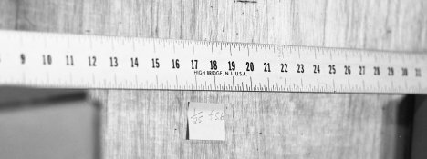

More data. Here are three more scans, two with the camera "as is"; one with the film holder shimmed out 0.2mm.
attachment.php
attachment.php
attachment.php
It looks to me like I need to shift the gg/Fresnel about 0.1mm forward.
I'd say probably 0.15mm from what I can see. But as you now know, getting your focus spot on isn't so straight forward even though I'm sure you were being careful. Its very easy to make a mistake with focussing.
If you did a ruler test with F11 or smaller I don't think you would notice the GG position error. And for your landscape images at distance I don't think its going to make a visible difference. Its more likely your focussing was off or the lens is not great for some reason or camera vibration.
I'd also check the film holders, it's just possible they aren't standard it's not unknown.
You can't shim the screen forward and machining the frame is not a good idea as it's correct as it is. It's far more than just grinding down some bosses every edge the fresnel sits on would need grinding as well.
It would be far better to try a different focus panel on the camera and check out what's really wrong, like Shutterfinger (45PSS on graflex.org) I also repair and restore cameras including Spped & Crown Graphics and that's the first thing I'd do. I'd also compare the fresnel with a genuine Graflex Ektalite and see what difference that makes and fit a new GG screen which should be significantly brighter than an original Graflex GG.
