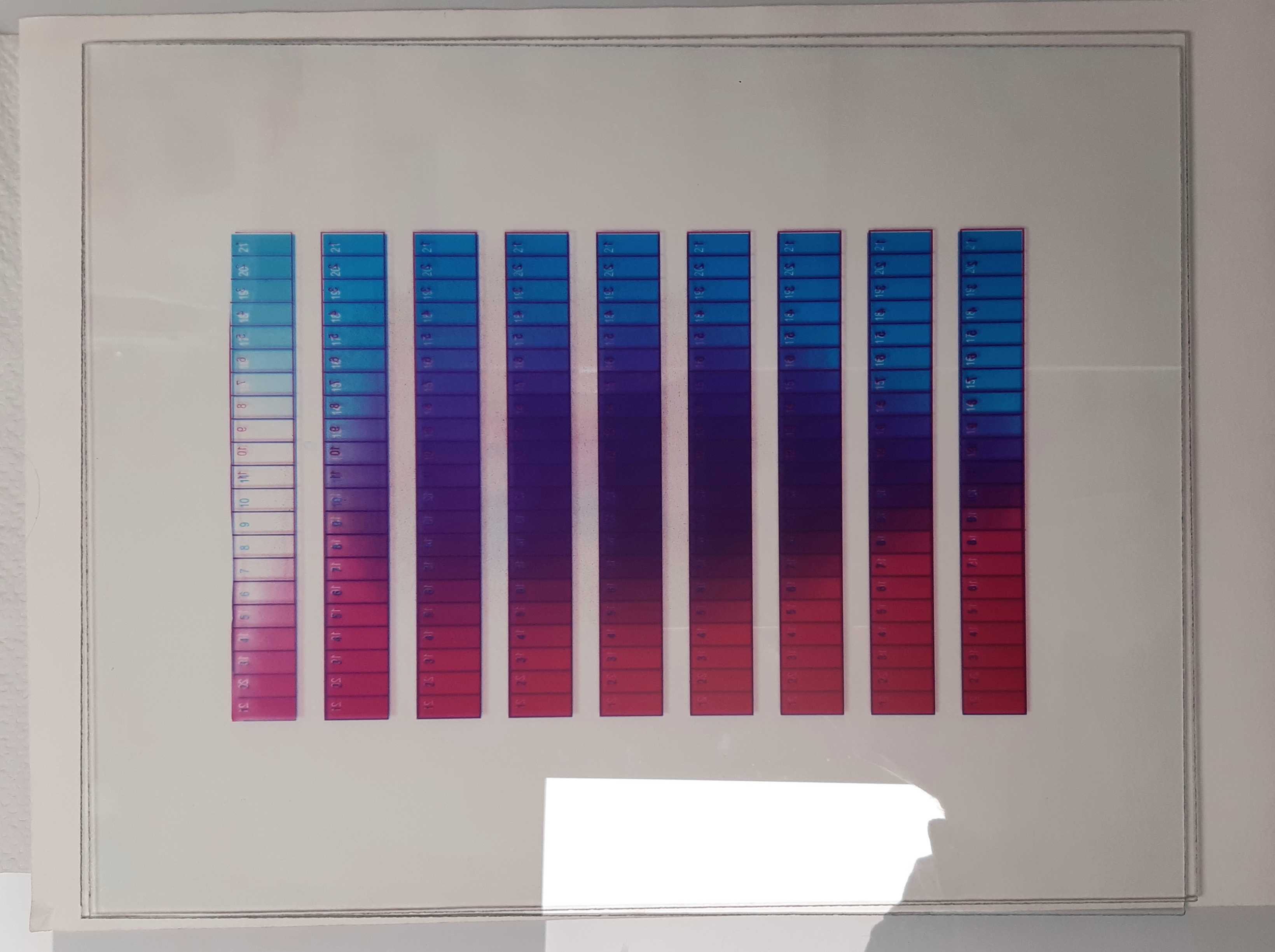

FYI here's two exposure tests, one with cyan pigment and the other magenta. For fun I flipped and stacked the two glass plates so that the gradients overlapped and blended together.
The colour plates are pretty vibrant, happy with the results so far. I plan to expose and develop the yellow plate tonight.

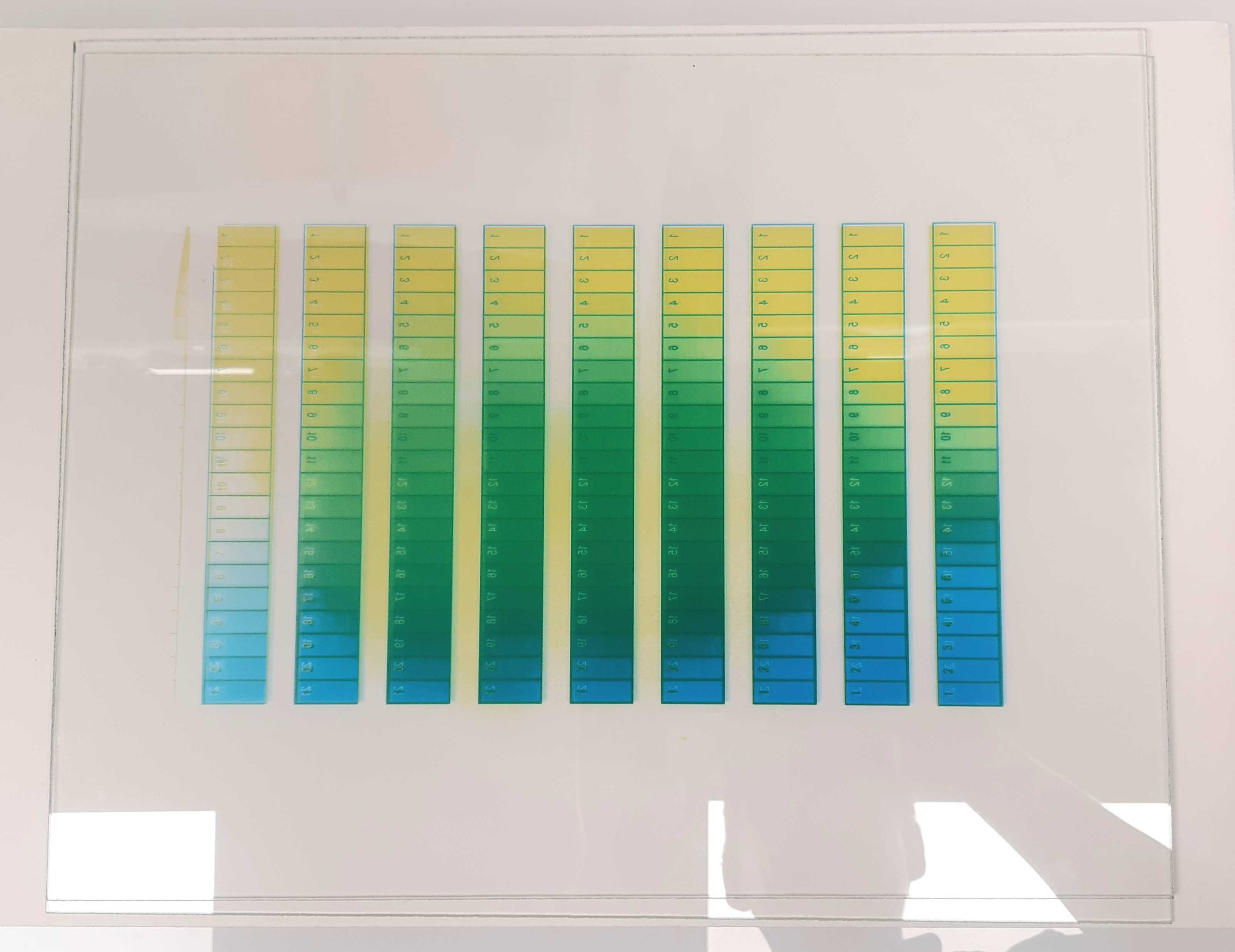

The yellow plate was a bit of a mess, still worked but there was a lot of pigment staining, even with very tenacious development. On a positive note the gelatin is really well adhered to the glass because I was spraying and pouring hot water onto the print from a reasonable height and none of it budged.
I think the staining and overall kinda crappy print is a result of the heroic pigment load Calvin recommends for his yellow colour paste carbon glop, about 60% of the dry gelatin weight! Vs. 16% for magenta and 5% for cyan. I think I might try again with a much lower pigment load, the yellow pigment is already quite opaque so I don't think I need that much pigment to get a strong colour out of it.

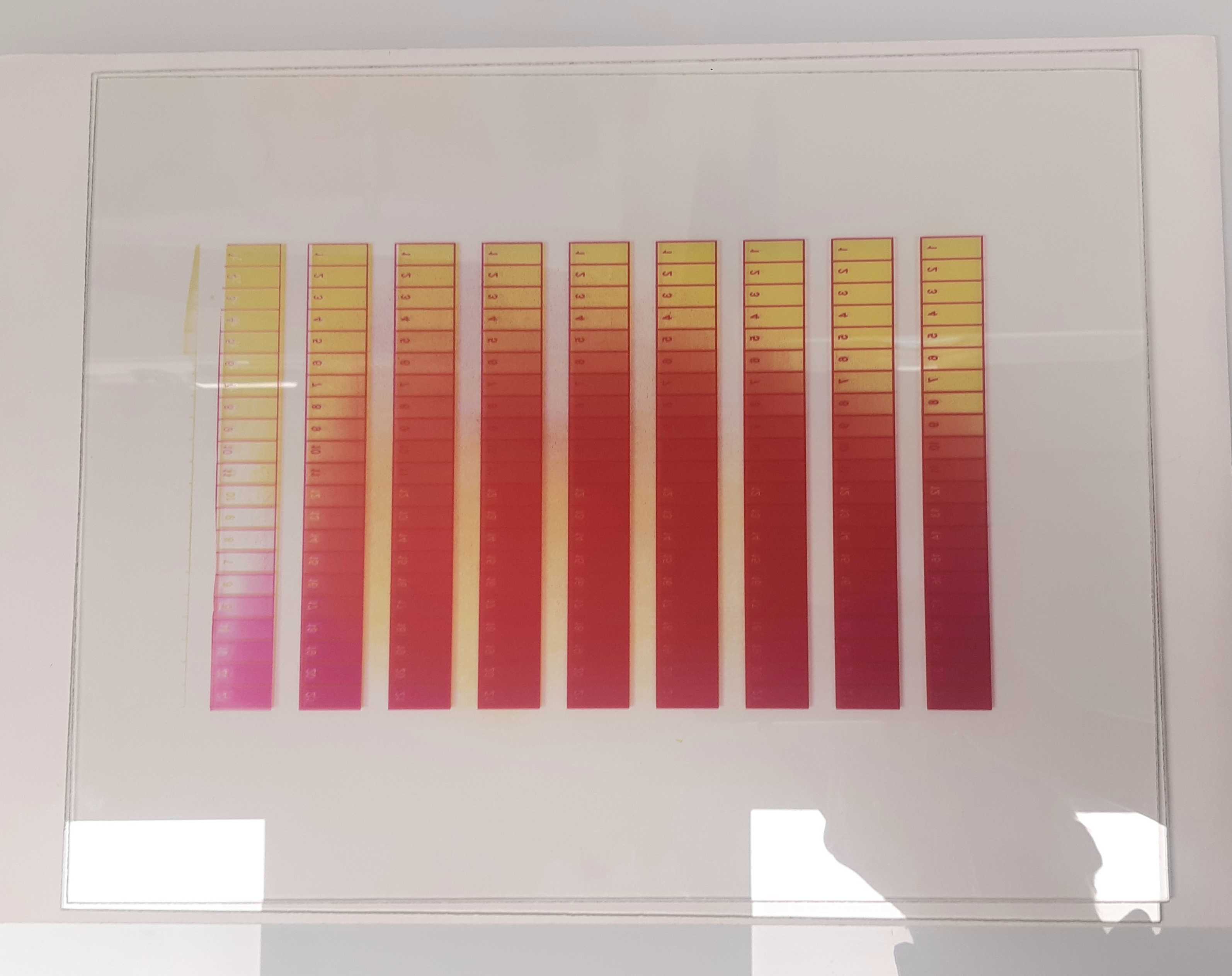

The magenta also stained a bit and it also has a fairly high pigment load. I was happy with how that plate turned out, but it was also quite a solid colour in the high-density areas so I feel like it could benefit from a lower loading too.

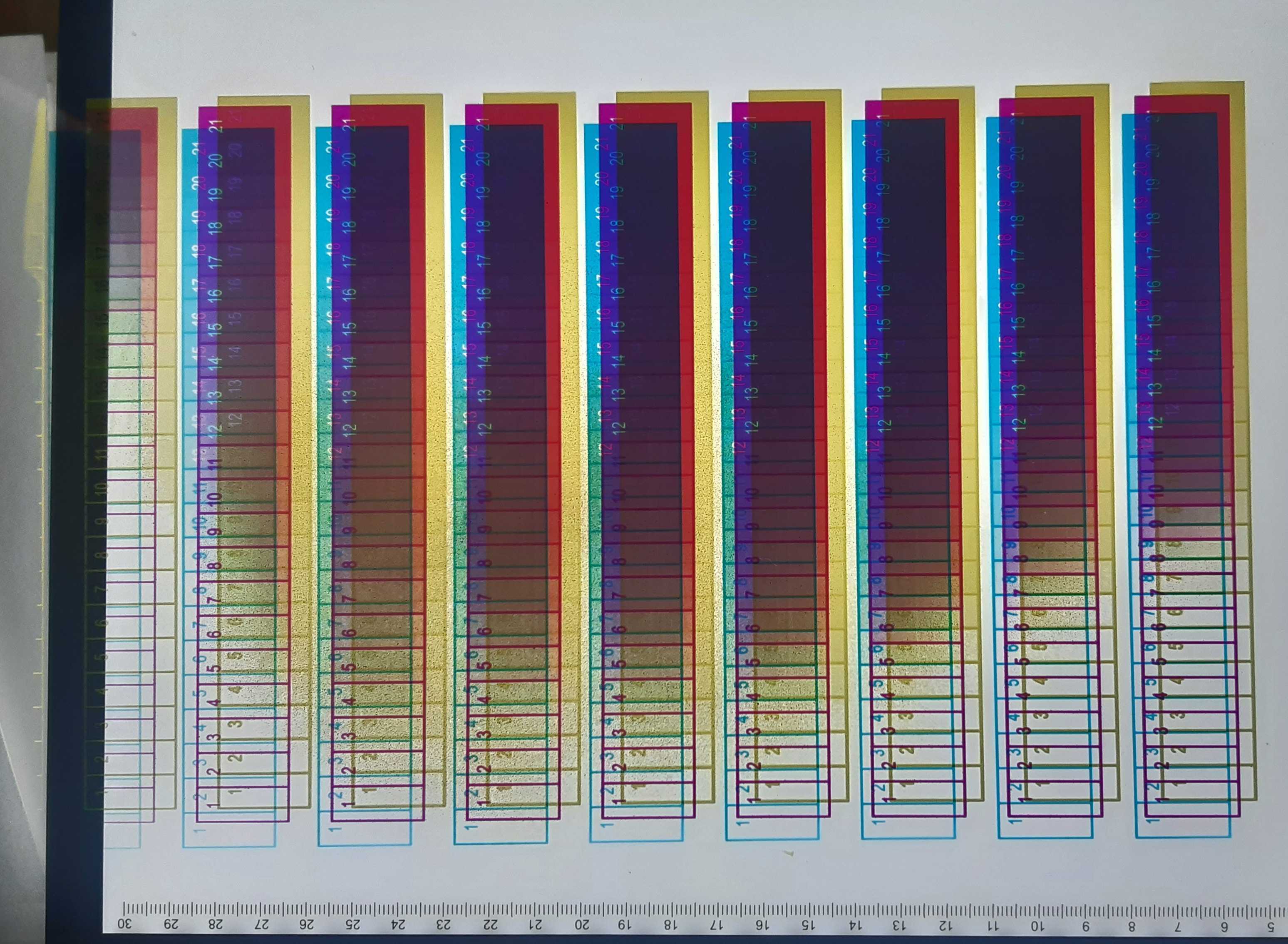

A few more pics of the colour plates overlapping. I'm going to try again with lower pigment loads on magenta and yellow, but happy with cyan at this point.
On the fence about backlight vs. place them on a very reflective white backing. Putting them on a white backing works quite well for one or two plates but once you get to 3 or 4 the slight colour of the cheap float glass adds up and the highlights look a little grey. Backlighting works quite well for 4 plates as collectively they have enough density for a reasonable black but it would be a bit more work to figure out how to integrate the backlight and present it in a nice way (don't want to have cables all over the wall etc.).

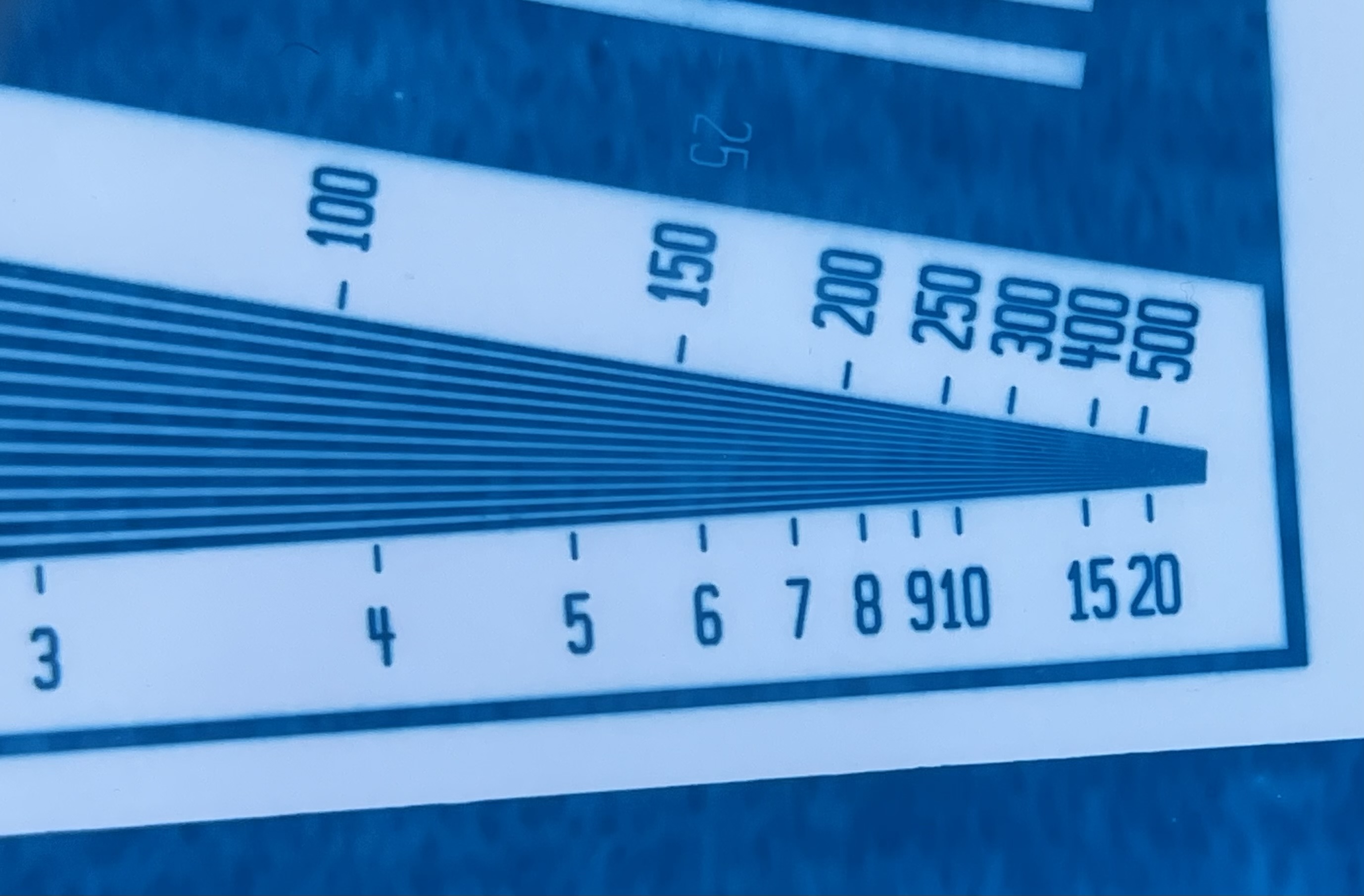

Another SbQ emulsion test on glass. Not bad resolution even with the negative sitting 1.5 mm above the emulsion surface (again, back projected through the glass thickness of such). UV Led is a projection config 80 cm above. It is a 25 mm square COB with collimating lens, running at 225 W. Line pairs resolving to 350 lpi., which is pretty good. Exposure 17s. There is bleed. It may be light travelling horizontally through the emulsion as SbQ is not much of a light blocker. I will try with cblk to see if that changes.
