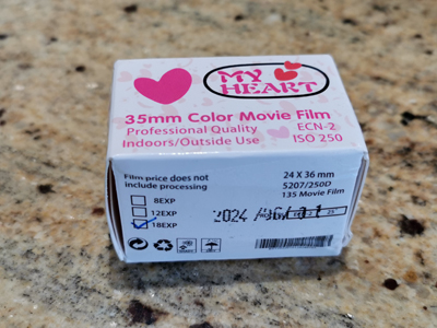

I did a brief search for it; I see it's mostly offered in 12 exposure rolls, in a white box with pink/red hearts, is that it?
Does it have any edge markings that tell us something what film this might be? I understand it's probably something 250D, so I wonder if it isn't 'simply' Vision3 250D The edge markings should make this clear if it's the case.
The various Vision 3 films in cassettes seem to come and go on UK ebay. Search for Kodak 5207. The latest "My Heart" is just labelled ISO 200, I don't know what that is, it has no Kodak number on it.

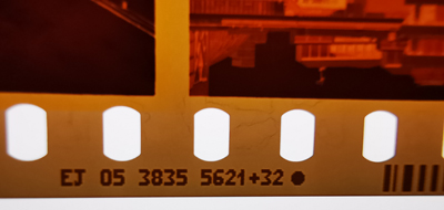

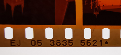

So, no edge markings on the film itself? Are the sprocket holes and film thickness the same as that of Vision3, or are they different? If they're different, they might be reconfectioning e.g. unperf 70mm film into 35mm film by slitting it and sprocket holing it.
Sounds like a lot of work, but I don't put it past the Chinese to give it a go. Those guys sure work long hours if there's any money to be made.
I think it is authentic Kodak 5207 as marked on the box but know nothing of edge marking, attached

Sorry, I missed that the box markings of this particular film were actually 5207; I thought you meant a lot of 5207 is being offered in general.
Yeah, that looks like Kodak Vision edge markings and sprocket holes alright.

Some of the "My Heart " film is Kodak Vision 3 5207 250d repackaged in either China, EU or UK .
This is not to be put through labs C-41 process as the remjet will ruin the chems.
