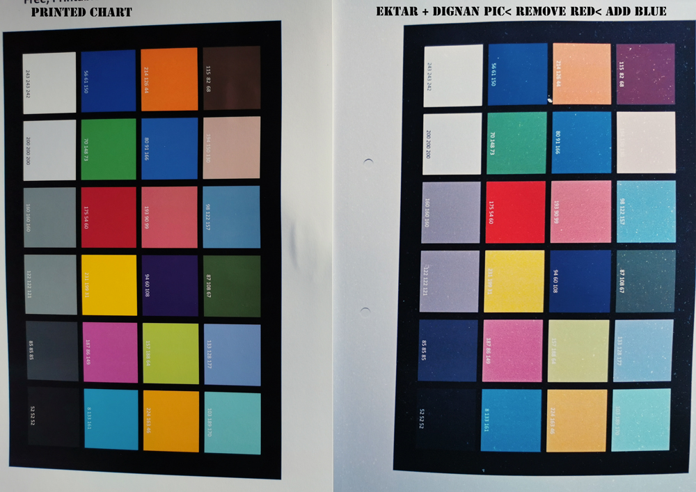

This shows the result of a quick color correction after developing in the modified Dignan process.
I don't know how close the C-41 process would come to the original printed chart.
Closer than this, that's for sure. Note the crossover if you look at the grey scale: the dark grey patches are blue, the light grey ones a kind of lime green/yellowish, suggesting crossover on the magenta/green axis as well as the blue/yellow one. All the color patches are quite far off the mark as well.
In my experience there will always be slight anomalies, even with well-processed C41, but nothing even close to this.
BTW: did you print (inkjet/laser) that test chart before photographing it? You do realize that you're introducing a massive problem by doing this? Film doesn't see what our eyes see! Think about how a printer blends colors and what film expects to see.
The chart is from here:
I made an inkjet print of it [1] , photographed it on Ektar developed by the modified Dignan process and printed out a color corrected version of an auto scan [2]. Finally photographed [1] and [2] together with my phone. It gives a rough comparison.
Looks like I will have to rely on AA, "The negative is the score and the print is the performance", not trying to copy C-41.
Yeah, so that's not a very reliable approach towards using a color checker card. In fact, it introduces so many problems right at the start that you'd be much better off photographing a couple of real world objects instead (perhaps a face, some fruit etc) and then compare your test film/prints with the real scene.
Or buy a properly made color checker.
If you want I could take a stab at explaining why inkjetting a color checker is fundamentally flawed for this purpose, but it'll have to wait until tomorrow (EU here).
