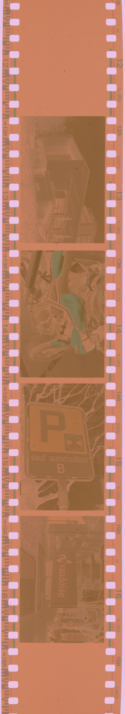

Already having most of the chemicals, I made this formula (A,B,C) and found it to work better at near 38C 102F rather than lower temperatures.
All the following solutions in containers are kept at around 38C in a sink or large bowl water bath. This water is also used for washing where indicated.
Waste water is poured into another bowl or bucket.
The solutions A,B,C are reusable and poured back into their containers after use.
(A) Developer- 5m ~38C , 2 inversions every 30 seconds. It just soaks into the film, no development at the low pH ~6.5 Keep in glass bottle preferably under inert gas.
Sodium bisulfite........................................1g
CD-4.............................................................11g
Sodium Sulfite anh..................................9g
Water to......................................................1L
(B) Alkali- 10m ~38C 2 inversions at start and then every 3 min only. It activates the developer that soaked into the film. This is the only step where a temperature close to 38C is significant.
Sodium carbonate anh 37g or monohydrate (USA) 45g or decahydrate (UK, +EU?) 101g
Potassium Bromide..................................1g
Water to........................................................1L........... Best to filter the resulting solution before use if washing soda. pH ~11.6
Wash 2x ~38C
(C) Bleach 5m 38C , 2 inversions every 30 seconds
Potassium Ferricyanide .........................40g
Potassium Bromide..................................25g
Wash 2x ~38C
(D) Fix [normal B/W fixer] 5m 38C
Wash 15m room temp, Photoflo, hang to dry.
References:
I am still at the stage of "wondering if they will come out". So far have used 10 yr expired film, Colorplus 200 and Portra 400, eg:
Wash 2x ~38C
Wash 2x ~38C
References:
