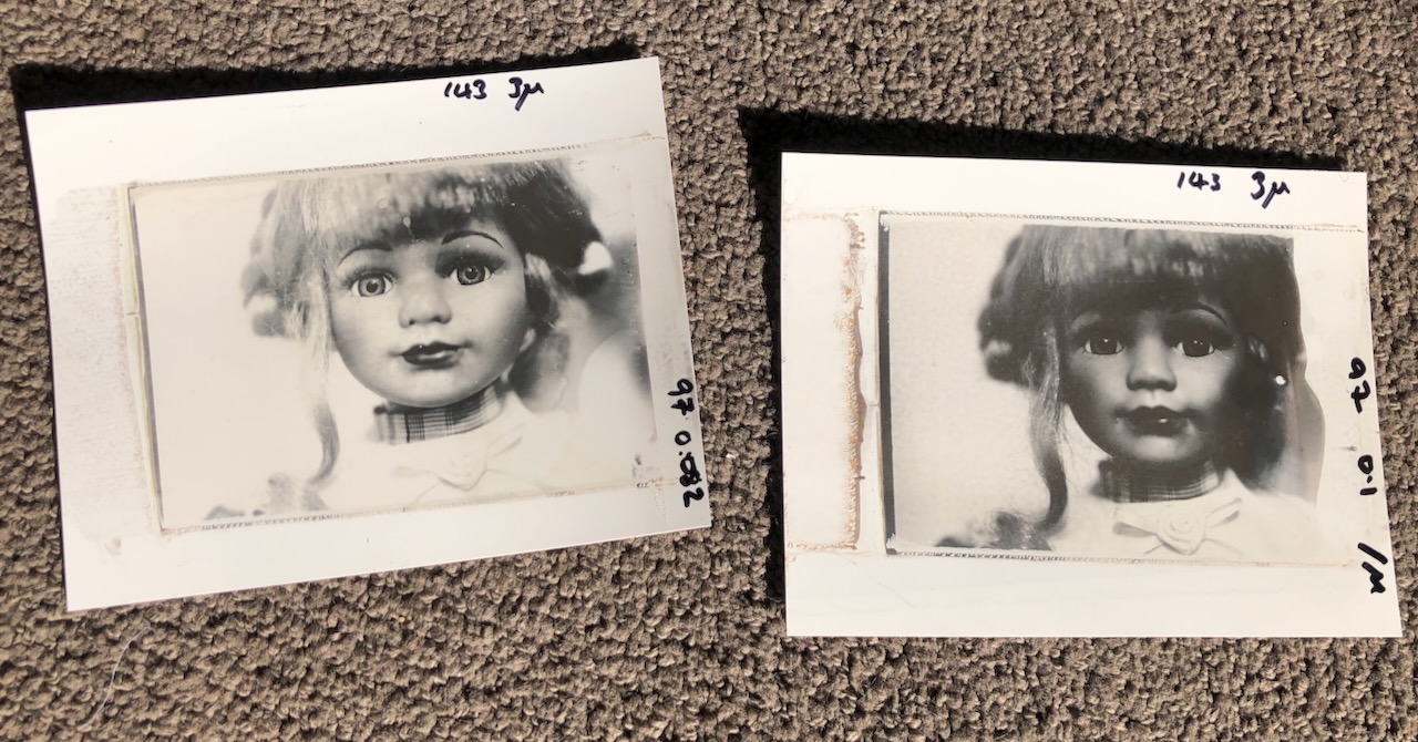

I've been working with x-ray film for the last month or so. I have been getting images at around 800ASA (if you believe the shutter on my camera - which I haven't calibrated). Unfortunately I got sold a box of dud (already opened, one sheet missing, the rest fogged) film from an eBay seller, without having achieved results that can be published.
While waiting for more to arrive (from a different vendor!) I have gone back to Ilford Multigrade paper as the film, and have made several advances.
I now have a much better recipe for the printing paper, using only reasonably available chemicals, all of which are very cheap in the quantities used. I also have a new method of conducting the spreading of the developer paste which is automatic, repeatable, and - this is a really big win - produces prints that are instantly clean, dry, glossy and don't need washing. I don't think even Edwin Land found a way to produce dry prints, so I count that as a major find. I will publish some details and videos later. Here's a pic of two prints I produced this morning, just as they came out of the "machine".
We are still not in fine-art print territory, but the road ahead looks good.
Instantly dry prints is exciting! Looking forward to seeing how you managed it. The final bits of chemistry I need for this are out for delivery today, so hopefully next week I'll be able to begin experimenting.
@alecrmyers out of curiosity, are your prints "coaterless" or will they fade with time if not coated with some kind of protectant?
Short answer: (only) time will tell.
The prints I made last year (gelatin based coating) haven’t faded at all. The silica ones I haven’t had around long enough to know.
The latest developers I’ve been using avoid sulphur-containing (thiosulphate) silver solvent, which the literature records as a concern, so that’s a plus. Leaving a bunch of “fixer” unwashed in your print seems like a bad idea.
