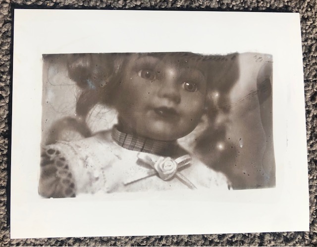

Here is a quick progress report. I have (finally) achieved imaging on a receiver paper prepared with silica instead of gelatin. Lots more to explore here including use of different nucleation particles, and how to improve Dmax and adjust the tonality. I'm still working on different developer formulations. But I was very very happy to get this image this morning, that shows good gradations:

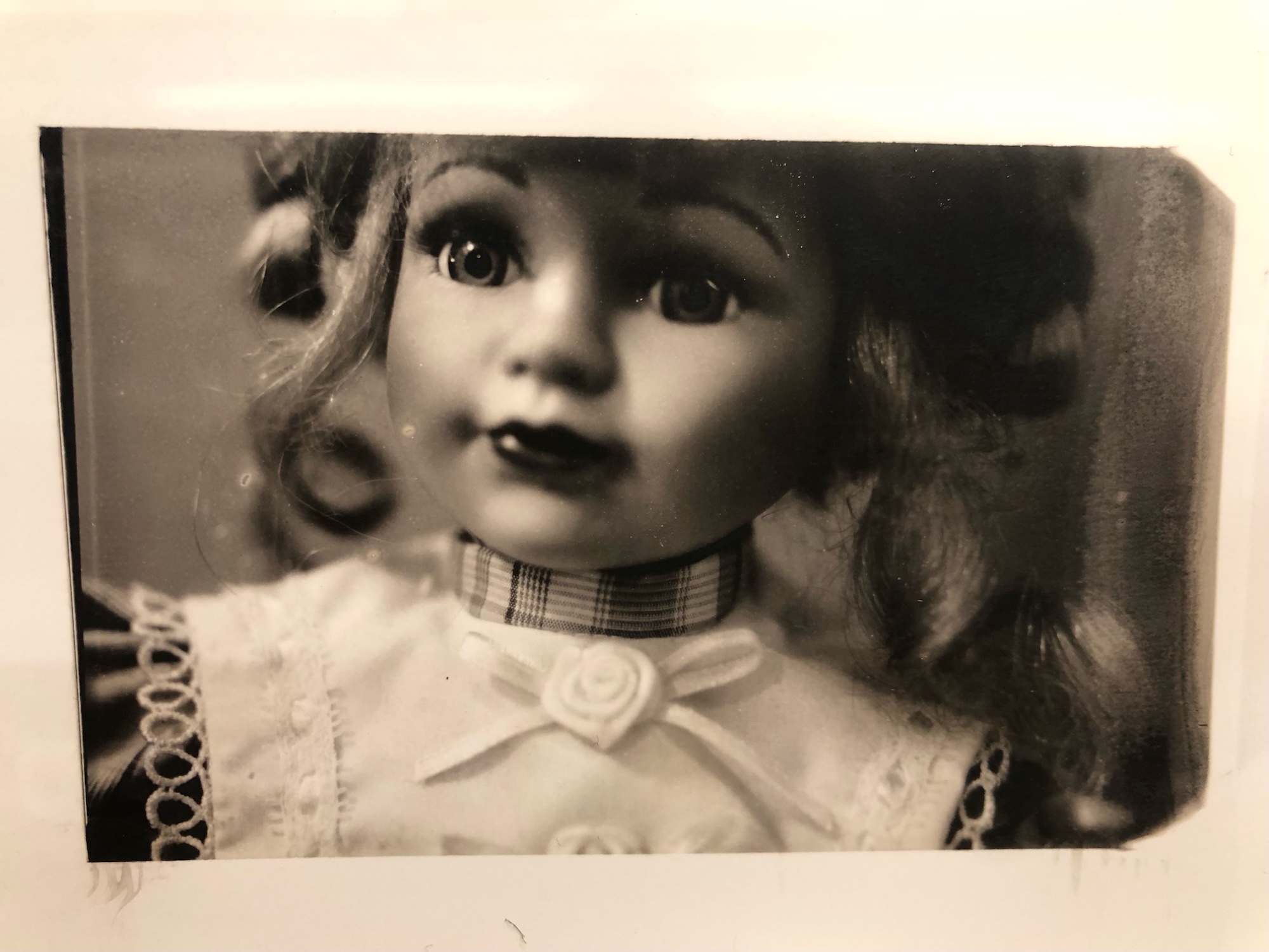

It gives really excellent results with the silica/palladium paper in my November 16 post. In fairness the jpeg of the print below doesn't do justice to the quality of the print. The silica has a very attractive natural gloss finish, the print sharpness is excellent (you can see it in the weave of the pattern on the doll's collar) and the image tone is a slightly warm black (this is where the scan falls down the most I think).
For reference, the negative material is again Ilford Multigrade, 3mil developer thickness and a contact time of 60 seconds.

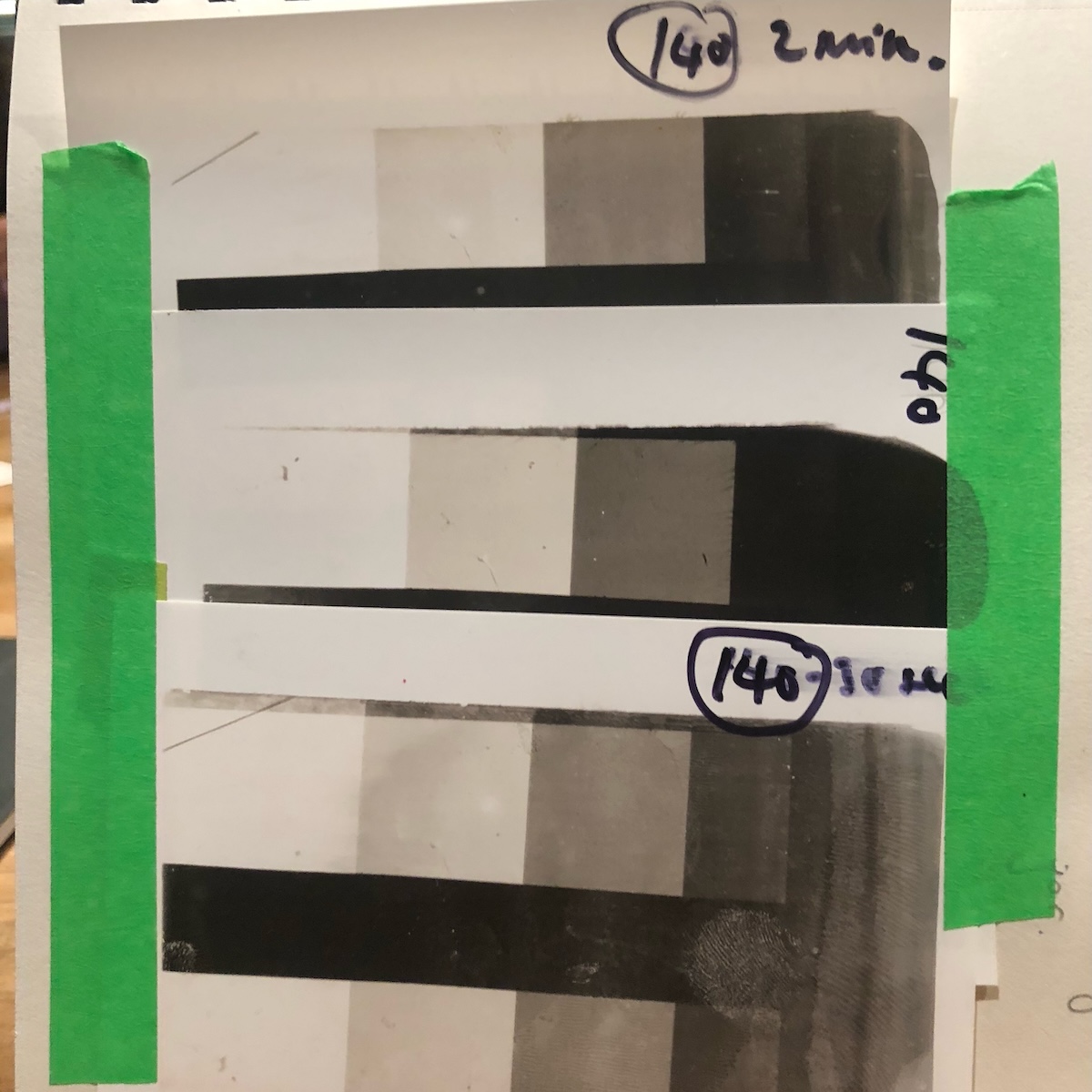

Wow!
The contact time, is it critical for contrast control?
I don't think so. I did a test - here are three test plates with developer 140, stripped at 30 seconds, 60 seconds and 120 seconds. There's not much difference in contrast. A little difference in density - the 30 second plate is (a little bit) lighter in the blacks, that's all.

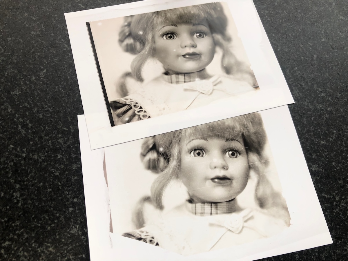

I made a new batch of paper and developer and tried again, to check repeatability. I'd say it's pretty good.
