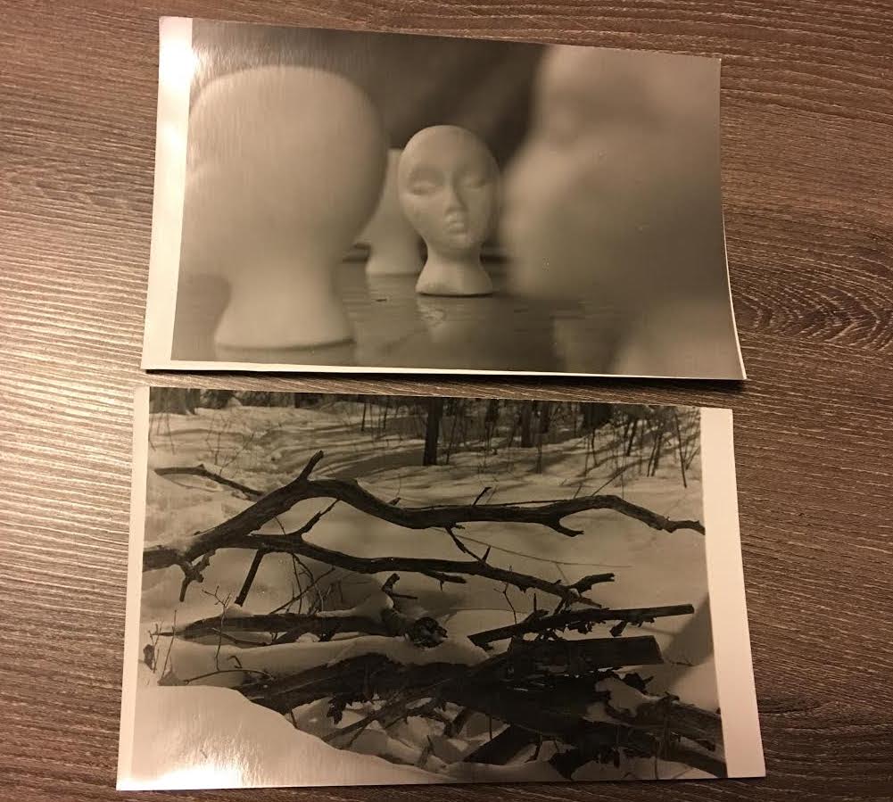

I'm including my VERY FIRST (so go easy) printed images I ever made. (As of a few days ago.) Feel free to critique or use these as examples of what I could change in correlation with this question.

is he not referring to printing a "true black" -ie giving enough exposure to the printing paper (as opposed to the negative)
once you have given the exposure to the shadows you require on the negative then they are far more locked in place than the highlights which can be made darker or lighter by changing the development time.
prints look great - killer first go. You will get really good very quickly.

Yes, your prints seem to look good. I say "seem to" because the lighting on your examples isn't even and it makes it hard to judge. The snow scene looks like you hit exposure and development pretty darn close. As for the "develop for the highlights"? If you would have added 20 to 30% more time to your development your brightest snow would have been brighter yet and maybe blown. It means that area in the negative would be much more dense or darker. If you went the other way and gave less development the snow would be darker. Your shadow areas would pretty much remain the same since that is controlled more by exposure.

I only said "seem to" because it's hard for me to see by the angle of the light shining on the prints and the reflection. Nothing to do with your prints actually.
I was just talking the "film" stage and not the printing stage. You have to get the negative pretty close to right or you won't get both the highlights and shadows to come out the way you want. If you don't get the exposure of the negative as it should and the development right you will likely have either good highlights or good shadows, but not both. Remember, Rome wasn't built in one day, or one week or one year. Patients and reading good reference books in the beginning helped me and I still struggled some. You're on your way and the light bulb will certainly flick on for you.
