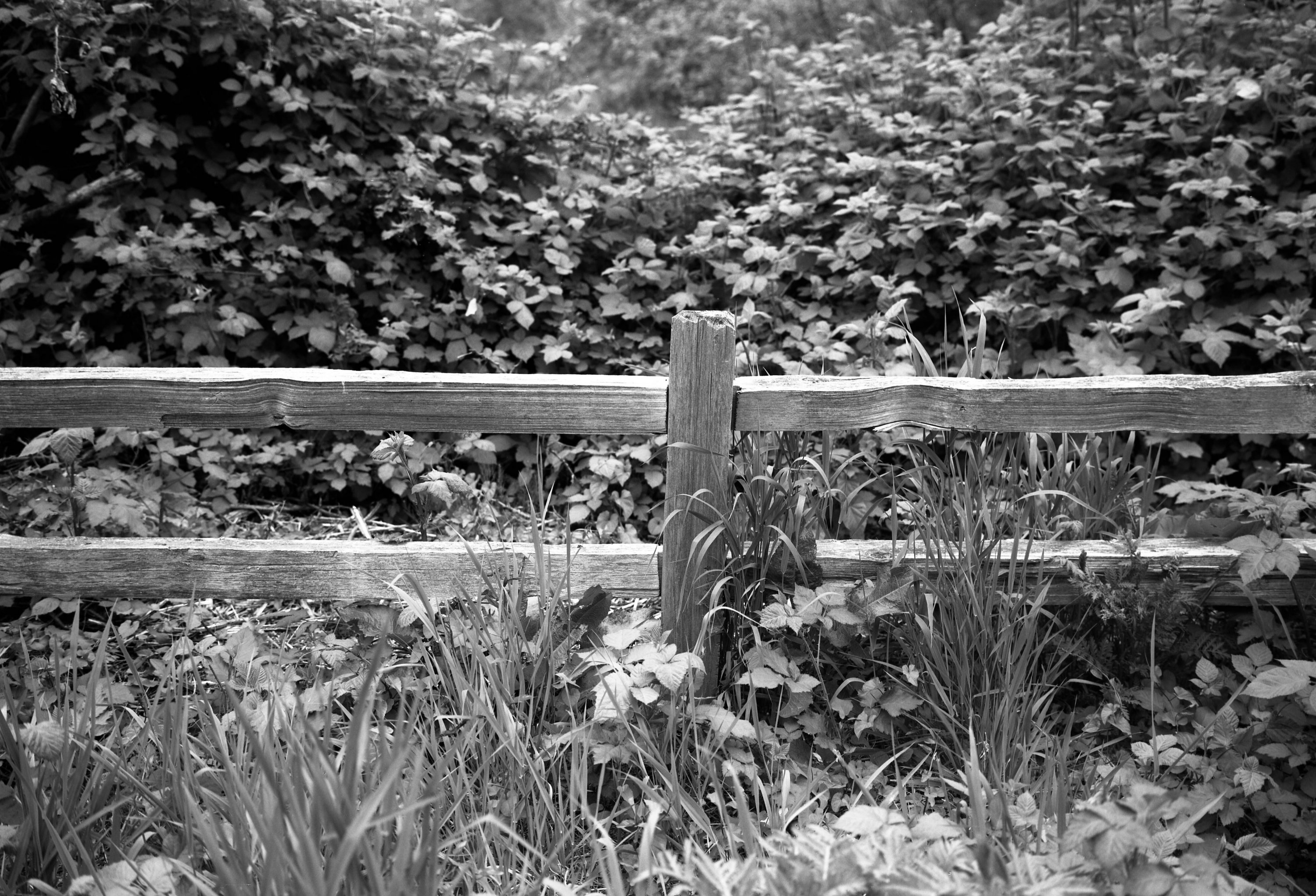

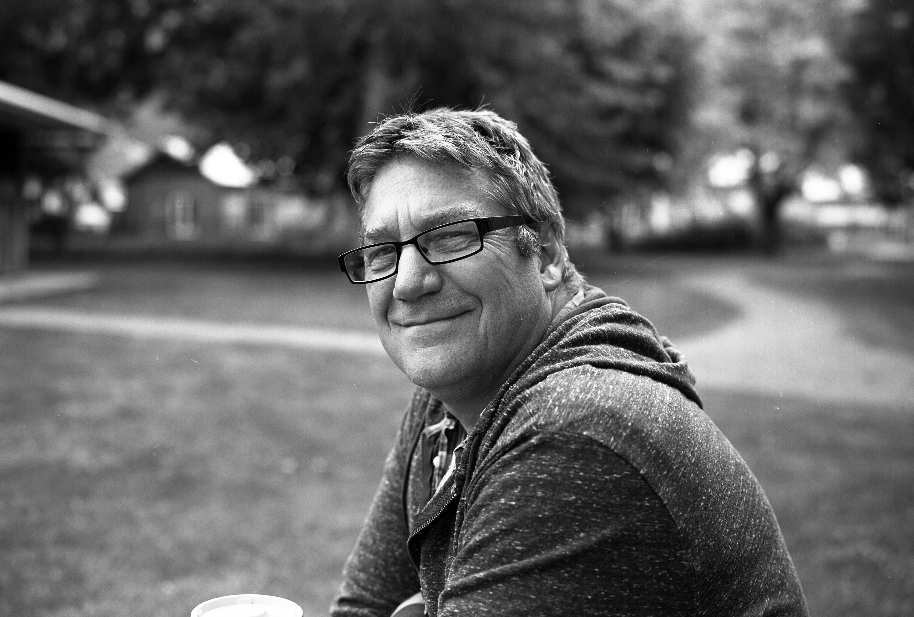

I shot my first roll of TMAX 400 since around 25 years. I developed it in Xtol straight at 6.5 minutes. I ended up with a negative that looked normal. Some shots were less dense then normal exposure as well on the neg. Yet when I scanned it up on my Epson flatbed (I shot 120), a few shots the highlights -were bordering on, if not actually, blown out. I like the look TMAX 400 gives for B&W, but it seems a little tricky on the scans.
Did I overdevelop? I doubt it since the negs weren't very dense on quite a few shots. So what could be going wrong? Or is this normal for this film? I tried to tame it a little in the scan.

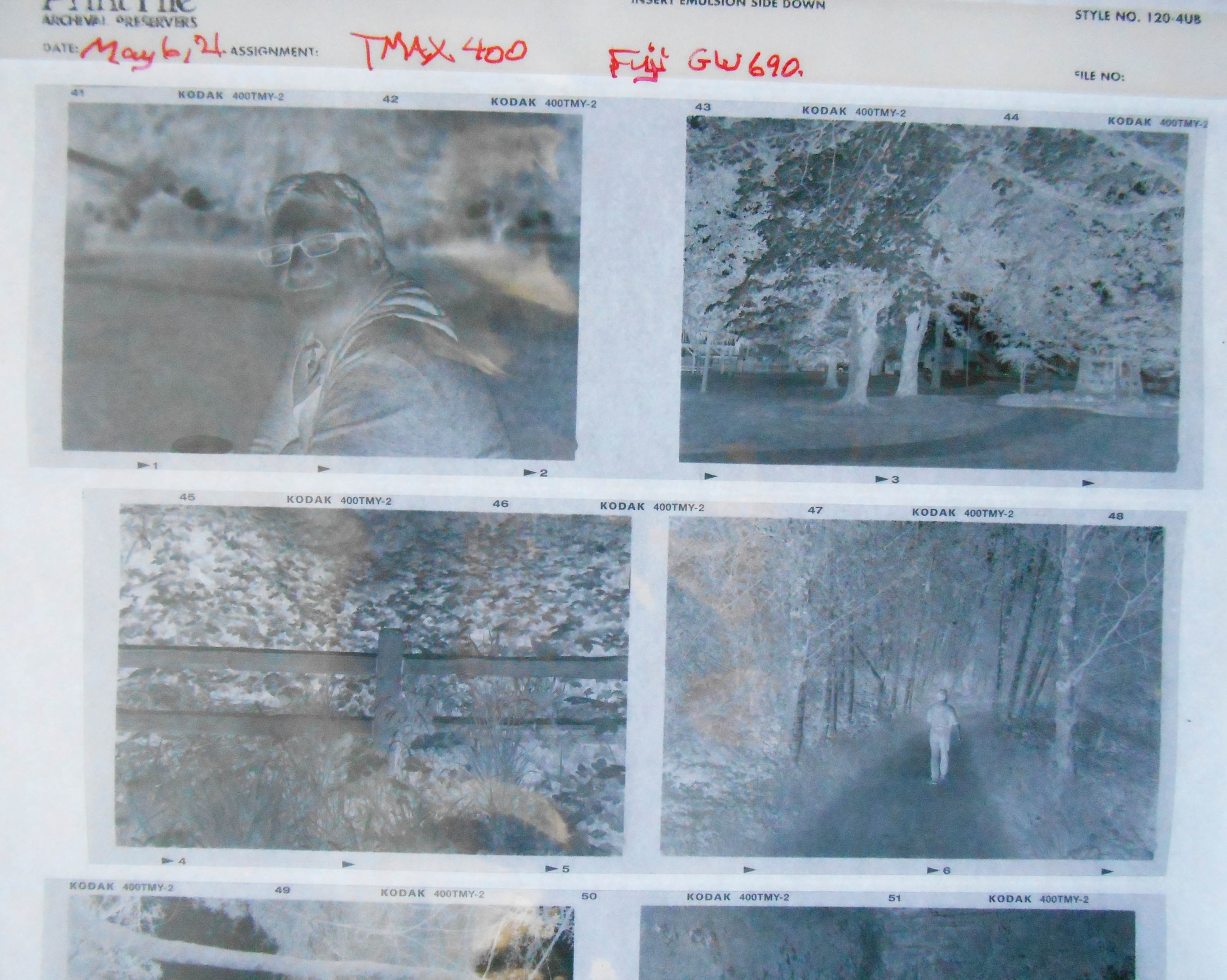

Show us the negatives instead of scans.

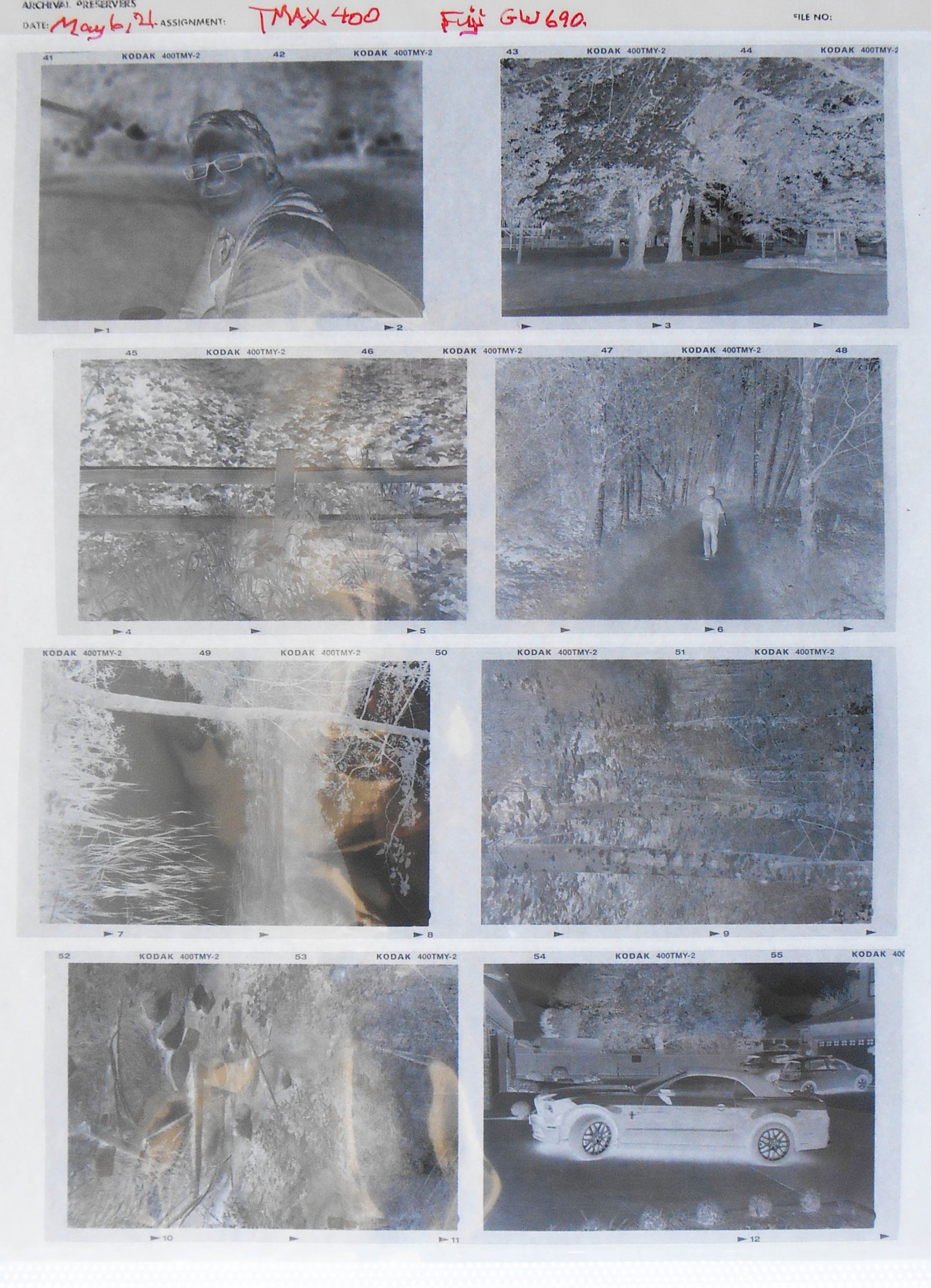

They look pretty normal to me. Maybe slightly more development than to my taste, but nothing clearly wrong.
The highlight areas are, of course, significantly more dense than the non-highlight areas, but that looks to be a function of the lighting and subject than the film.
If you are used to a film that shoulders more, and therefore tends to suppress that build up of density, you may wish to adjust your approach to development or scanning.
Most likely there is lots of usable detail in those highlights, when you burn them in a bit.

I shot the pictures with my P&S digi camera, so it was reflecting parts on the plastic Printfile sheets. There is no color in the negs. As for the scans, they shouldn't have any color.

Your pictures look good. There's a little white clipping on the guy's forehead and on the fence rail. You might be able to improve that using White slider in Lightroom or equivalent.
I scan with a V850 (before with a V600). The only setting I use is setting the black and white points just beyond the edges of the actual histogram for each shot I scan. That gives me the full extent of the range shot so there's no clipping from the scan although if you clipped the original film, you're pretty much stuck with that. I use 16-bit grayscale at 2400. All other scanner adjustments are shut off. If there's still a little clipping in the final scan results, I use Whites and Blacks sliders in Lightroom to reduce or eliminate them. Then I adjust contrast and sharpness and other stuff to taste. Good luck.

I was surprised at how much I liked TMAX 400. Though it had weird grain structure on human skin, the tones were really good on that. I could see the stubble on his face with the scan off 6x9. Im really liking using the Fuji 690 cameras. I like the wider frame matching 35mm. Only thing is I need to bring a second camera with me to use its light meter. I dont have a Sekonic yet.

TMY in Xtol is a match made in heaven. Xtol is very good at preventing highlights from becoming blocked/overdeveloped. Your negatives look close to optimal (not overdeveloped) so I suspect you need to tweak scanner settings.
