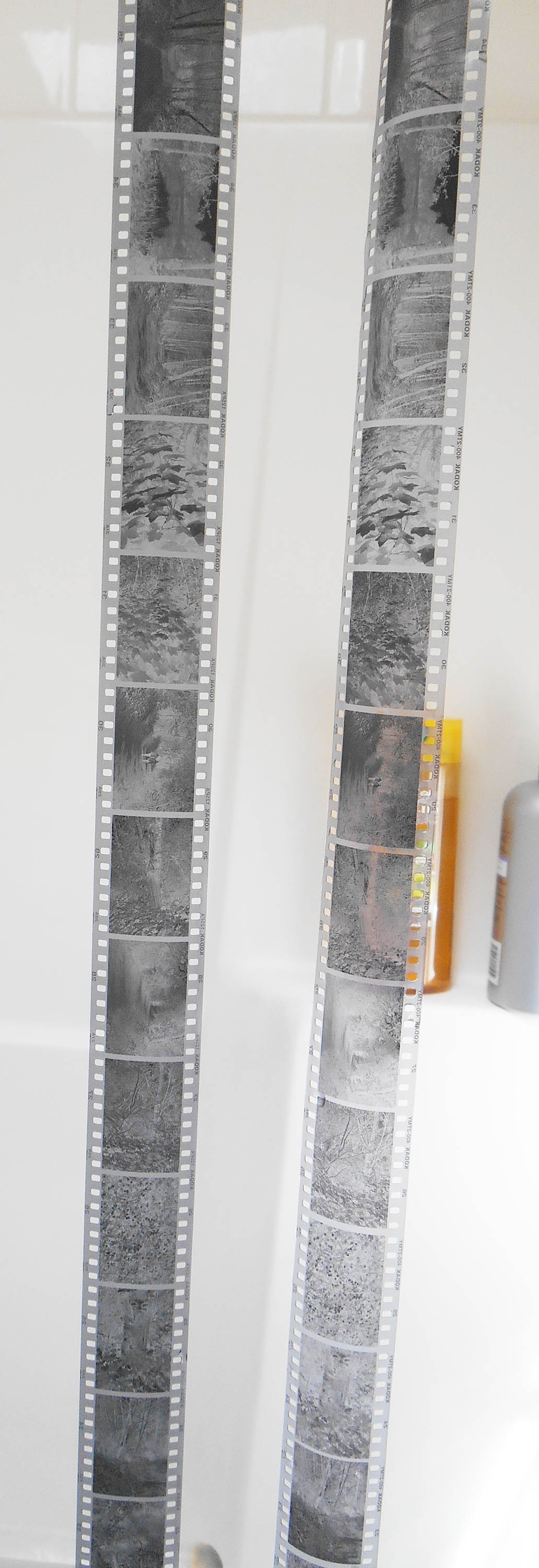

They are now drying.

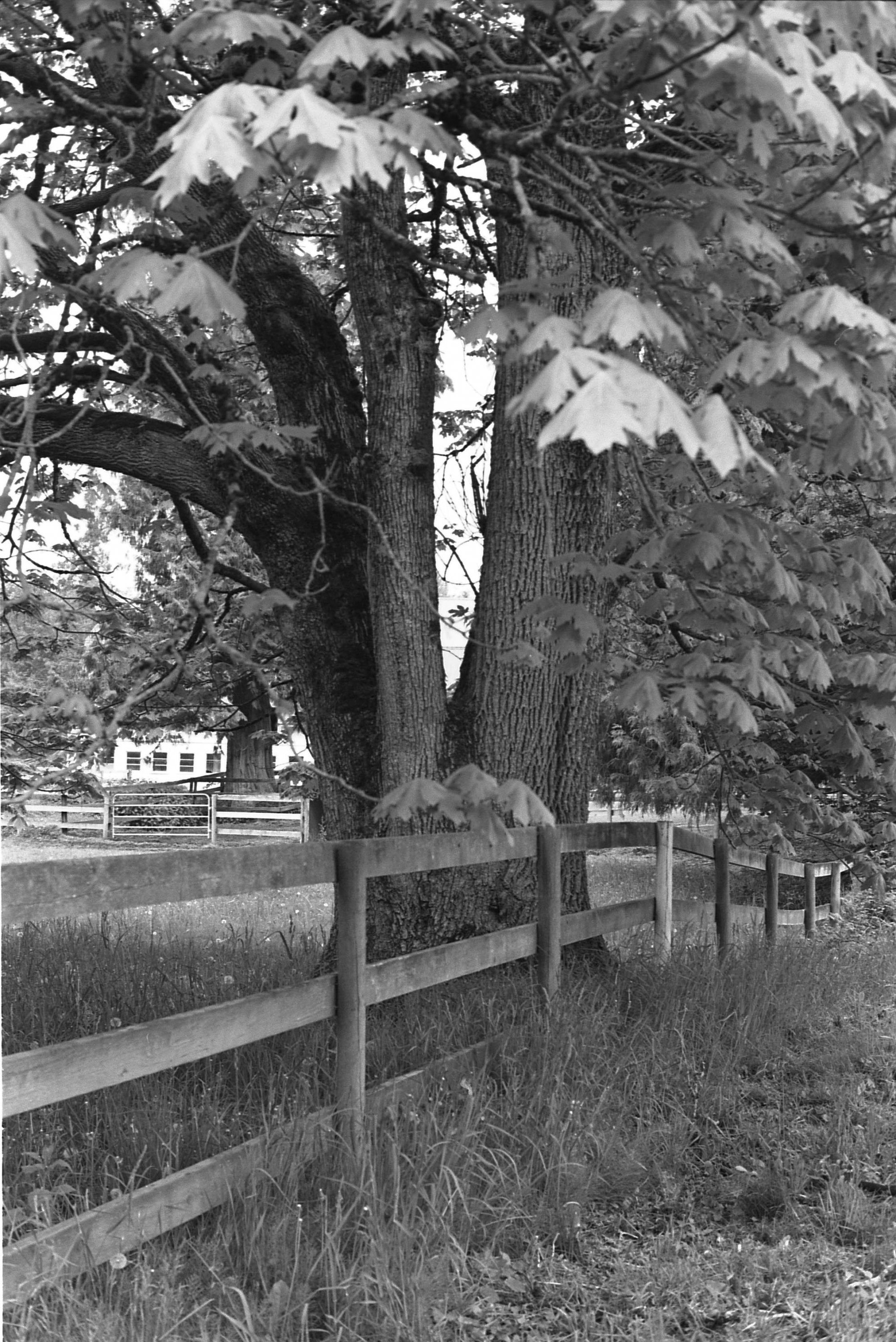

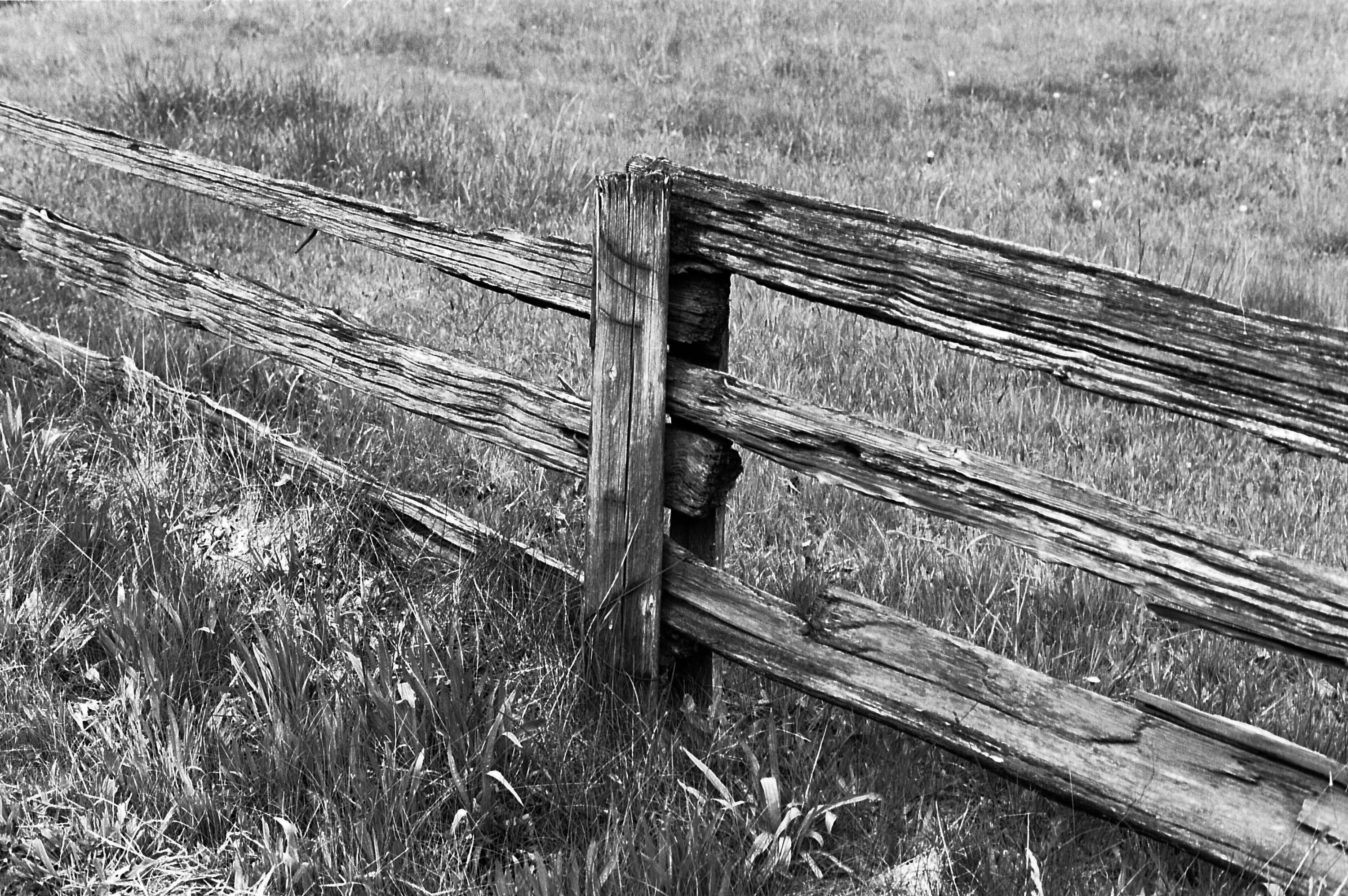

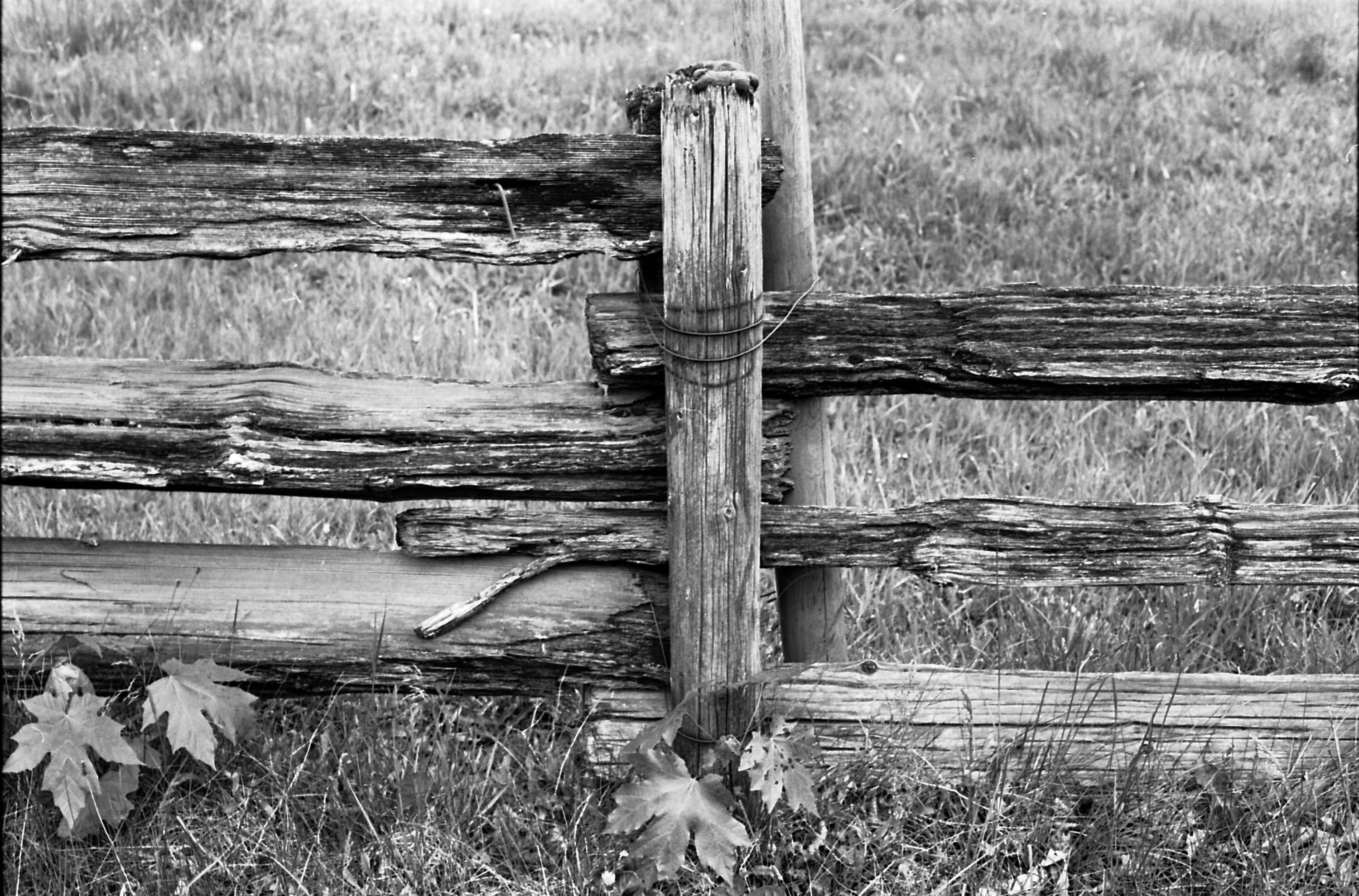

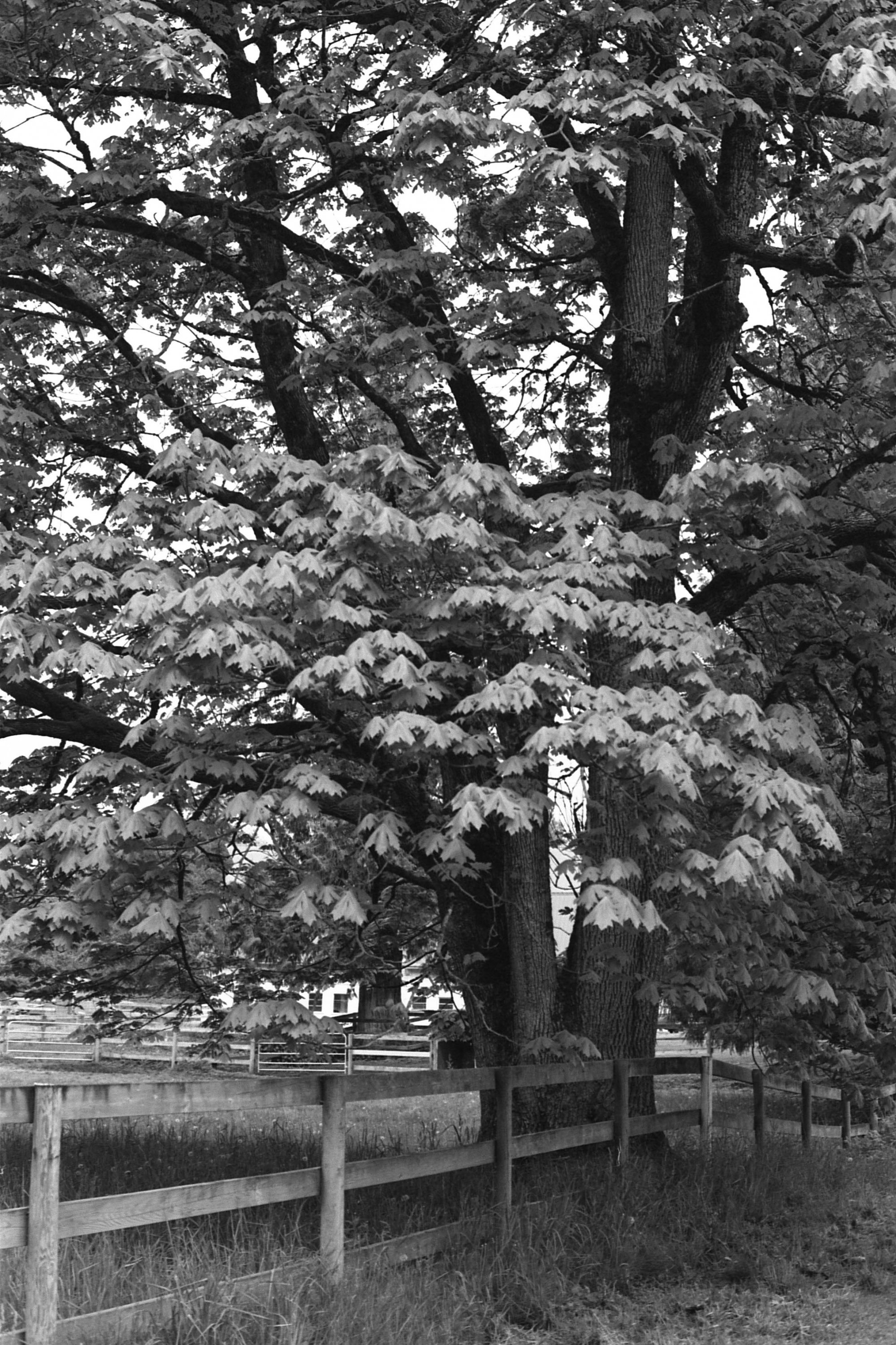

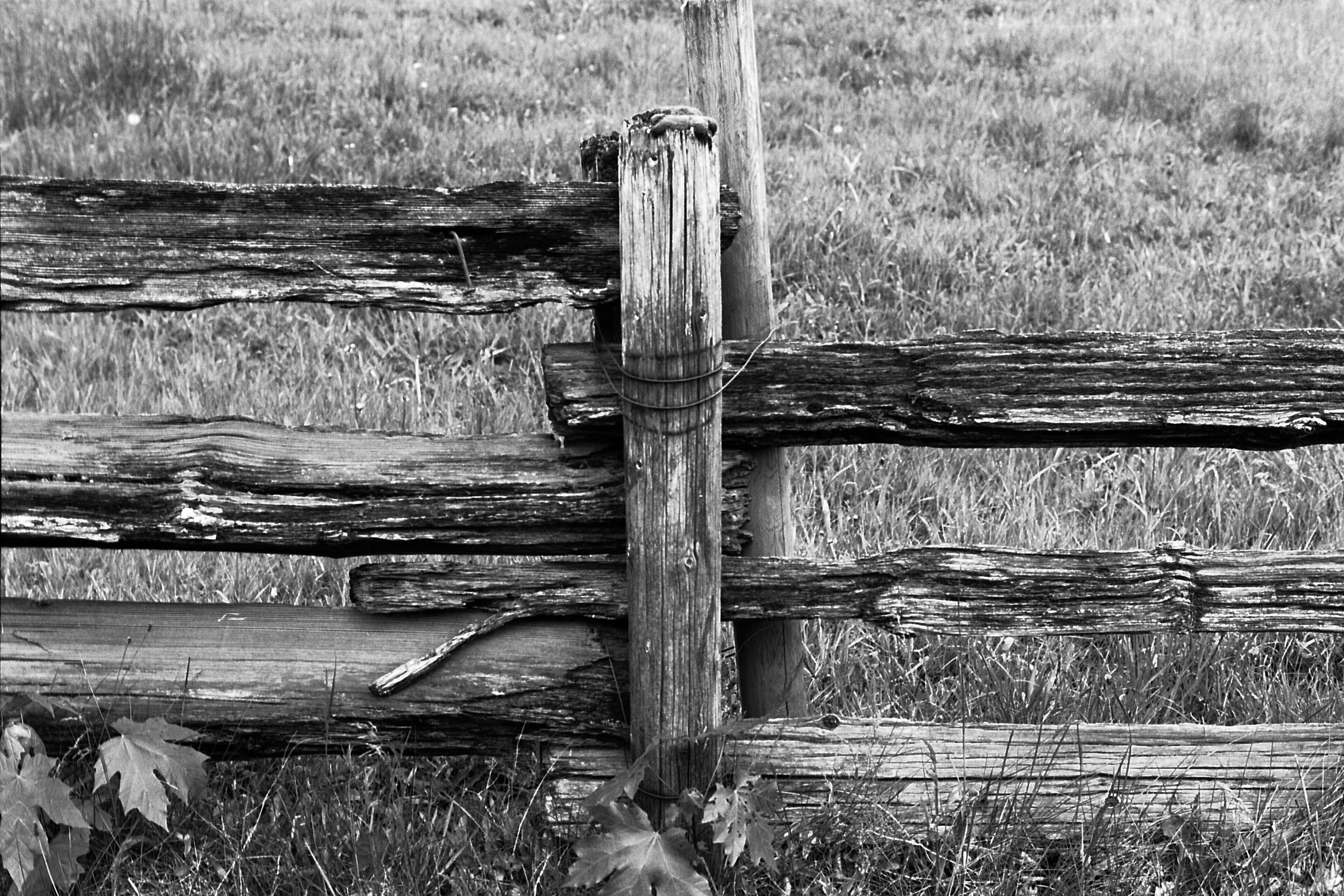

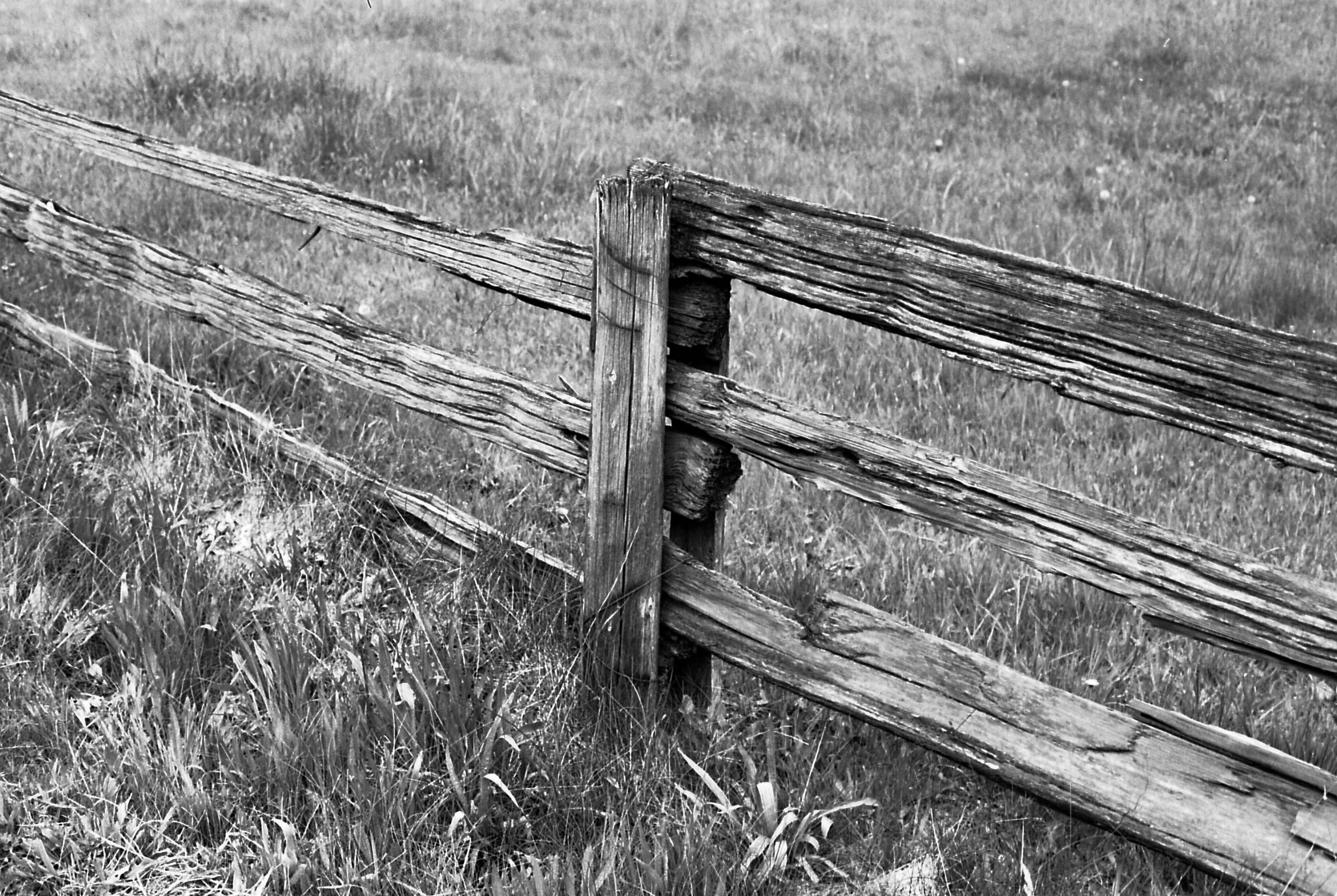

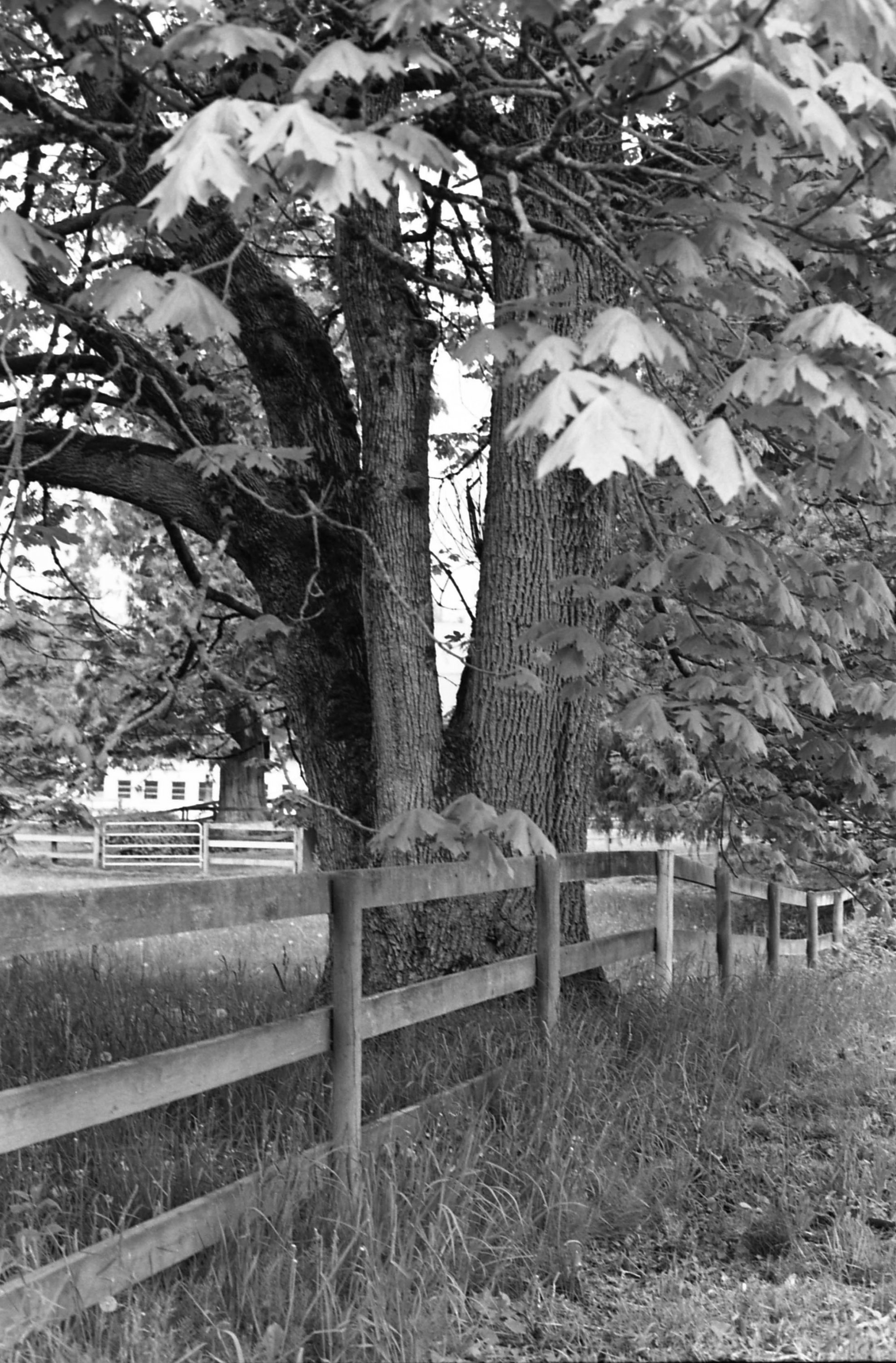

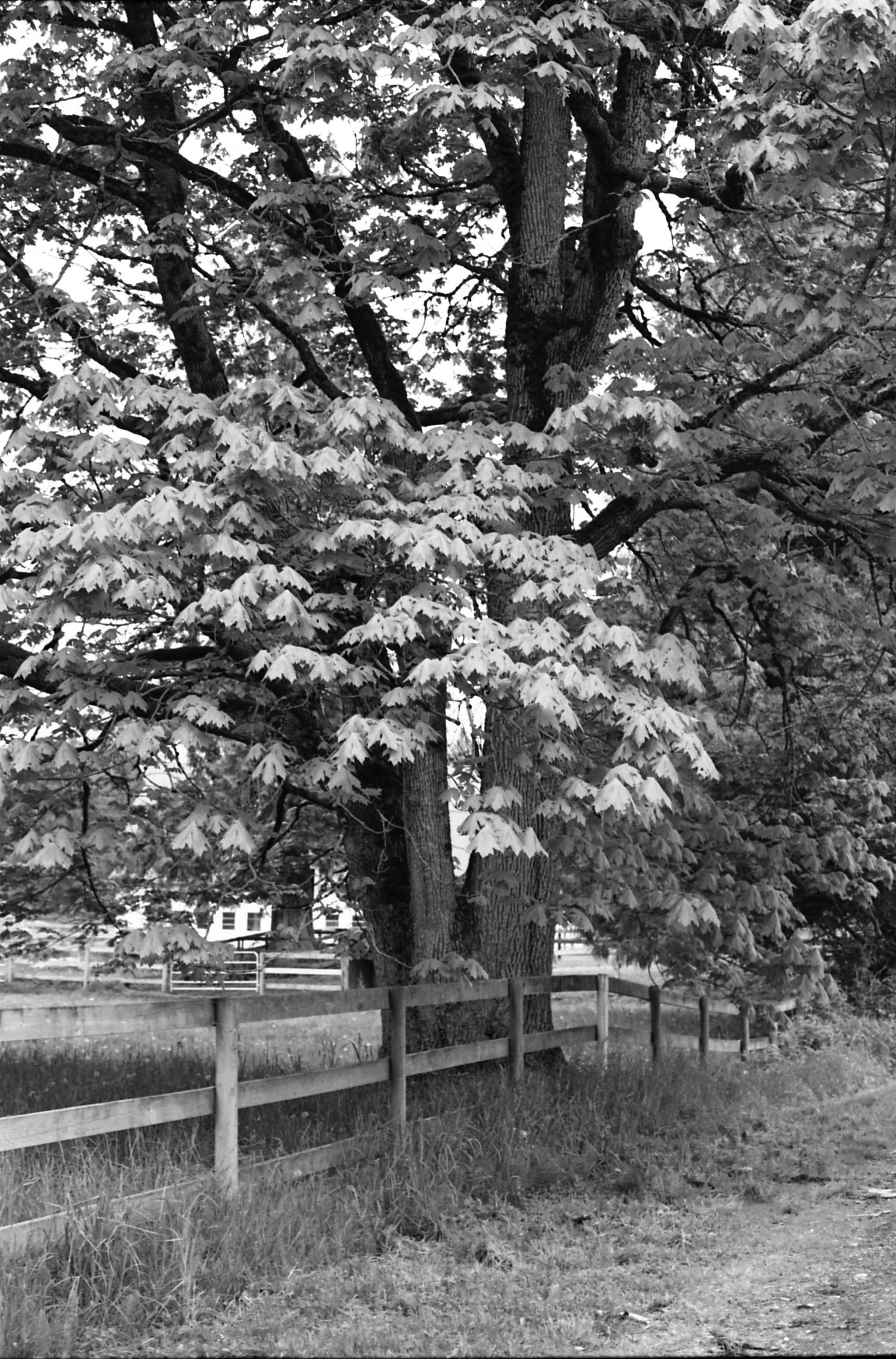

Just finished scanning the Plus X and TMAX 400. Even in 35mm Im getting blown highlights, so it seems I'll have to do the histogram method which would take way longer. I had to use my flatbed again, as my Minolta film scanner (3rd one of this scanner) wasn't working in the advance again. Im about to give up trying to get a good copy of that film scanner.
Here are some samples of Plus X vs TMAX400.

looks great to me.
Ditto on the scanning diagnosis. In the shot of the man, on the negative that highlight in front of his face has a lot more density than his forehead, yet his forehead is borderline blowing out.
Not that it helps much, but I always dev TMY in XTOL 1:1 following Kodak's times and things have always come out pretty scannable and printable.
Yeah the Plus X seems to have slightly lighter tones then the Tmax 400 does.
