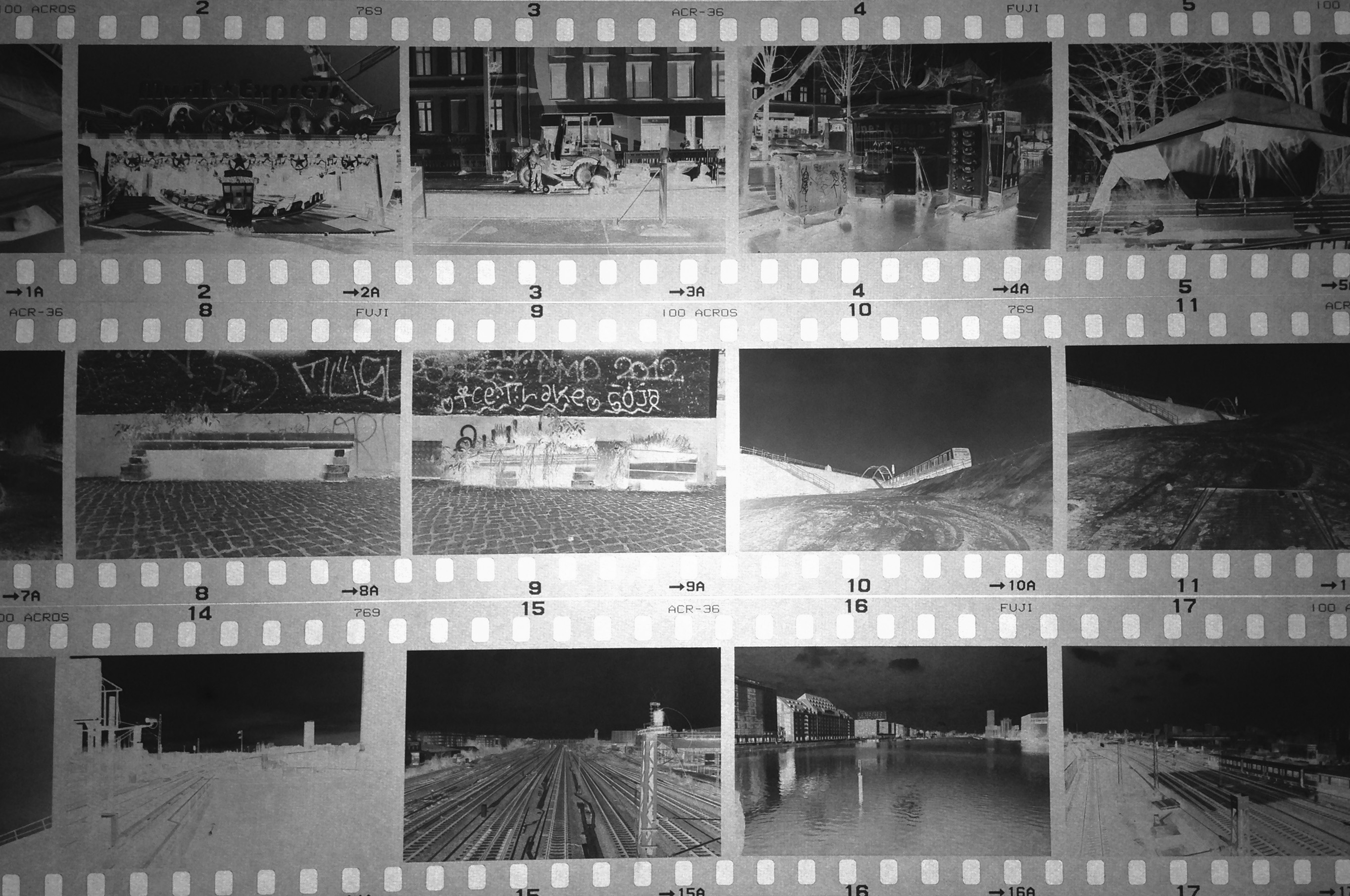

    To truly assess what is happening here we will need to see a photo of the negatives because this may be an issue with your scans. You can do this easily by fixing them on a window with Tesa and then taking a photo with a digital camera or your smart phone. Please post this without doing any corrections.
    Also, in your original post you wrote "the 30s rinse between A and B". If you are doing a rinse between Bath A and Bath B this is wrong. There should be no rinse between these baths.

    There you go (I put them on an LED lamp / transparent paper) as it's pretty dark outside; hope this helps!
    So these are from the same roll as images posted in the opening post (see first row of negatives),
    as I said chemicals were 22°C, method 5:5.
    30sec wash between solution B and fixer (temp around 20°C as I'm not able to keep my tap water constant),
    final wash 15mins at around 20°C, which dropped down to something below 15°C at some point.

    I'd say these are overdeveloped, highlights in the upper strip are clearly blocked. Shadows look OK for a negative that was underexposed by one stop.
