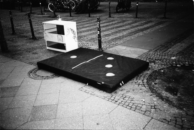

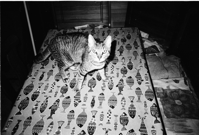

So as you can see the sunny one is really contrasty, the overcast one is pretty much ok, and the third one shot with flash as well.
Still quite a lot of punch, considering they havent't been edited at all.

Those are way too contrasty. The development times may be too long. Use intermittent agitation with full tank, gentle inversions for 5 secs/minute.

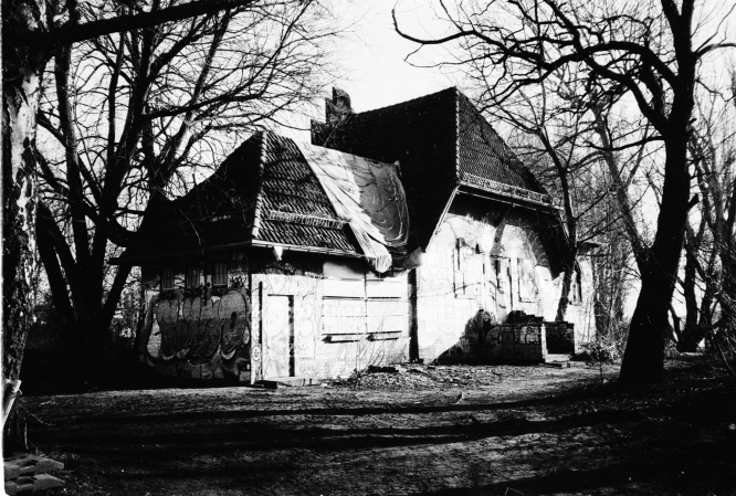

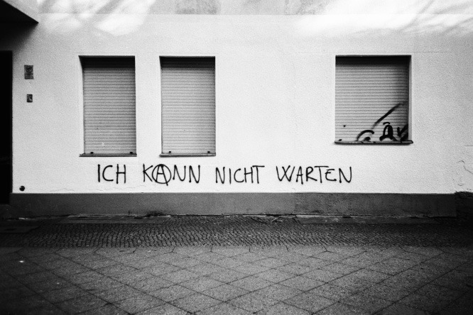

Developed the next roll: this time shot @ ISO 100, dev again 5 min A and 5 min B at 20°C, and one gentle agitation every minute.
Images are not as brutally contrast-y as before but still have quite some punch. Bit much I think.

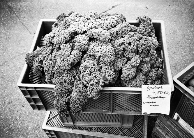

Anyways here's a photo of some kale, will post more later..
