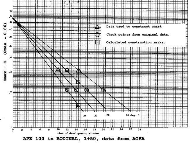

Here, if it goes through, is a chart of the type I have been describing, for APX 100 in Rodinal 1+50. Data read from AGFA chart.

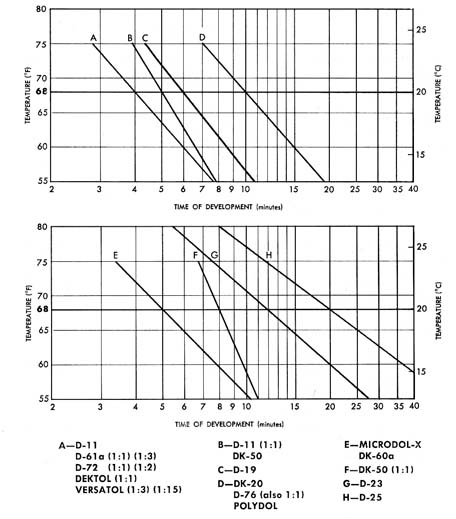

Here is the plot of several Kodak developers as a function of temperature, with the film held constant and the time of development is that which gives the closest match to speed and contrast in all cases.
It is taken from the Kodak Advanced Technical publication J-1 "Processing Chemicals and Formulas for Black-and-White Photography".
PE
Please note the severe difference in slopes of two of these, and the moderate difference with the rest of them. This indicates that the developers behave differently with temperature. In particular, note DK-50.
PE
Yes, each developer is different until proved otherwise, and its interaction with each film is likewise. No matter how you cut it, you need a different chart for each combo. I have found that fact to be true by analyzing the data provided in J-109 for Xtol. Each chart is different, even though the developer is always Xtol, but the deviation of the math model from the actual data is no greater than what might be expected from random experimenal errors.

The slopes differ substantially, especially when one considers that this is semi log paper and therefore the slopes are really tangents to curved lines as has been noted before and shown in previous posts. These plots will be a close approximation for all 8 developers shown if adjusted for the film in question and that is how the wheel works. JGE (Just Good Enough). But, if you want the best results, you need to run the process at 68 degrees or work out an exact time and temperature slope for your film and developer. Kodak offered that wheel as a close approximation for amateurs, not an exact result for professionals or for those demanding highest quality.

The very same data that I showed in graph form exists in the form of a spreadsheet produced by the computer program that I wrote some years ago. I have tested the program on the J-109 data and found quite good agreement. I enter three values of CI from J-109 for a particular film (I keep thinking I already said this) and the program computes the other values in that particular spreadsheet. If you would like, I will be glad to e-mail the program. It's only about 50 K. It runs directly on MSDOS machines. I shall try to show a sample of what it prints out.
  • apx100chart.txt

Yes. The data were from AGFA, in the form of curves showing time vs temperature for fixed CI of .55, .65 and .75. You would never suspect by looking at the raw data that you coud get such an orderly plot or spread sheet, but you can see by the graph that the lines derived from the AGFA curves also fit other data points that were not used in deriving the result.

k(T) is the slope on semilog paper of the line of constant 75 degree temperature. Take the ratio of 2 such slopes, divide that number by the temperature difference, and the log of that number is C. It is supposed to make interpolating or extrapolating new temperature lines "easier".
Great!
So the value for k(68) in your generated table for APX100 in Rodinal is the semilog slope for the constant 68 degree line. This fits with some of the regressions I had done with the J-109 data, but I hadn't thought to relate it to Dmax.
