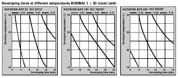

so curves for different temperatures emanate from the same point and are also straight lines.
Gadget,
Does this chart agree with your graphing ? I'm not quite following what you're saying, and am a little confused. Well, confused.

He is using semi log paper to plot the same generic type of data, but with a twist as he is varying contrast. The Kodak and your data and mine are based on "aim" contrast. Our data also compare a film in a developer or a group of developers. Or a group of films with a developer to show the curves you have.
If you look at your 3 films, they just don't match each other! That is the key to this. Each film and each developer is different. Patrick is just doing something different in that his example, as I said, has varying contrasts.
Gadget,
don
The premise in the Rodinal curves is that you are trying to hold a constant gamma by adjusting time to suit temperature. My curves show the effects of time and temperature on gamma, but the "mapping" is not conventional. Each line on my plot is for a constant temperature. Each line on the Rodinal chart is for a constant gamma. I will look in more detail to see what kind of a chart I can get from the one you posted. I used to have a copy of that chart.

I used the Agfa data for 20 C, 12 m, G=0.55, 16.8 m, G=0.65, to estimate that the Gmax for APX100 is 0.834. I had to use my program for successive approximation to get it. This establishes a line on semilog paper. I used a point at 22 C, G=0.65, t=14 m to establish another line. Now I have two lines on semilog paper emanating from 0.834 at t=0, one passing through (0.834 - 0.65) at 16.8 m and the other through (0.834 - 0.65) at 14 m. G is on the log axis and t is on the linear axis.
In order to establish lines for 18 C and 24 C, I drew a vertical line across the other lines. I marked a point along this line above the 20 degree line a distance equal to the distance along the vertical line between the 20 and 22 degree lines, and another point the same distance below the 20 degree line. I now have 4 constant temperature lines emanating from the same Gmax. All of these were constructed from the 2 pairs of time-gamma values. That of course does not make them valid representations of nature, but there are data on the Rodinal chart I have not used yet. The value of G at 20 C, 18.8 minutes should be 0.75, according to Agfa's chart. I see a value of Gmax-G of about 0.1. 0.834 -.1 = 0.734 in the chart I made.
