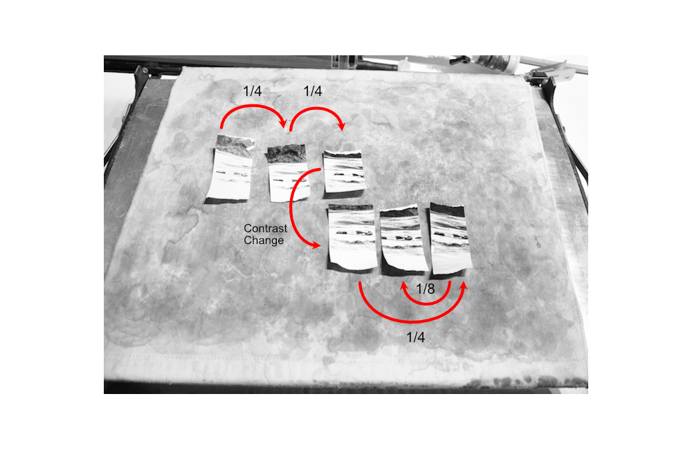

I use little strips of paper and make multiple exposures, in a rational order, to zero in on the correct base contrast and exposure. From there a full size sheet is exposed and dodging/burning are then explored.
I use so-called "f-stop printing" where an exposure time change of 1/4 stop = 1.19 factor etc.

You could scan or take a photo of the print and test strip and post here to get feed back. Its difficult to trouble shoot a print just using words.
I do similar and then do a full size test strip to further fine tune dodge and burns, then do several prints till I get it right (or close enough if its just playing around). In fact by the time I make a print for hanging on the wall I have probably done a dozen prints.....lucky I dont do it for a living.
