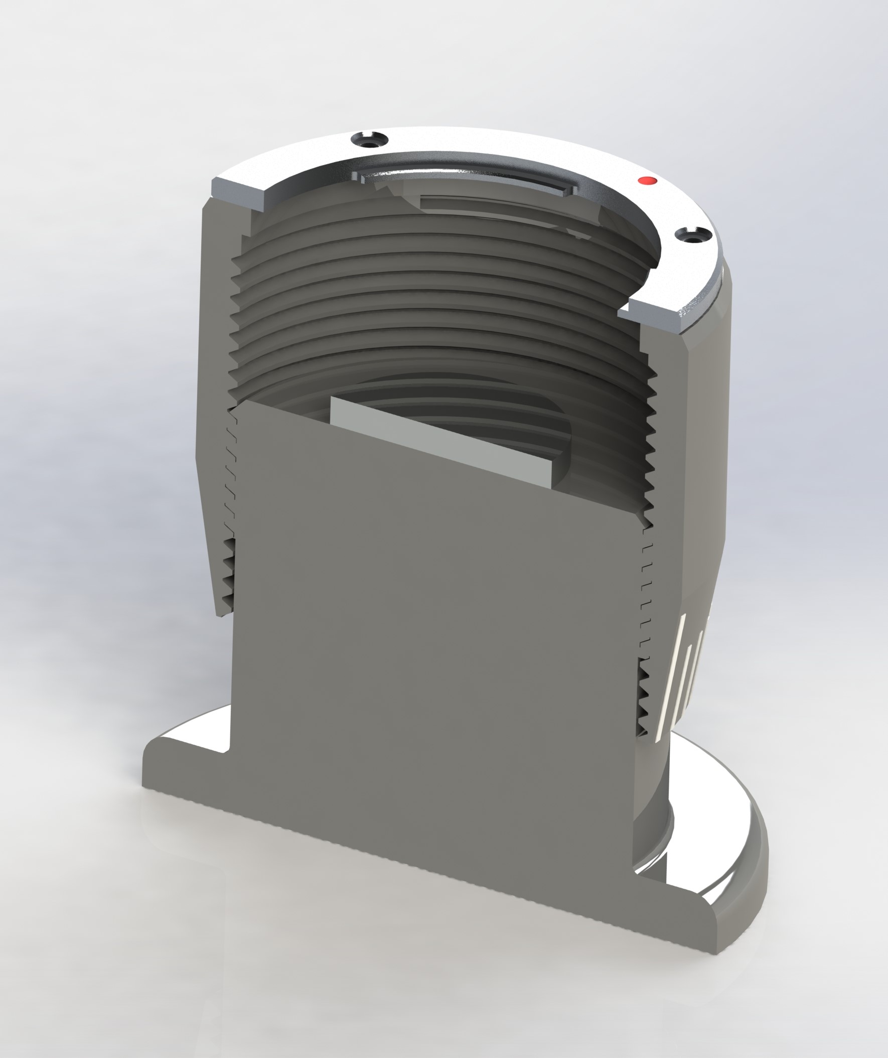

This is my concept for the push-it-around-with-screws mechanism:
Siemens star lives in a ring (yellow) with a threaded retaining ring to hold it down (blue). There are three set screws which can push it around while keeping it up against a face inside the outer part (red). The outer part can be screwed in and out on the green piece to get the target in the right place WRT the objective.
Rest of the design is coming along. There's a lot of parts. It's not going to be cheap to have these all made in only a quantity of 50 or so.

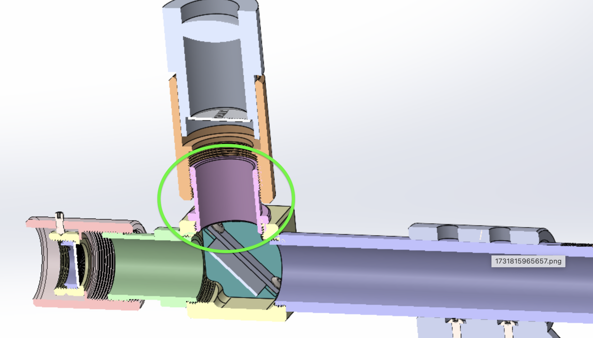

I suspect you are an Engineer, and I'm just someone that can break things, but this might be a source of failure if the device topples or someone leans on it.
Just to mention again, what a fantastic project you are very talented!
Thank you. I'm actually not a an engineer, but I do have a diploma in electronics engineering. The mechanical is all self-taught.
The wall thickness in the area you highlighted is 1.5mm, at a 25mm diameter, I think this should be thick enough to resist any reasonable force.

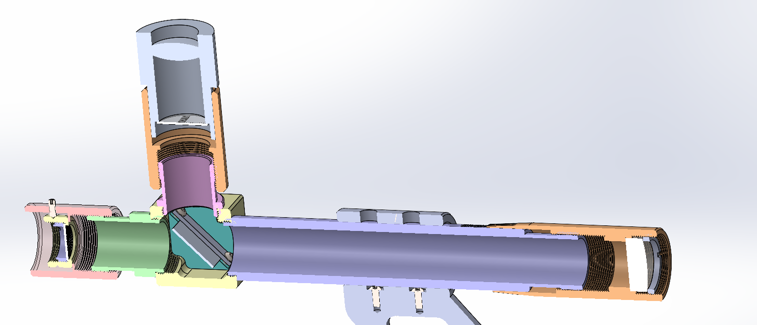

That's the goal. I need to consider some ways to simplify it, though. There are too many parts, and I'm worried about how to get the focus adjustments:
1. Eyepiece mount
2. Siemens star mount
3. Objective mount
To be stiff and hold their set position well as well as survive a lifetime of wear in the case of #3.

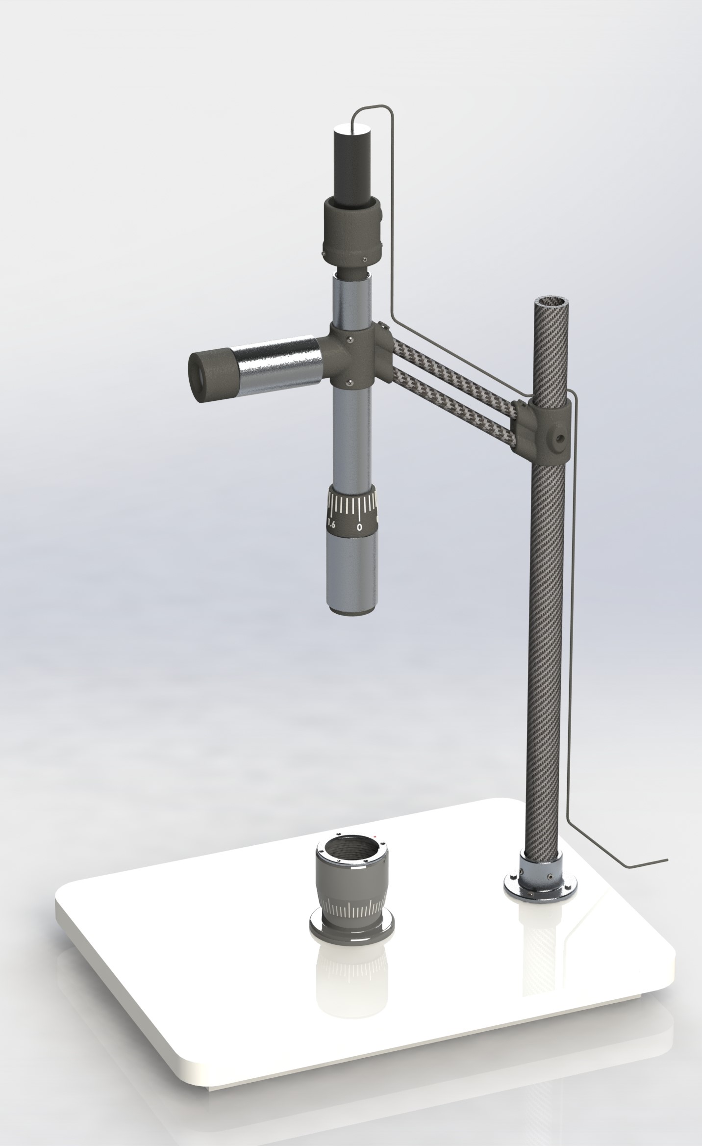

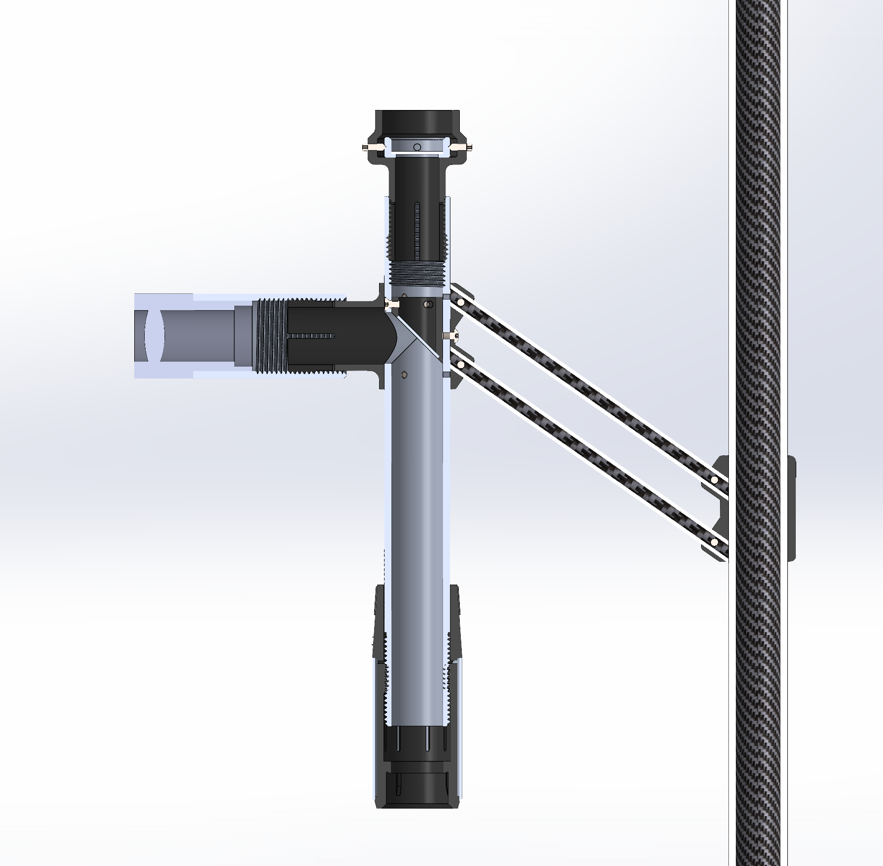

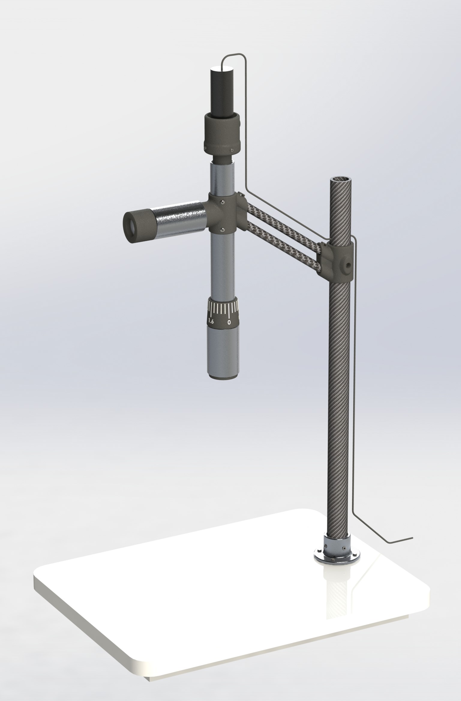

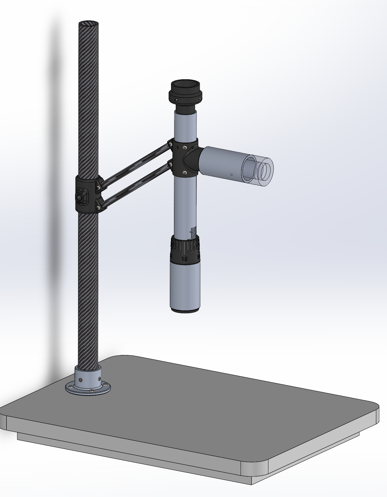

In an effort to reduce the part count, solve the thread concern, and shrink the BOM cost, I redesigned it to make heavy use of MJF 3D prints and put in some carbon fibre tubes. I got the quantity of aluminum parts down to 4 ( one is just a plain tube segment), 5 MJF prints, a bunch of fasteners, and some other stuff. I'm looking at a base 19mm melamine particle board with reinforcement underneath.
The main tube would be black anodized so it's dark inside and allow for laser engraving the focus marks on the barrel.
The threads are an interference fit and the plastic has been segmented so that it will be a snug and wear resistant.
haven't designed the LED and housing yet.
Feeling good about the design so far.

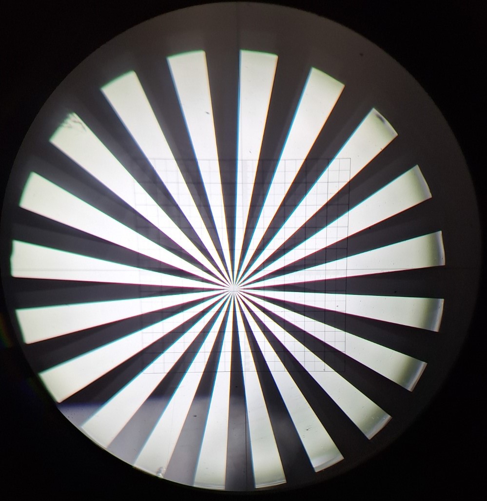

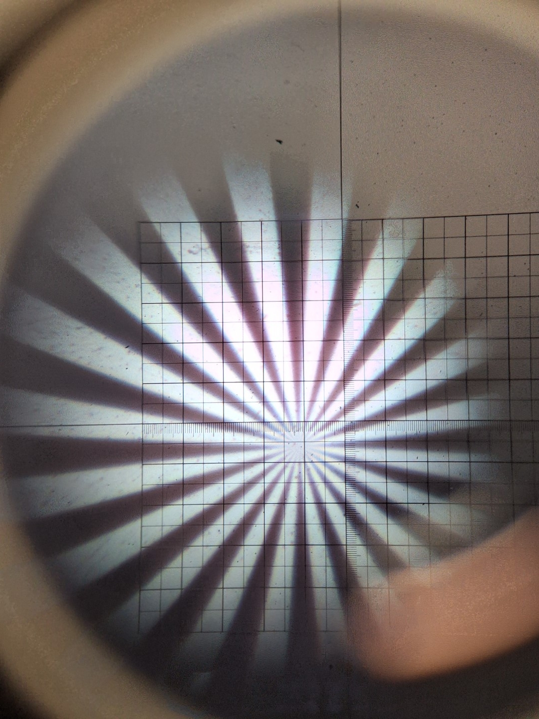

I got new custom made siemens stars today, they are great. This is the centre of the star under 600x magification:
This is the view off a mirror through my proof of concept autocollimator:
Here's the view of the siemens star projected onto some film in a K1000 with 50mm lens wide open. Harder to see and much less crisp than the view just off the mirror with no test lens:
