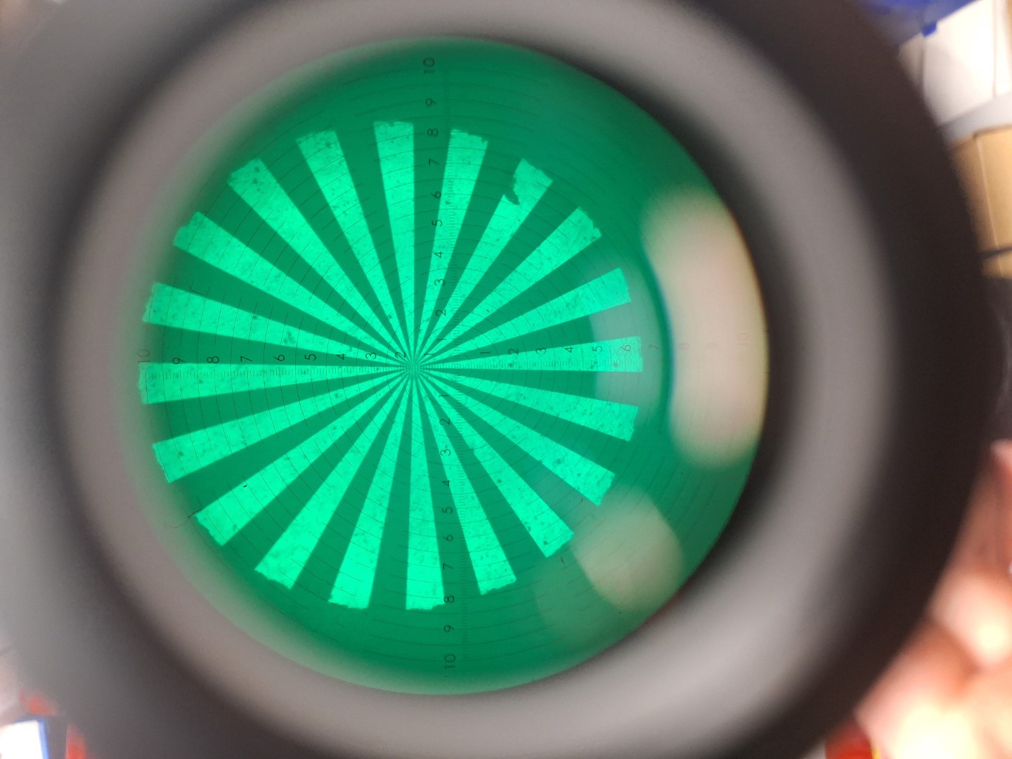

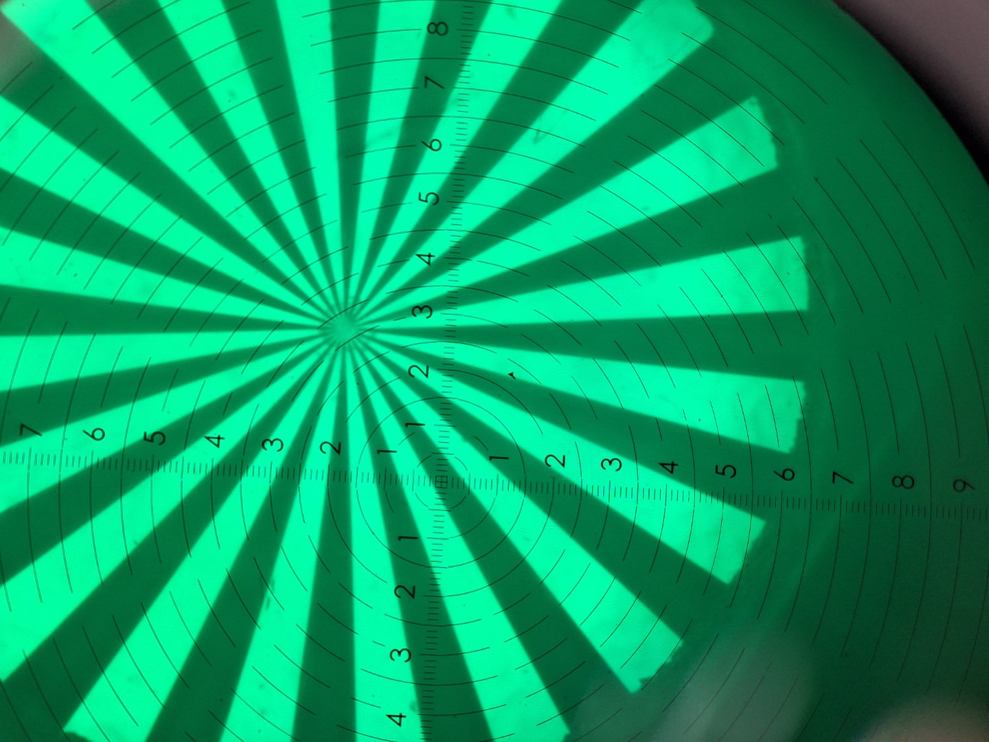

I believe it would have to be on the star itself. But honestly it's mostly for a rough estimate.
Yes, and my star has no marks so I estimate, inner, middle and outer. It is actually pretty nice to instantly check a lens to see how much it deteriorates in the corners. . Most lenses I have tried allow viewing the far corners but wide open only. Though, the wide open performance in the corners is usually what is of interest (to me at least).

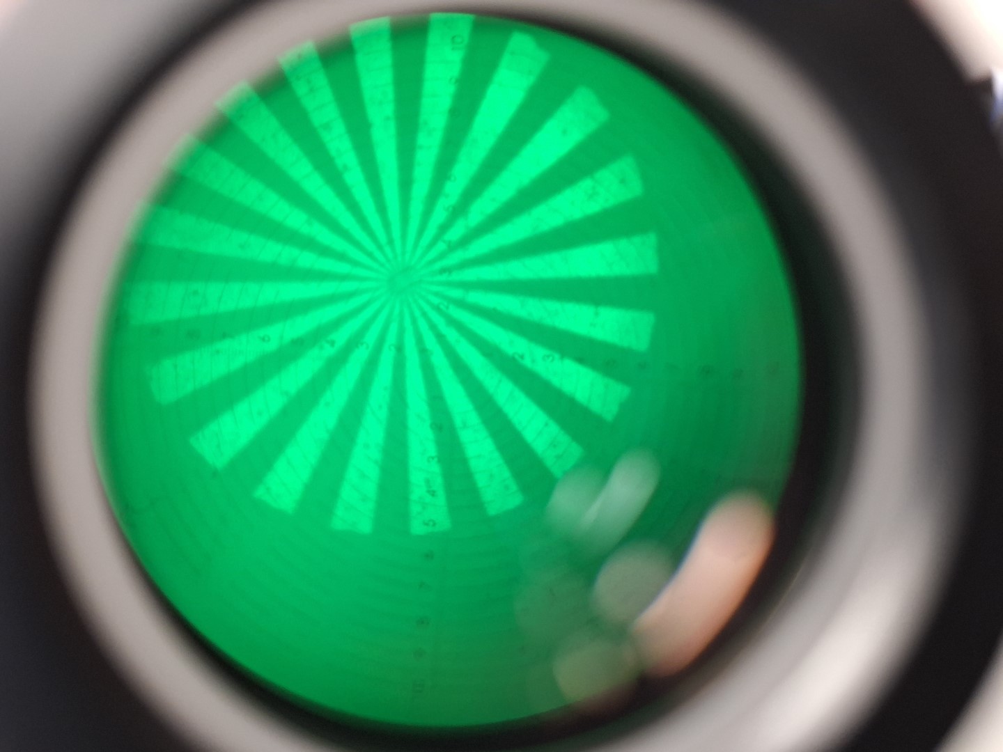

Siemens star off a mirror (I put some sharpie marks on it so I had a sense of how much of it was actually visible through the eyepiece)

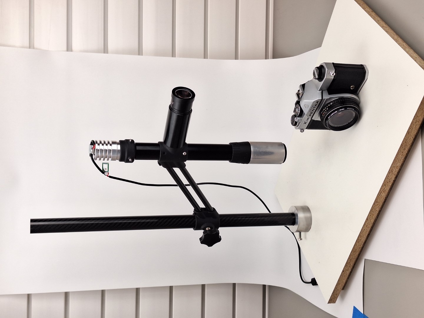

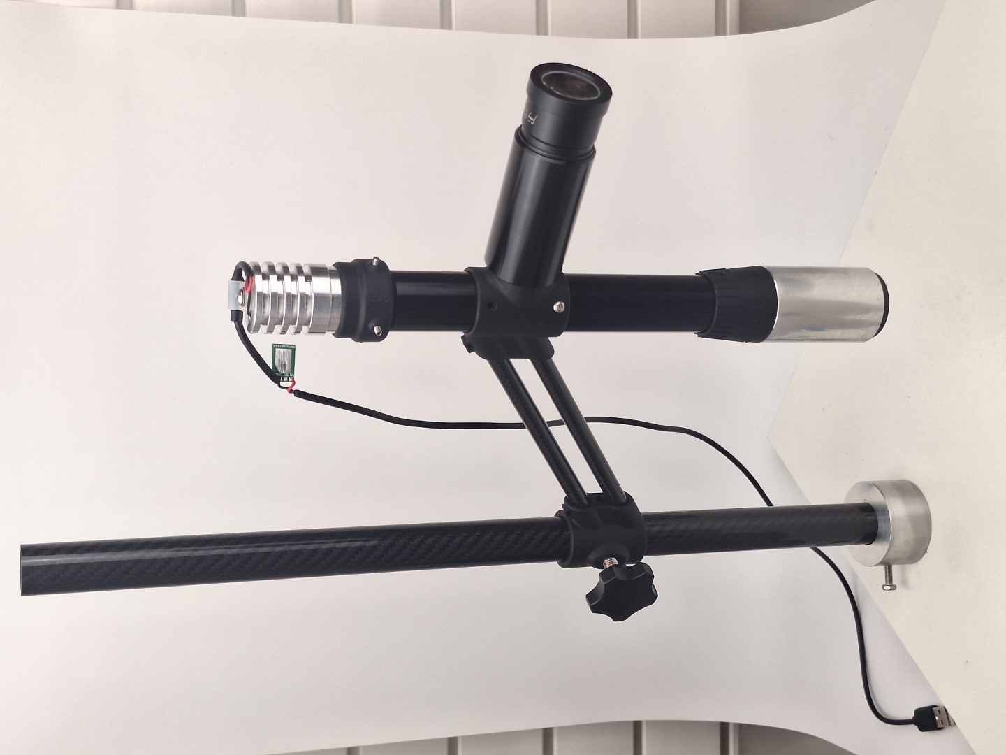

The assembly so far. I made a melamine base, 1/2" thick with some more pieces screwed to the bottom. 25mm carbon fibre column, aluminum flange to join the two. 10mm carbon fibre rods to join the column clamp to the autocollimator itself. I'm very happy with this base build, it works really nicely. I think I'll be offering the AC with and without the base as a copy stand or even a tripod will work in it's place if you're more budget conscious or have something good already in your possession.
Aluminum body is working well, lens barrel seems to work well, but doesn't hold concentricity when being rotated. It returns to "zero" when rotated back into the same angle it was when you started. Working on a green LED lamp still, with and off the shelf USB powered constant current controller.

More soon. I've designed a jig to do wear testing on the lens barrel thread to see how the MJF printed threads hold up to tens of thousands of actuations. I have some new prints on the way with alterations I've made based on how things looked and felt with this first build.
Latest prototype state. Working really well, just a few tweaks and improvements left.

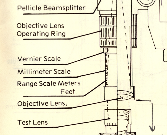

I know you are pretty far along with your design, but have you seen the Camera Craftsman May-June 1978? They have a good technical article about the Pearl 6800 and its advanced features. With your muilti-turn barrel, I actually thought you were copying the Pearl C6800 already. I don't have a good picture but you can see here how they put the feet/meter numbers along side the millimeter scale vertically.
Depending on how you have done your millimeter scale, it is just a matter of doing the calculations and having the feet/meter numbers printed next to the millimeter scale.

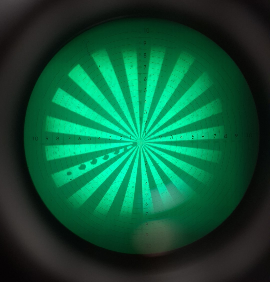

Here's a 20mm f4 lens at f8, off a mirror:
Here's off film at f4:
The green LED is running at 500mA, probably putting out 1.5W.
