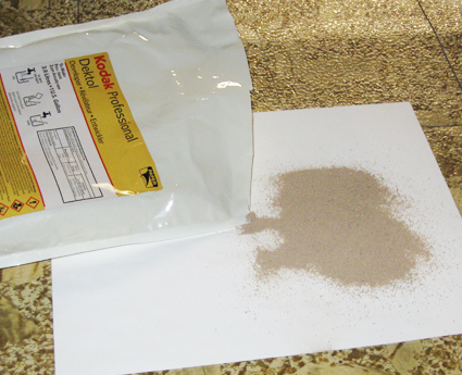

Had a bad batch of Dektol (like many others). Contacted Kodak Alaris this past January. Sent them an email requesting replacemet of the packages I purchased. Just like the responses others have received from Sino Promise regarding the Xtol fiasco, I was told they would be replaced by mid-February. Here we are first week of March. Nothing. Sent them a follow-up email of when could I expect the arrival of the replacements. Nothing. At this point I don't expect to receive a response or the replacements. We need the likes of George Eastman to set them straight. What a way to run a railroad!
The bad batch(es) of Dektol turned dark brown (think demerara sugar color) in the packages, before mixing with water.

What was wrong? Can we see an example?
Here's images of what the unmixed amd mixed looked like.
The "brown Dektol" issue has appeared already in photrio: "This is due to a non-photo active impurity. This has no impact on product performance."
https://www.photrio.com/forum/threads/new-dektol-looks-like-root-beer.174530/#post-2270122

Ok. So Kodak made a mistake and offered to rectify the situation. Over a month ago was when the replacement products were supposed to have been delivered. Complete silence on their part. That’s no way to run a business or to regain my trust. A simple email explaining the delay would be the right thing to do. If they are banking on the brand loyalty that this company once had (50 years in my case) that train left the station a long time ago.
Dektol is not a clear solution, in fact it actually looks brown to me. Do the prints turn brown now or what is the problem?
In the 50 years I have used Dektol, it’s never been brown.
I just used brown Dektol all day today - it performed with no problems.
I've been working my through the batch of black coffee colored Dektol that I mixed up in December. It still works fine.
The product alert I saw about the color didn't mention anything about a replacement being made available, so I didn't ask.
You're correct. It has appeared here and elsewhere. I can even forgive them for a glitch in manufacturing. It happens to most brands at one time or another. As a professional I've had to reshoot for a client because of a mistake I made. However, my dissatisfaction now is with the lack of concern to respond to the customer. It doesn't bode well to ignore a reasonable follow up inquiry as to the status of the replacement. I just think it reflects badly on a company that was once very good in the past regarding customer service. Remember Kodak reps?
Again, what is going on with your prints. Are they brown? Can we see the prints you sent to Kodak, I'm curious as to what this thread is about or what I'm to look out for as long time a Dektol user.
I didn't see where prints were sent to Kodak. There doesn't seem to be a problem with how the bad batches work so it must be an esthetic issue, or a solution looking for a problem. In that case

Hi! I bought two packages of Dektol around 5 months ago, but I still had some of the old "good" chemistry to finish before I run into this problem last week.
As the notice from Kodak-Alaris says that it does not have an impact on the end result, I put up with the disgusting colour and used it.
I must say I saw a slight tan colouring of the paper - very apparent comparing it to the photos developed with the old developer (same batch of Ilford MGV Pearl). Is someone also noticing this colouring?
That is for me a NO GO and a complete failure on the side of Alaris. I have decided to quit using their products at all... but: what are the alternatives?

Me either. I have seen a friend use 30 year old bags of Dektol that the developing agents, hydroquinone and metol had partially oxidized. Solution was same color of brown. It still develops paper. I wouldn't have used it.
Brown MQ developers are going bad. These developing agents were originally derived from coal tar, the reaction can go both ways. From whence it came to coal tar it returns.
